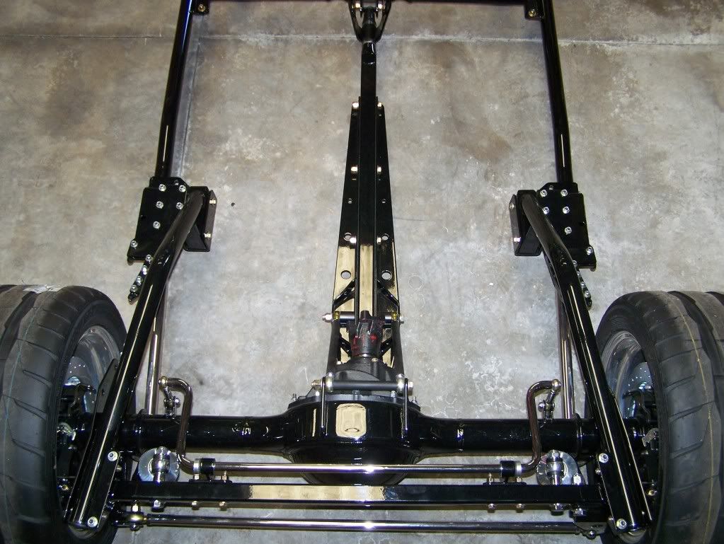

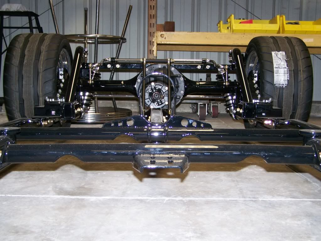

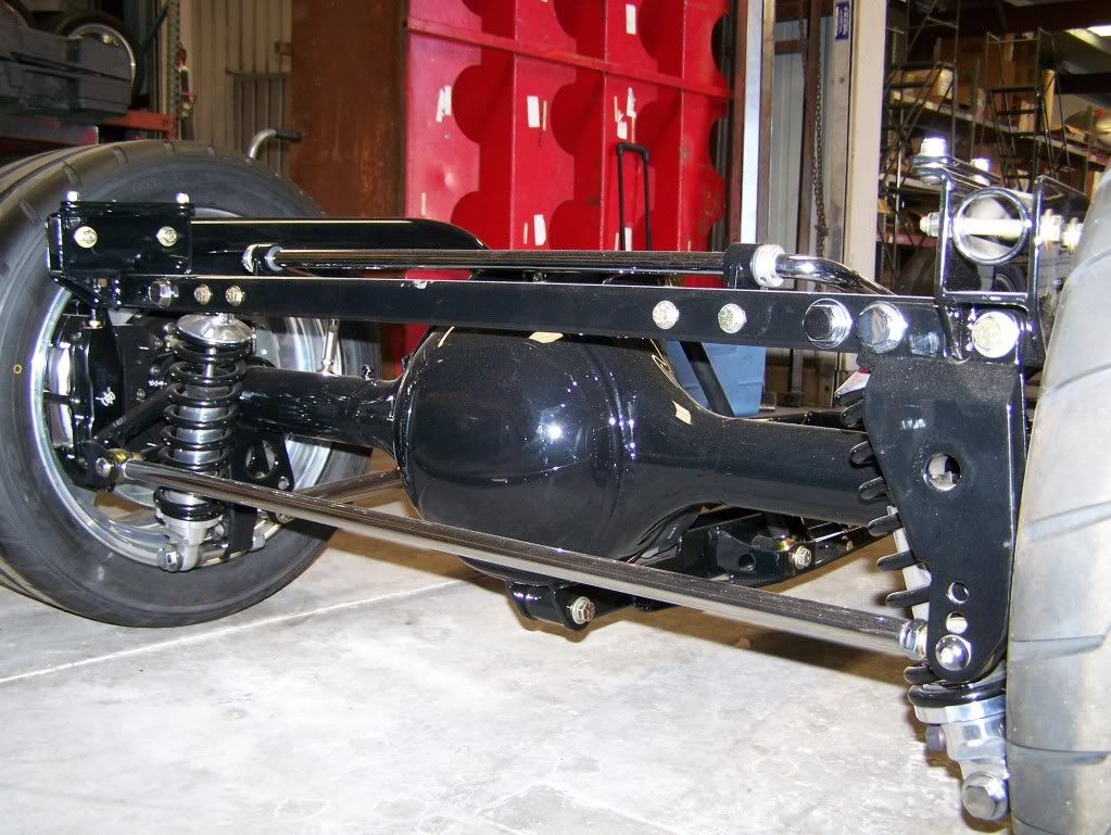

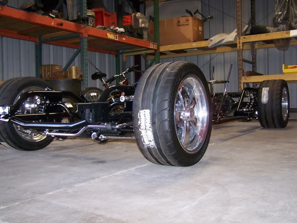

slow4dr 06-15-2010 10:08 AM
Here is the display chassis that goes to all the local shows.
http://i981.photobucket.com/albums/a...s/101_4363.jpg
http://i981.photobucket.com/albums/a...s/101_4364.jpg
http://i981.photobucket.com/albums/a...s/101_4367.jpg
http://i981.photobucket.com/albums/a...s/101_4369.jpg
http://i981.photobucket.com/albums/a...s/101_4368.jpg
