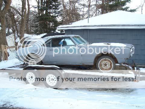

I bought the car around two years ago. I made the mistake of looking at the car in sub zero temps with one flashlight.:( I was told that it was indoors in a shop. What that actually meant was that it was in the back of a pole shed with one 60 watt light bulb.
Frank, helped me come up with a project name "Project SnowBird"

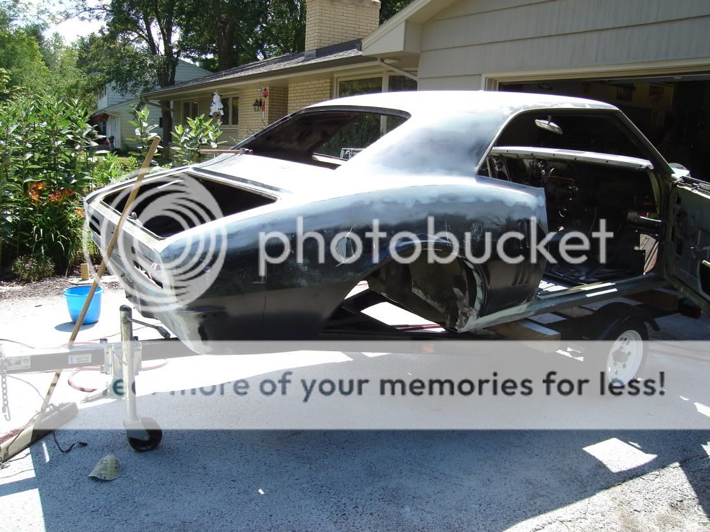

Here it is on the trailer waiting to find a new home.
http://i319.photobucket.com/albums/m.../firebird2.jpg
http://i319.photobucket.com/albums/m.../firebird3.jpg
http://i319.photobucket.com/albums/m.../firebird6.jpg

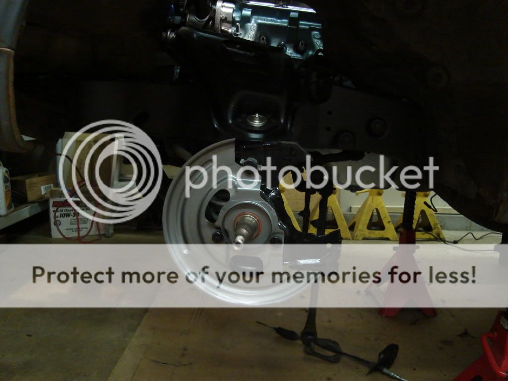

The car had drum brakes up front so I swapped over the front brakes off of 69 GTO.
http://i319.photobucket.com/albums/m...y/DSC06331.jpg

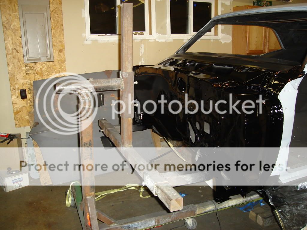

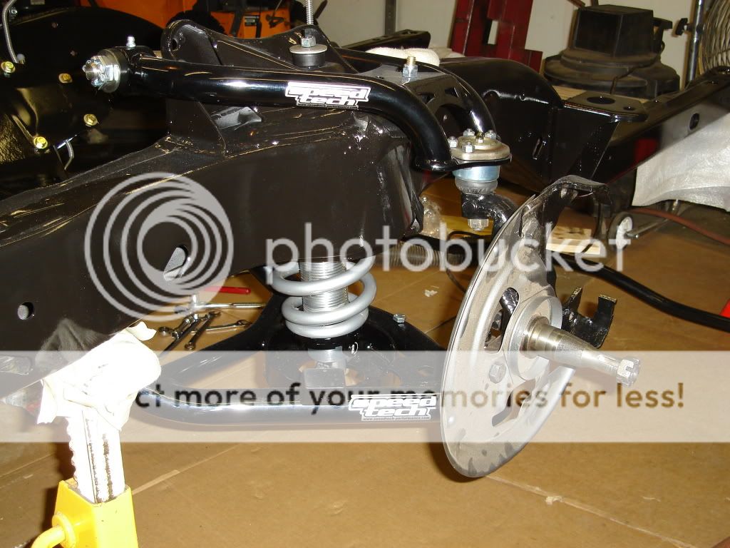

So, this put me into another direction with the car. I wanted to still stay with the original drivetrain but I wanted a very good handling and braking car. So I tore everything apart and started over.
http://i319.photobucket.com/albums/m...y/DSC06758.jpg
http://i319.photobucket.com/albums/m...y/DSC06759.jpg
http://i319.photobucket.com/albums/m...y/DSC06764.jpg

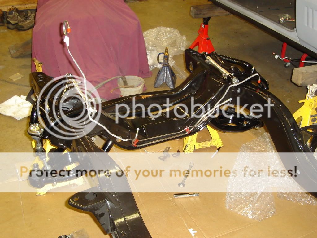

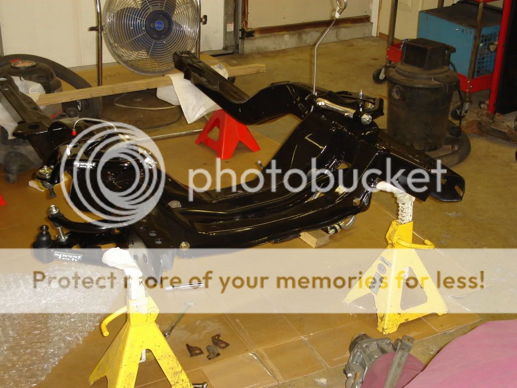

Then the sub frame had to come out.
http://i319.photobucket.com/albums/m...y/DSC06770.jpg

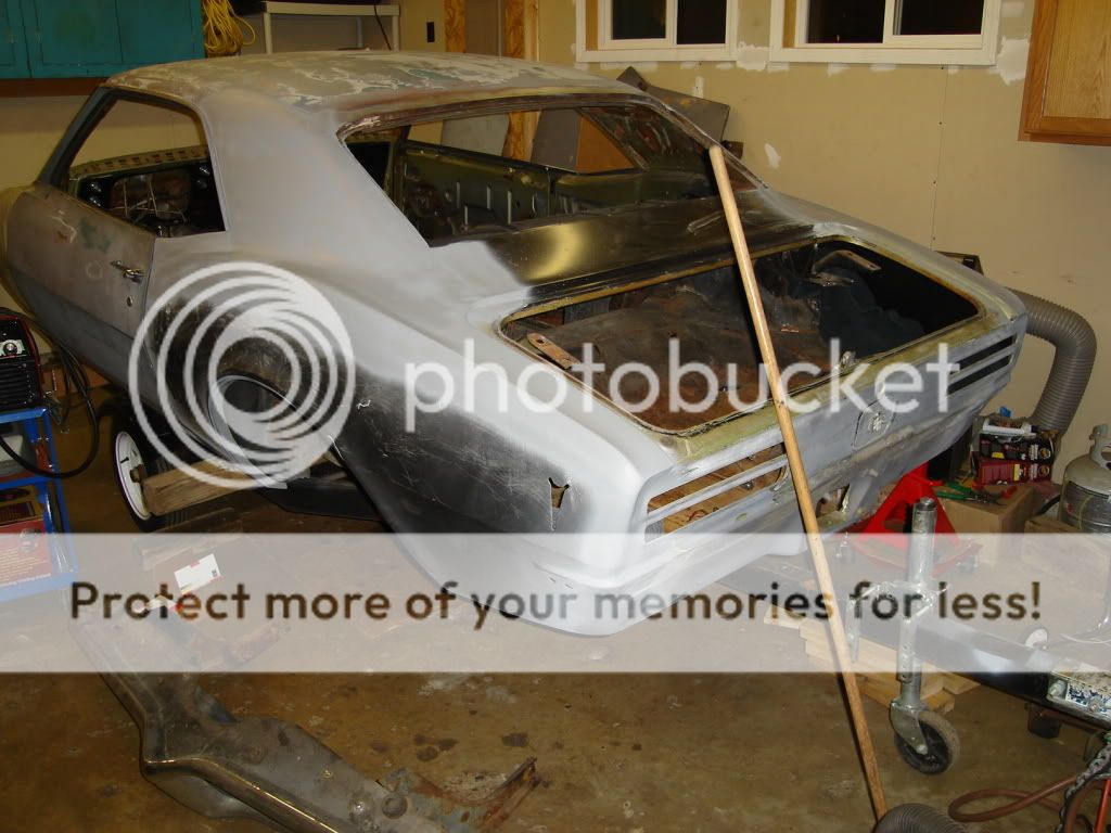

I then put the car up on jack stands for the removal of the whole floor.
http://i319.photobucket.com/albums/m...y/DSC06771.jpg
68400BIRD 01-18-2010 01:06 PM

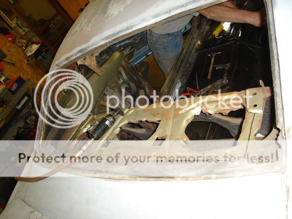

The car is from California but sat in Wisconsin with the windows cracked for a few winters. It was not very kind to the floor. How ever the rockers were very solid.
Heres what I started with.:censored: #$%@#$
http://i319.photobucket.com/albums/m...y/DSC06780.jpg
http://i319.photobucket.com/albums/m...y/DSC06782.jpg
I don't even want to add up the hours it took me to get here.
http://i319.photobucket.com/albums/m...y/DSC06786.jpg

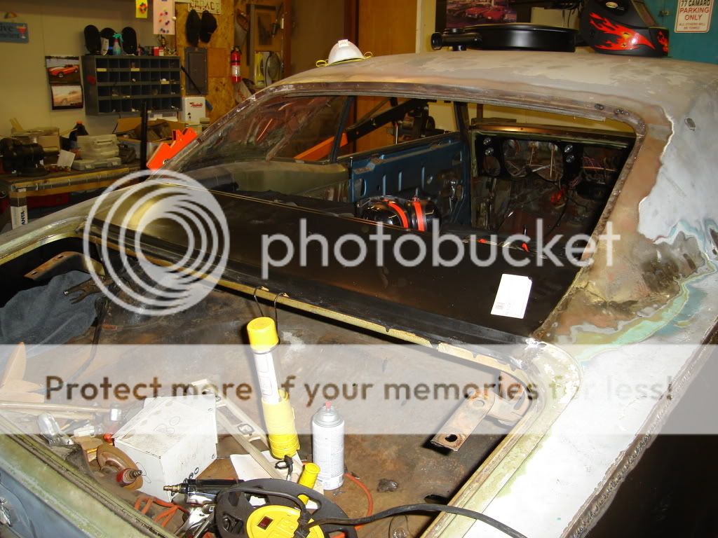

Installed and the welding begins.
http://i319.photobucket.com/albums/m...y/DSC06795.jpg
