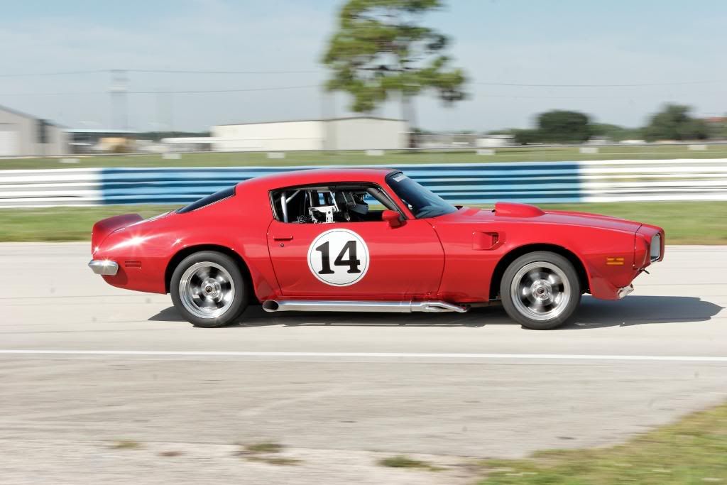

I need help determining what will work well and look cool on my 70 Firebird "The 14 Car". Most important to me is what will work well and be dead reliable on road race tracks. Performance is my main goal because the car has become more of a track car that can still be driven on the street rather than a street car that might go to a track.
For responses in this thread please keep to the companies mentioned for recommendations of brakes, wheels, and tires. They were nice enough to donate the prizes and discussing other companies offerings here is just a waste of time because their products are the ones that will be used.
The car is currently used for NASA HPDEs, Land Speed Racing, Drag Strips, and some street driving. I am planning on trying out some open road racing.

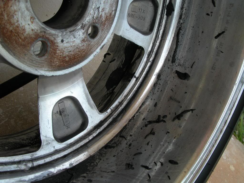

WHEELS: Help me pick a style of Rushforth wheels and finishes that compliments my car. I don't know if anyone knows the weights but the lighter the better! As any of you that go to the track know, cleaning track wheels is a real pain, so the easier to clean the better. Brake dust covers the wheels and chunks of rubber "marbles" get stuck to them. It usually takes a couple hours to remove all the wheels and clean them after a track day. Here's the Rushforth link although I don't think the Night Trains and possibly another one have been posted yet. http://www.rushforthwheels.com/wheels
