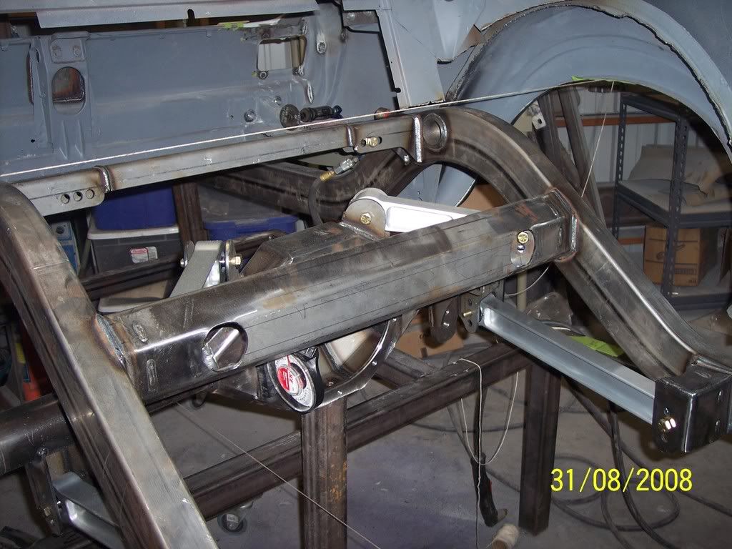

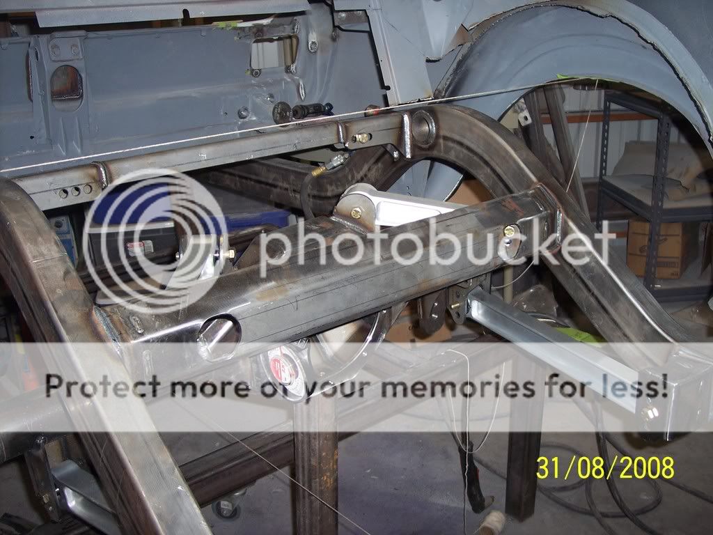

No the chassisworks canted 4bar is a complete rear clip
http://i370.photobucket.com/albums/o...s9-1-08016.jpg
here is the finished car
http://i370.photobucket.com/albums/o.../photo14-1.jpg
I am a dealer for Chassisworks and TCP and can get you a discount on your kit. Send me a PM
