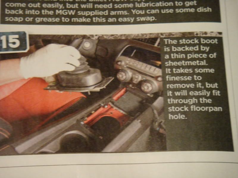

Close but no cigar.. GM#12542549 is the rubber cover over shifter tower.The one wich mounts on transmission. Here i pic of the part i am looking for at 2010 camaro. Offcourse that cant be bought..I comes with the shifter cradle assembly :mad:

oops, I copied the wrong part number. This is it.
10267518 |
