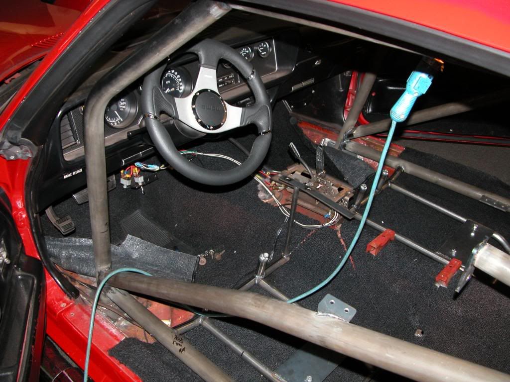

Guys- I'll freely admit that I'm not much of a fabricator. That being said, I need help mounting Kirkey road race seats in a 67 Camaro. For those unfamiliar, these seats are basically flat on the bottom, as in no mounts what so ever. Any help? pics would also be great. Thanks. Jason
NOT A TA 02-09-2010 04:31 PM
If the seats you have are the # 47 (you mentioned flat bottom)These recommendations are on Kirkeys site. http://www.kirkeyracing.com/related/...on%20Guide.pdf If you have the 45's there are instructions for those seats on their site as well.
I have the # 63 seats but they're somewhat similar in that they're intended to be mounted solidly to the cage. You can see the full process of how I positioned the seats and how the seat mounts become part of the cage structure here. http://www.pro-touring.com/forum/showthread.php?t=48151
http://i240.photobucket.com/albums/f...nterior175.jpg
http://i240.photobucket.com/albums/f...nterior162.jpg
