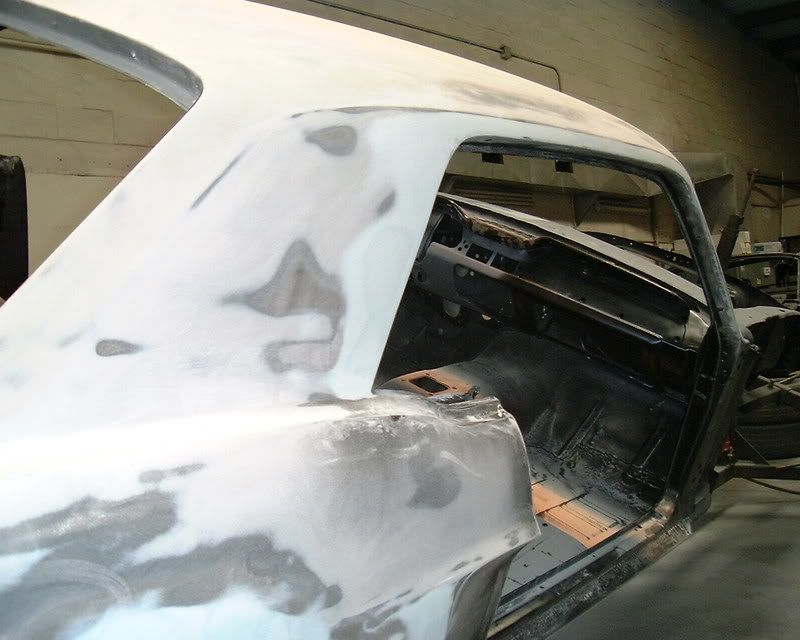

I took this Mustang in trade toward some of the labor on painting a 68 Shelby that belonged to a friend of mine a few years ago. Over the years I have changed my mind a lot on how I was going to build it. This is what I started with it had rust in the floor boards, trunk floor, bottom of quarters and doors.
http://img.photobucket.com/albums/v3...428cj/04-4.jpg

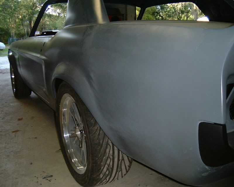

The first thing we did was the rust repair and than I flared the fenders and quarters with steel. I left them attached at the bottom and spread them out 1 1/4" at the top.
http://img.photobucket.com/albums/v3...ty428cj/19.jpg
http://img.photobucket.com/albums/v3...ty428cj/16.jpg
http://img.photobucket.com/albums/v3...428cj/25-2.jpg

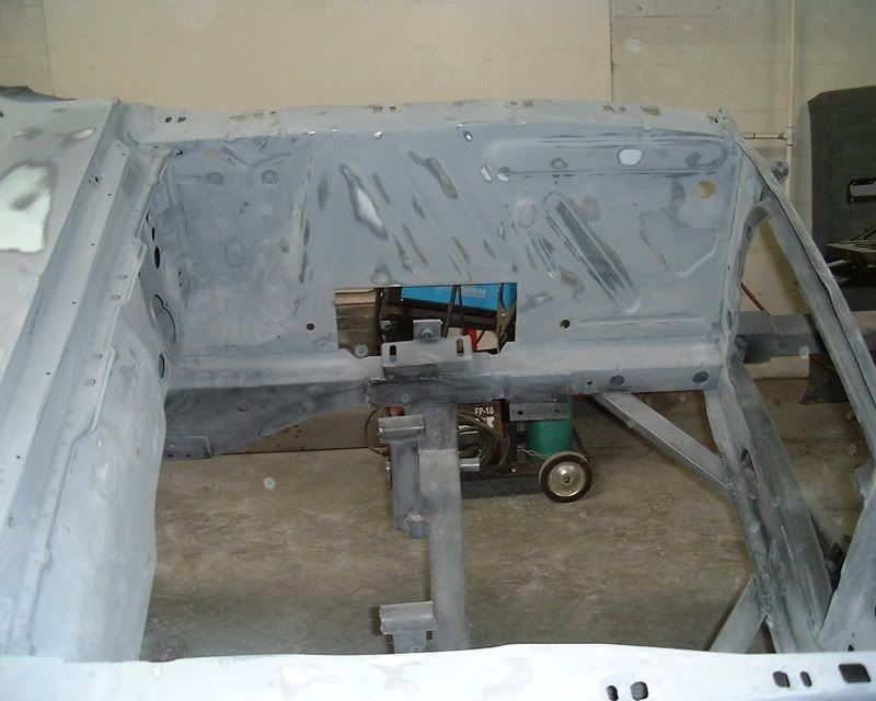

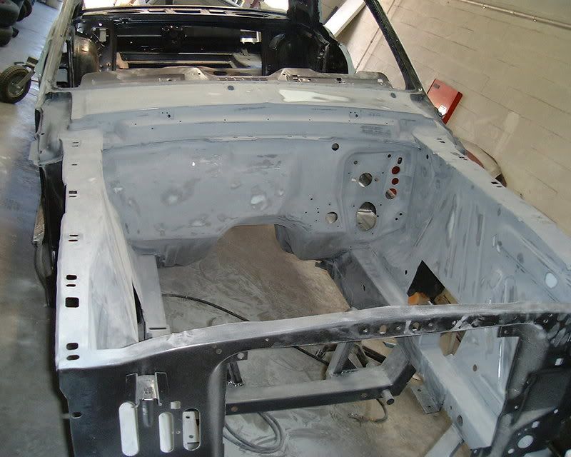

Since I have raced a big block FE since 1969 that is the only engine for my coupe. I have fought shock towers all those years so they had to go. I went with Rod & Custom coilovers with dropped spindles.
http://img.photobucket.com/albums/v3...y428cj/100.jpg

http://img.photobucket.com/albums/v3...ty428cj/88.jpg

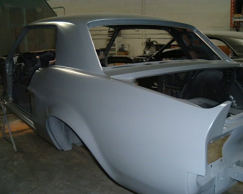

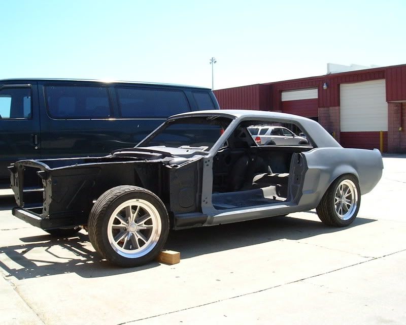

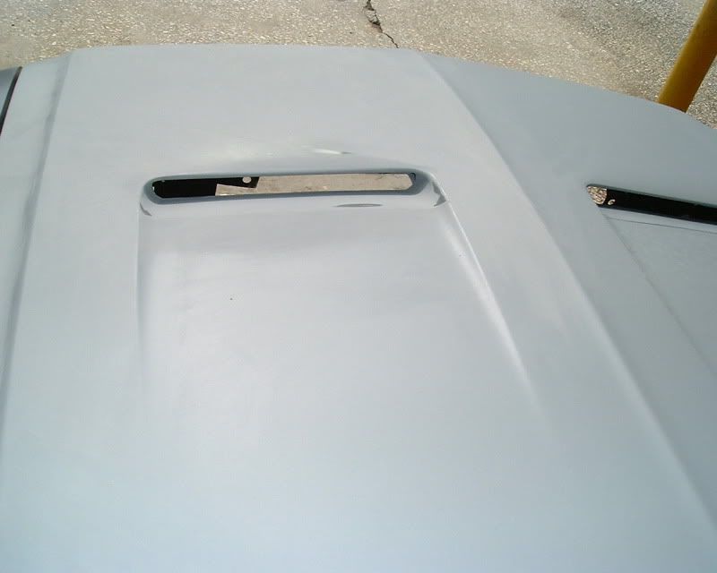

I decided I wanted that smooth look so I did away with the drip rails and the cowl vents.
http://img.photobucket.com/albums/v3...428cj/99-1.jpg
http://img.photobucket.com/albums/v3...ty428cj/97.jpg

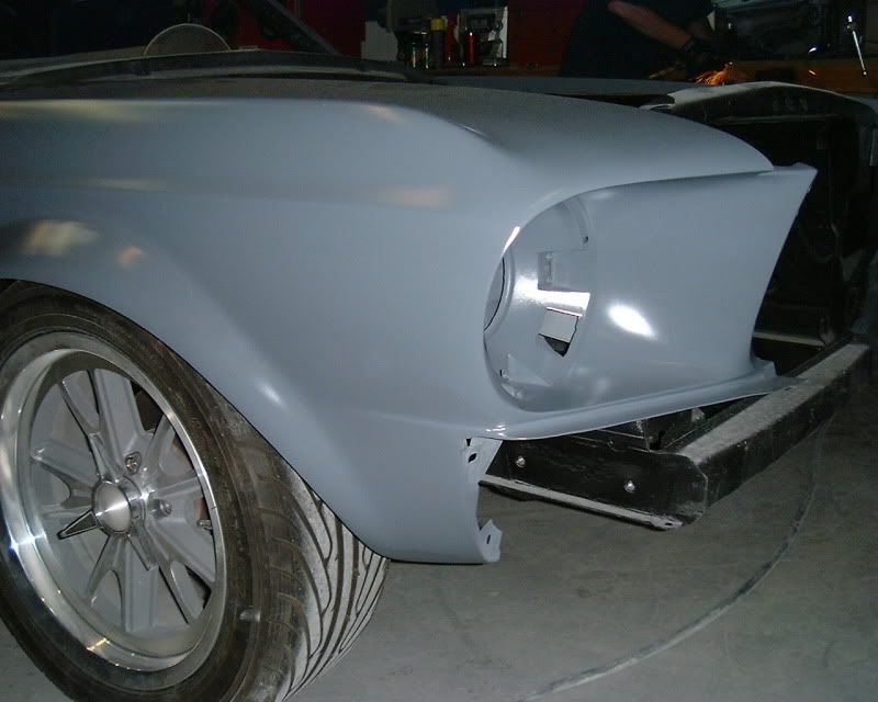

The headlight buckets were bonded to the fenders and the Shelby end caps to the quarters
http://img.photobucket.com/albums/v3...y428cj/192.jpg
http://img.photobucket.com/albums/v3...28cj/118-1.jpg

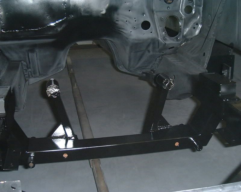

Rod & Custom front suspension
http://img.photobucket.com/albums/v3...y428cj/152.jpg
http://img.photobucket.com/albums/v3...y428cj/154.jpg

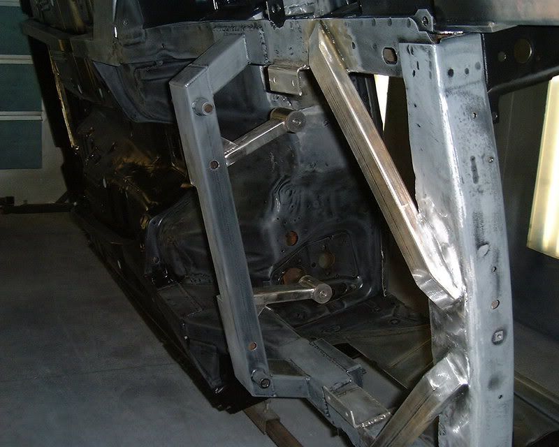

We installed the second kit that Rod & Custom made for the rear. I wanted it welded instead of bolted in.
http://img.photobucket.com/albums/v3...428cj/55-1.jpg
http://img.photobucket.com/albums/v3...428cj/59-1.jpg
