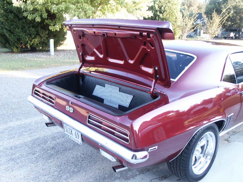

i was thinking something like this... how would one put something like this in?
I'm a visual person, i have a hard time reading instructions :( https://lateral-g.net/members/hall/trunk.jpg |
you see that trunk seal ? pull it up and under there drill a very small hole use stainless screws and use some small strips of wood on the underside . then staple velcro to that peice of wood . you panel will push against that strip with velcro and then stay .
does that help? |
