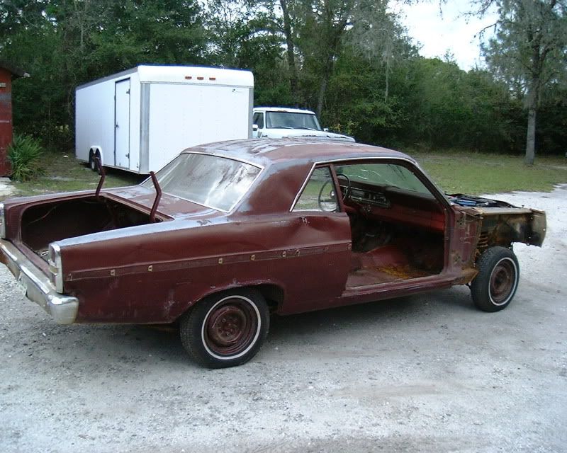

I was going to build this Fairlane as a race car but changed my mind. I don't need two race cars. I wanted something different to drive to cruise nights and car shows to promote the shop. I have a 428 and a set of ported Edelbrock heads I took off the race car and a manual C-6.
This is what we started with
http://img.photobucket.com/albums/v3...428cj/22-3.jpg

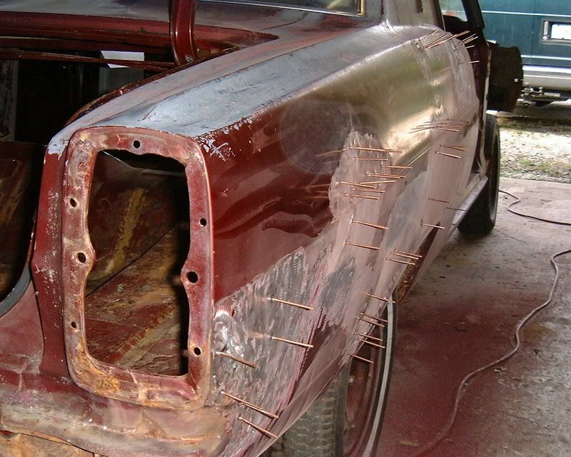

I thought I was going to have to buy a new quarter but I spent an afternoon with the dent puller
http://img.photobucket.com/albums/v3...ty428cj/24.jpg
http://img.photobucket.com/albums/v3...ty428cj/25.jpg

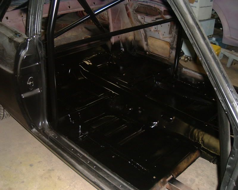

We added a roll bar. Still have to add the side bars.
http://img.photobucket.com/albums/v3...28cj/126-5.jpg
http://img.photobucket.com/albums/v3...28cj/117-2.jpg
http://img.photobucket.com/albums/v3...28cj/114-1.jpg

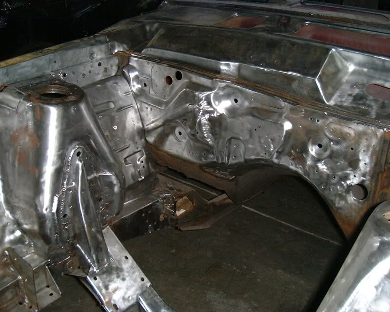

We stripped the engine compartment and welded the shock towers like Shelby did on the early Mustangs and also did the Shelby drop.
http://img.photobucket.com/albums/v3...428cj/77-3.jpg
Not needed holes were filled in the firewall
http://img.photobucket.com/albums/v3...428cj/87-3.jpg
Welds ground and than engine compartment epoxy primed
http://img.photobucket.com/albums/v3...28cj/130-2.jpg
http://img.photobucket.com/albums/v3...28cj/135-2.jpg
