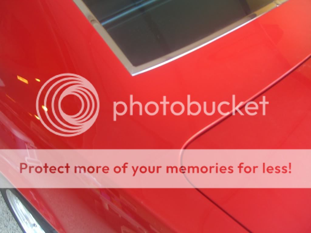

you can find a pic of a convertible for the rear window area seam filled ..converts came that way from the factory..coupes had a seam..not sure why but both my converts were filled..and seen alot like that..i actually like the seam by the rear window..
Steve67RS/SS 02-28-2010 08:53 AM
window seam
here is mine at the window
http://i606.photobucket.com/albums/t...g/CIMG7095.jpg
Rick D 02-28-2010 05:05 PM
Thanks for the picture. That is what I wanted to see. I think it looks cool. I'm still not shure if I want to go this way or not. I think in the end I will make it stock, but will see.
