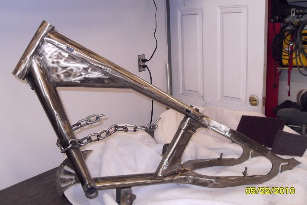

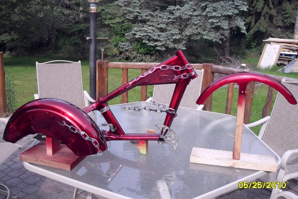

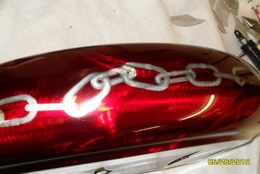

so here is the reason that I needed to know.just finished painting my boys bike.the picts do not do it justicebut the bese was clear powder coat over grinder affect bare steel then the cleared was scuffed then red kandy over the top.
