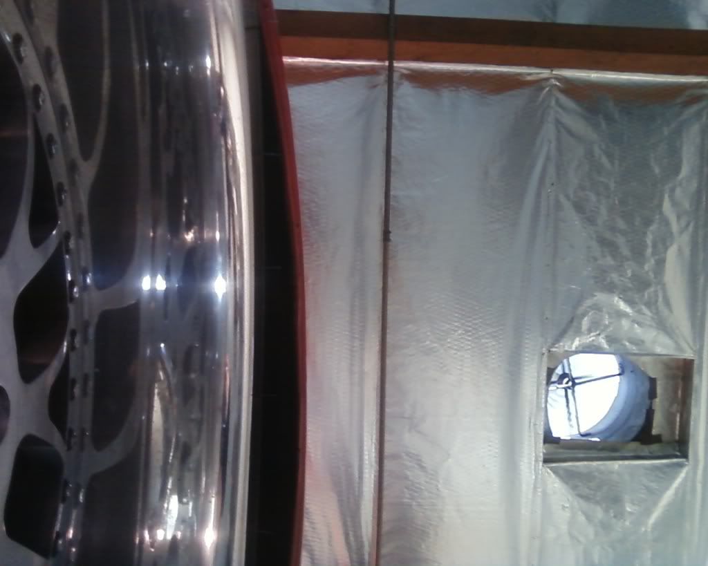

There is about .5" clearance on the outside
http://i41.photobucket.com/albums/e2...phone/0_01.jpg

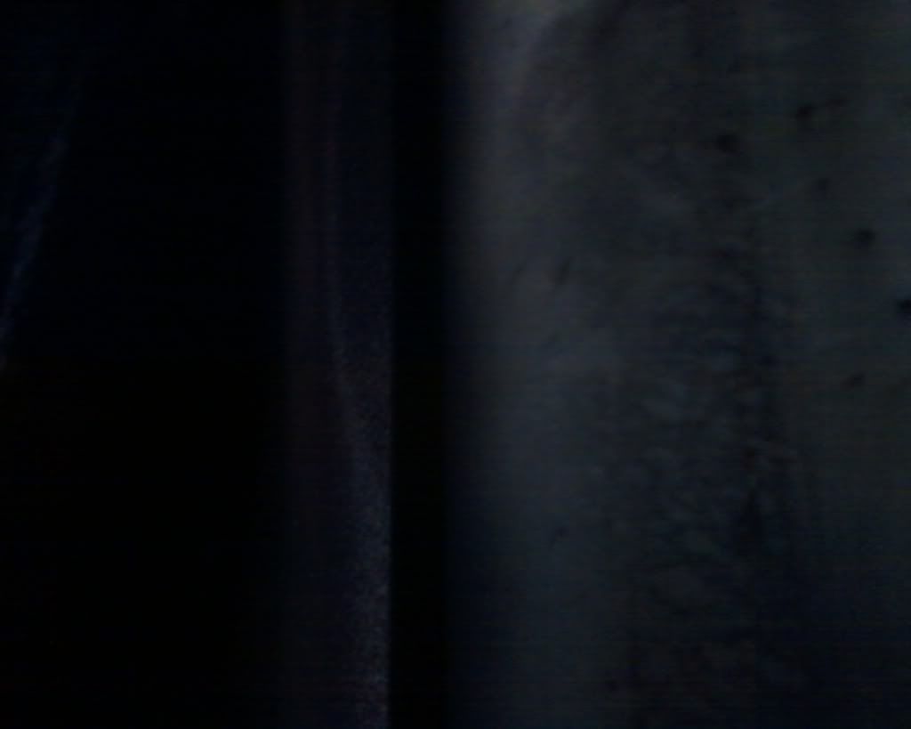

This one came out really dark but this is the inside clearance which is about .75".
http://i41.photobucket.com/albums/e2...phone/0_03.jpg

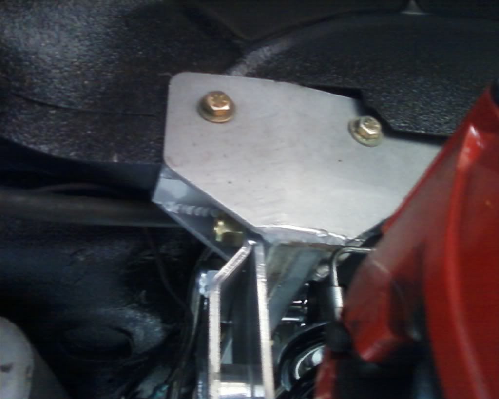

This is the clearance of the bars and brackets.
http://i41.photobucket.com/albums/e2...phone/0_02.jpg

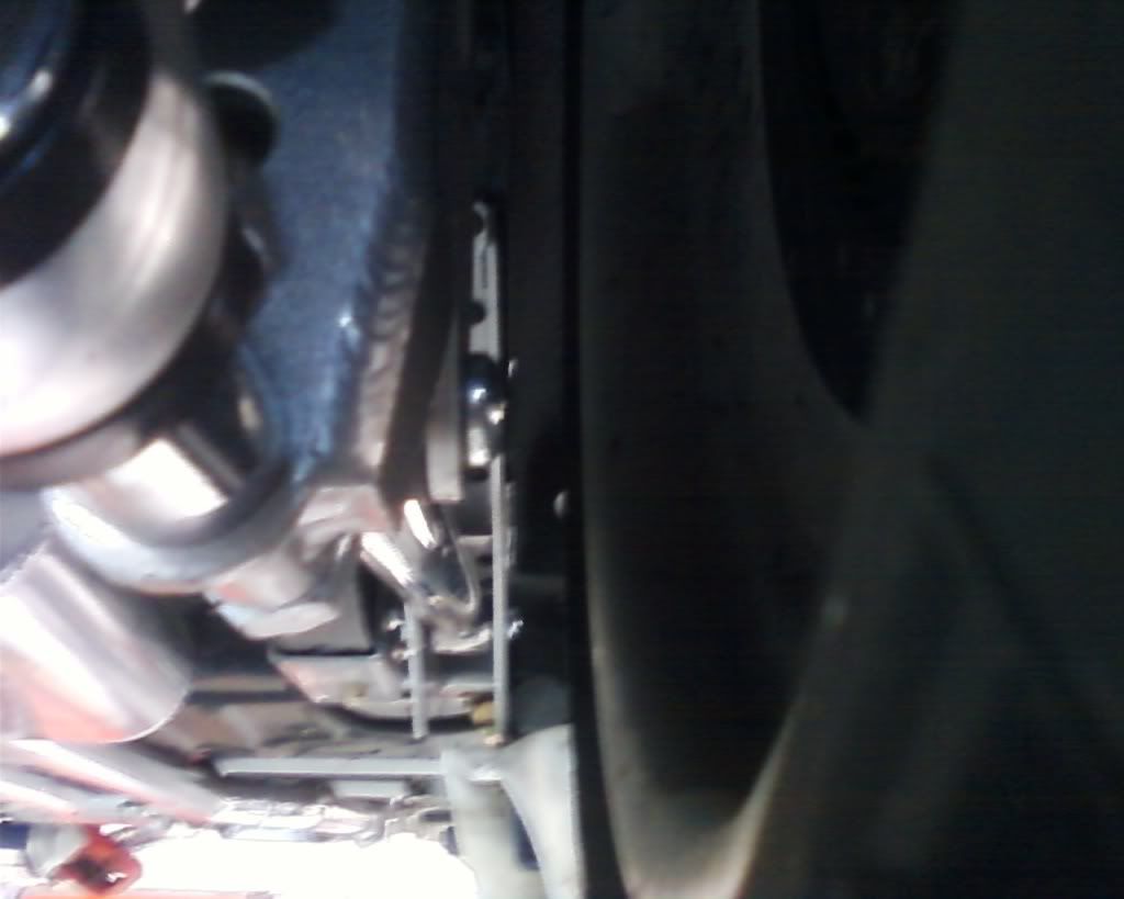

This one shows our coilover crossmember and how much the rail was notched.
http://i41.photobucket.com/albums/e2...phone/0_04.jpg

I thought I had a tight fit. That dude is just a lil tighter than mine. I have a half inch on the outside. I will contact like you did on the ribbing of the sheetmetal if I rotate the axle over 5*. But if it becomes a problem I will shave and smooth the inner quarter to remove the "bump out" to get more clearance. The lip of the quarter on mine clears just fine.
But on yours you have some possible interference on the inside with the head of the bolt (maybe not at ride hight, you have it dropped for the pic?) or the rubber higher up. The rubber hose can prolly be fixed. Mine is smooth on the inside, nothing to hit, and if it does, its flat sheetmetal, not gonna rip a side wall.
