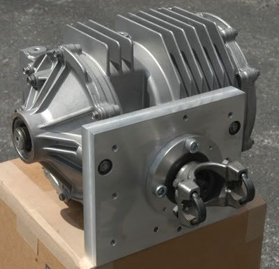

this is the kit i'm in search of so i dont have to use the trans axel:

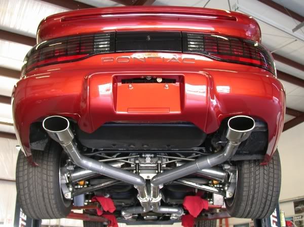

http://i15.photobucket.com/albums/a3...5DiffPlate.jpg and i would agree this would be an easier setup to fit in, as its been proven to: http://i15.photobucket.com/albums/a3...2-dscn9405.jpg but building a track/drift car, and the 210 WHP rating, i'm being steered away from it. If someone can show me a heavy car thats been beet on with alot of G's, and this rear has help up, i would start to lean towards it, as these rears are about half the price to buy, but its still old technology. |
and alot of g´s ?? it was my understanding that drifting involved loss of traction.. what are the g forces you refer to as "alot" .. and old technology?? so is the internal combustion engine.. you can change the anchor points of the lower controll arms to change the cambergain.. you can move the trailing arms for varying degrees of antisquat... and with a 210 rwhp limit you would be fine with a dana 36 rear but if this thread is about what you feel then you are the only one who can answer... |
I dont mean to come off cockey or argumentive. I'm just throwing what i've found out about the rear end out there, i guess i should have mentioned i plan on hitting atleast 500 Whp, so the Dana 36 won't hold up to that, *If i'm correct*
with the G's (and i'm not talking about my friends in the ghetto, but a unit of inertial force on a body that is subjected to rapid acceleration or gravity) that the rear may experiance, i want to auto cross this car, and have the option of going on a drift course with the opertune chance. I do realise that is acomplishable with both rear IRS's. As i would *imagine* drifting a car would be harder on the rear end with the camber set off, and high RPMS, and there for being harder on the u joints, hubs, and half shafts, where as the dual controll arms would only be hard on the hub. But then again, i dont surly know the answer to that. This thread isnt about what i think, but what i dont know. You clearly know more about the C4 style rear end then i do, and i'm am taking your knowledge as an influence. Again i'm sorry if i came off in any different of a way to you or anyone else. I still need to find out about the adaptor for a C5 rear end how ever. Bob |
