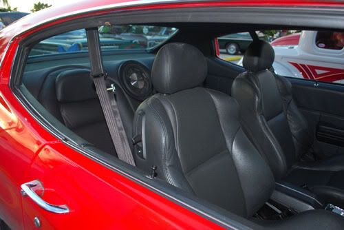

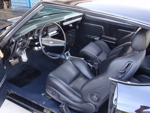

Yea, thanks I forgot about the GTO seats people talk about. I just looked them up online and found this over on PT.com, this was in a Camaro but the pic was nice to see.
http://i32.tinypic.com/qohel3.jpg
Showed the wify and she likes it. Checking local to see what I can find.:thumbsup:
I love the black 70' Fesler car but the seats are the only thing my wife and I did not like. Alittle tall and skinny looking we felt. It's hard to say with out doing a test fit and sit in them to say for sure. We have a Honda Accord and I even thought about pulling those out and doing a test fit, they might even look good recovered to match.

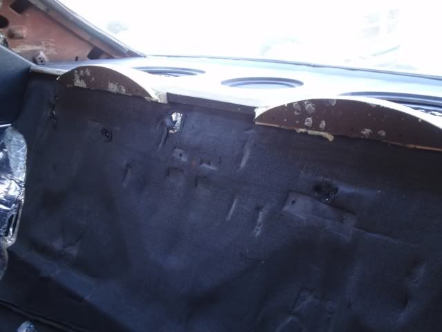

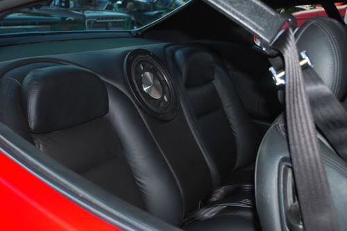

6spdcamaro 03-15-2010 02:01 PM
Width of tracks in front 18"
width of tracks in back 20"
Widest point of base cushion 23"
Height of the cushion in front 10"
Height of the cushion in back 8"
Overall height when headrest is all the way DOWN, appx. 39" depending on recline setting
Overall depth of tracks 20"

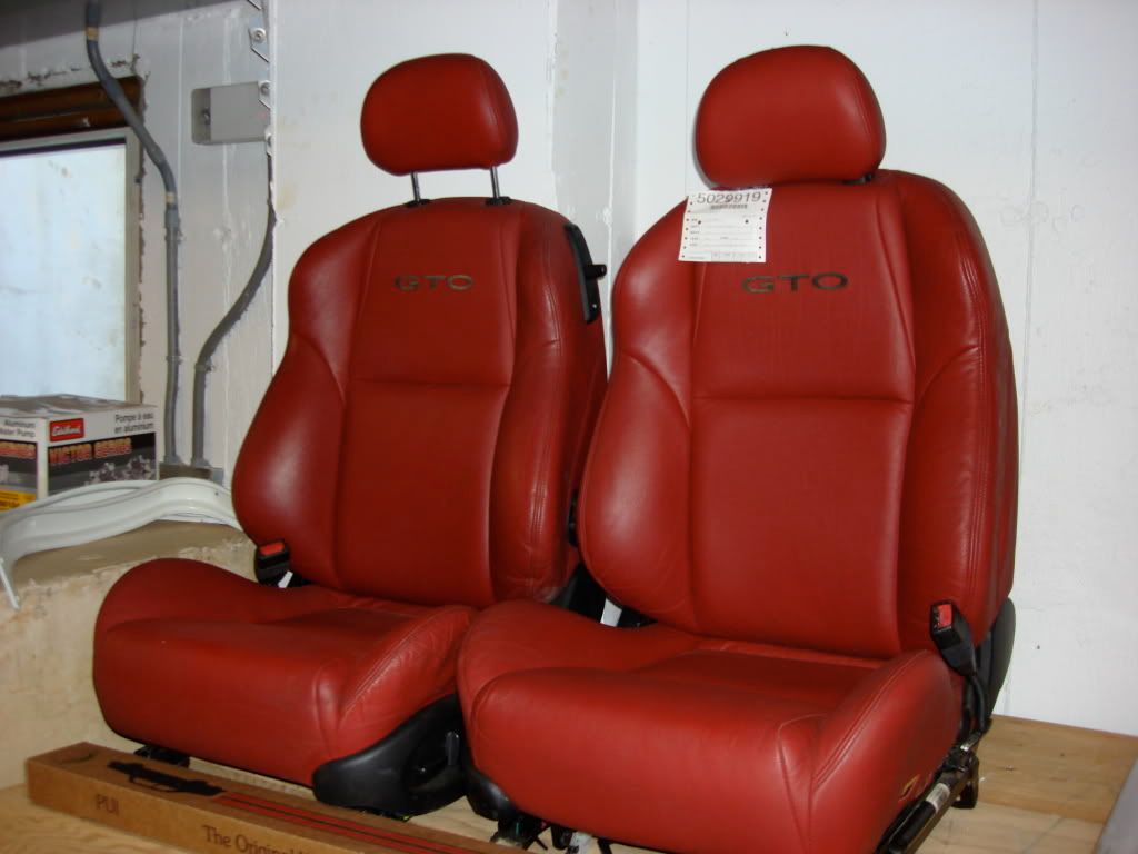

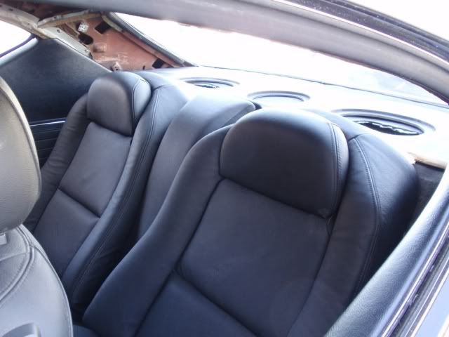

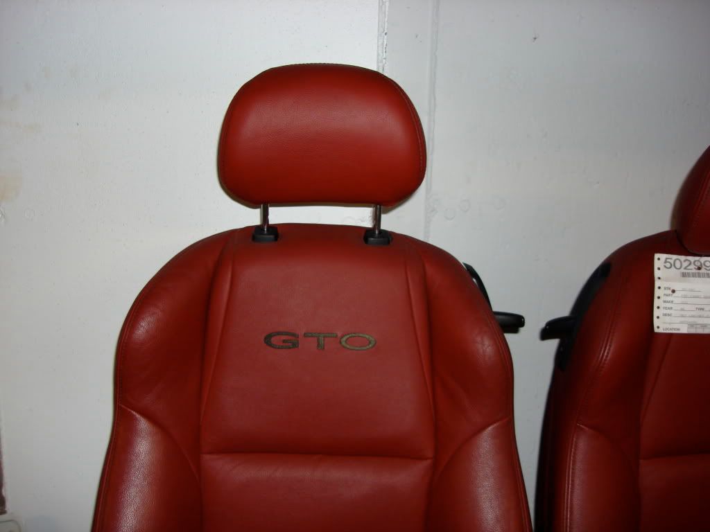

These are no doubt the most comfortable seats i've ever sat in. I got mine from Cleveland Pick-A-part for 800. Fronts and Backs, 250 a piece for fronts
http://i819.photobucket.com/albums/z...o/DSC02050.jpg
http://i819.photobucket.com/albums/z...o/DSC02049.jpg
http://i819.photobucket.com/albums/z...o/DSC02048.jpg
And thanks for giving me something to do instead of homework :) :lateral:

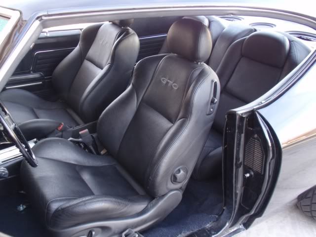

wayne70 03-15-2010 03:21 PM
GTO seat's fit real nice in chevelle's. I used the stock counsel from the chevelle. The rear seat was more work, i cut the rear seat down 6" so it did not block my view in the rear mirror.
