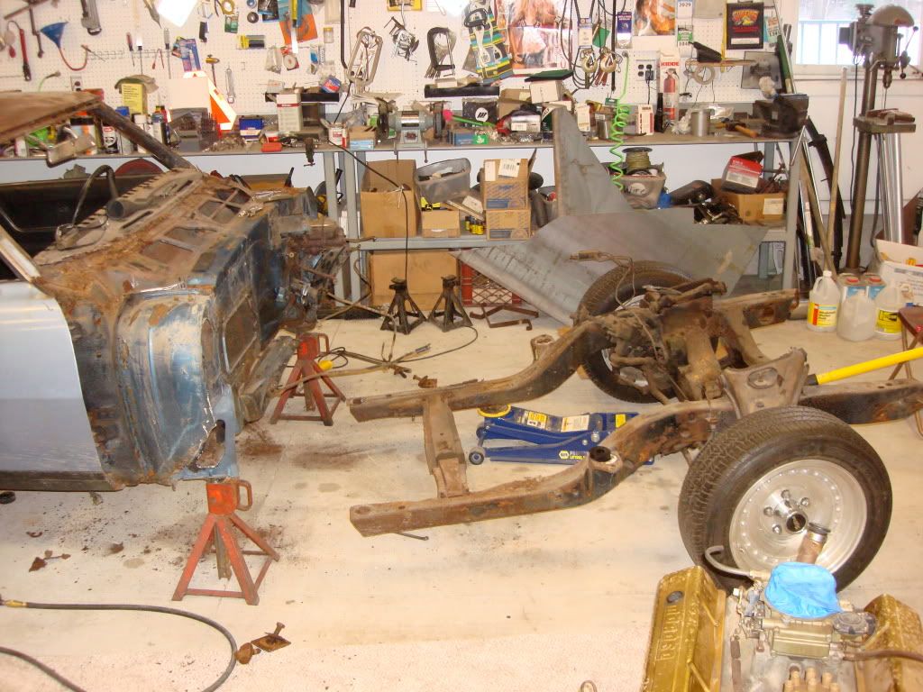

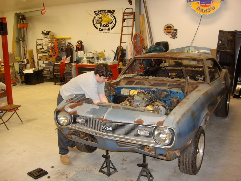

Car in its original form :rolleyes:
http://i819.photobucket.com/albums/z...o/DSC01095.jpg
Subframe out
http://i819.photobucket.com/albums/z...o/DSC01115.jpg

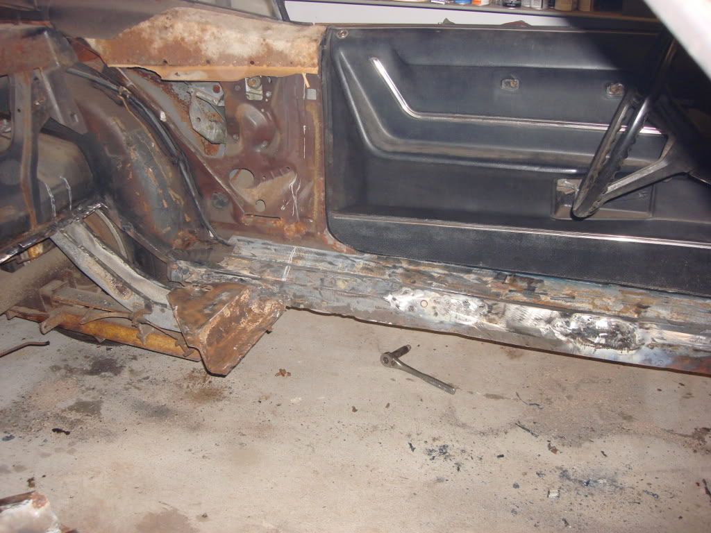

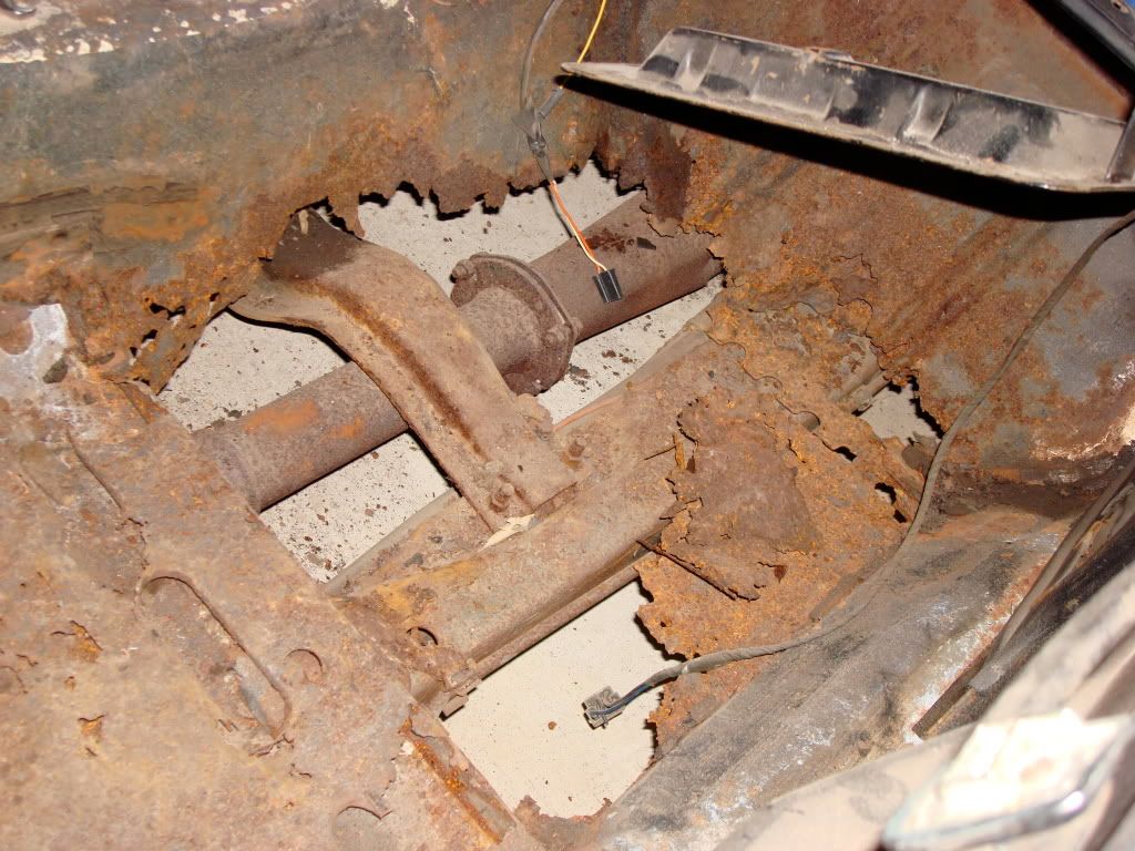

There was minor rust in the floor so we had to patch it....
http://i819.photobucket.com/albums/z...o/DSC00394.jpg
http://i819.photobucket.com/albums/z...o/DSC01144.jpg

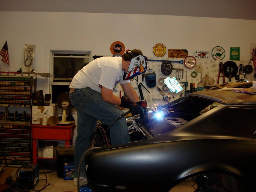

plasma cutting the hole for the Q-link brackets
http://i819.photobucket.com/albums/z...o/DSC01195.jpg

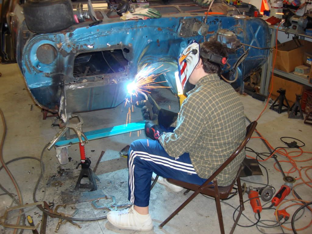

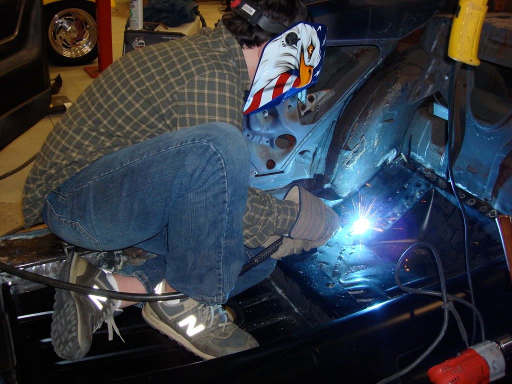

I know, the pants.... i learned the hard way not to wear those when welding.
http://i819.photobucket.com/albums/z...o/DSC01216.jpg

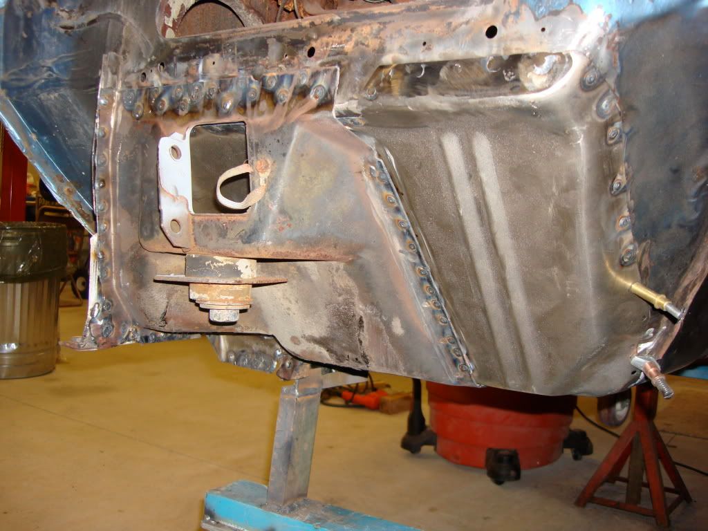

New front floors and body mounts
http://i819.photobucket.com/albums/z...o/DSC01217.jpg

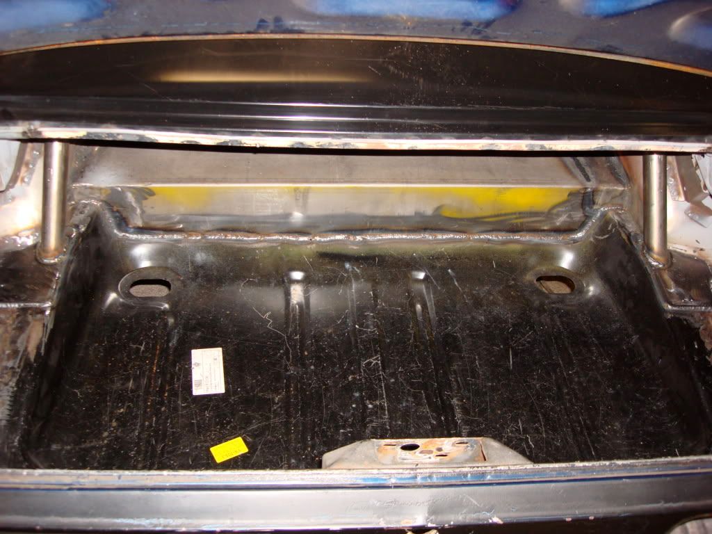

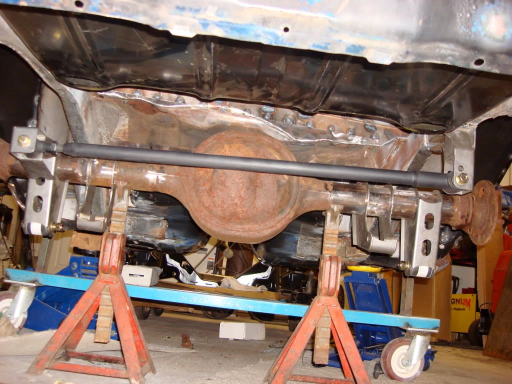

Tubs, Q-link, and trunk floors in
http://i819.photobucket.com/albums/z...o/DSC02023.jpg

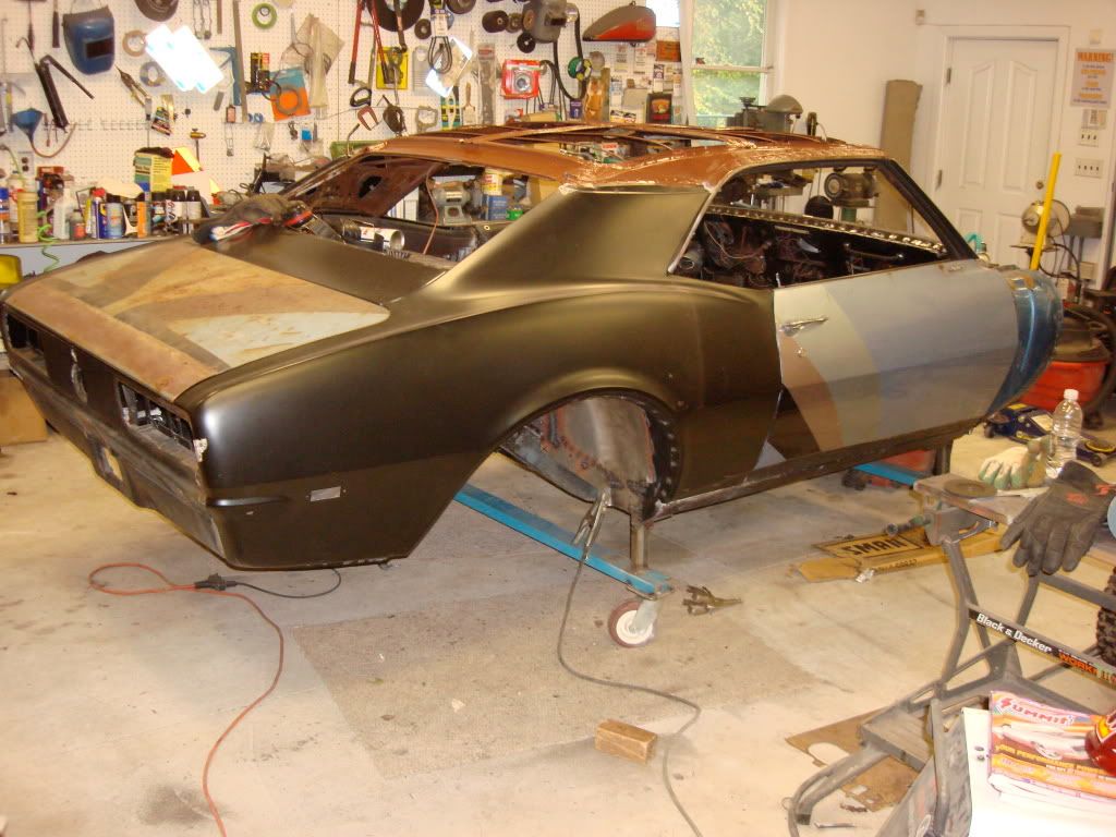

Quarter panels are on, along with the wheel wells
http://i819.photobucket.com/albums/z...o/DSC01966.jpg

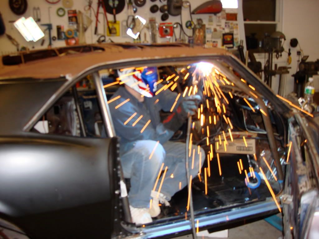

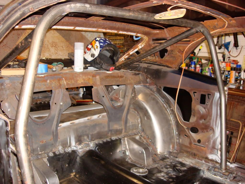

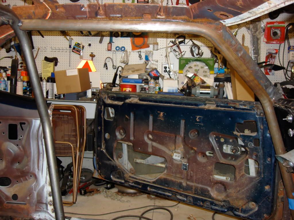

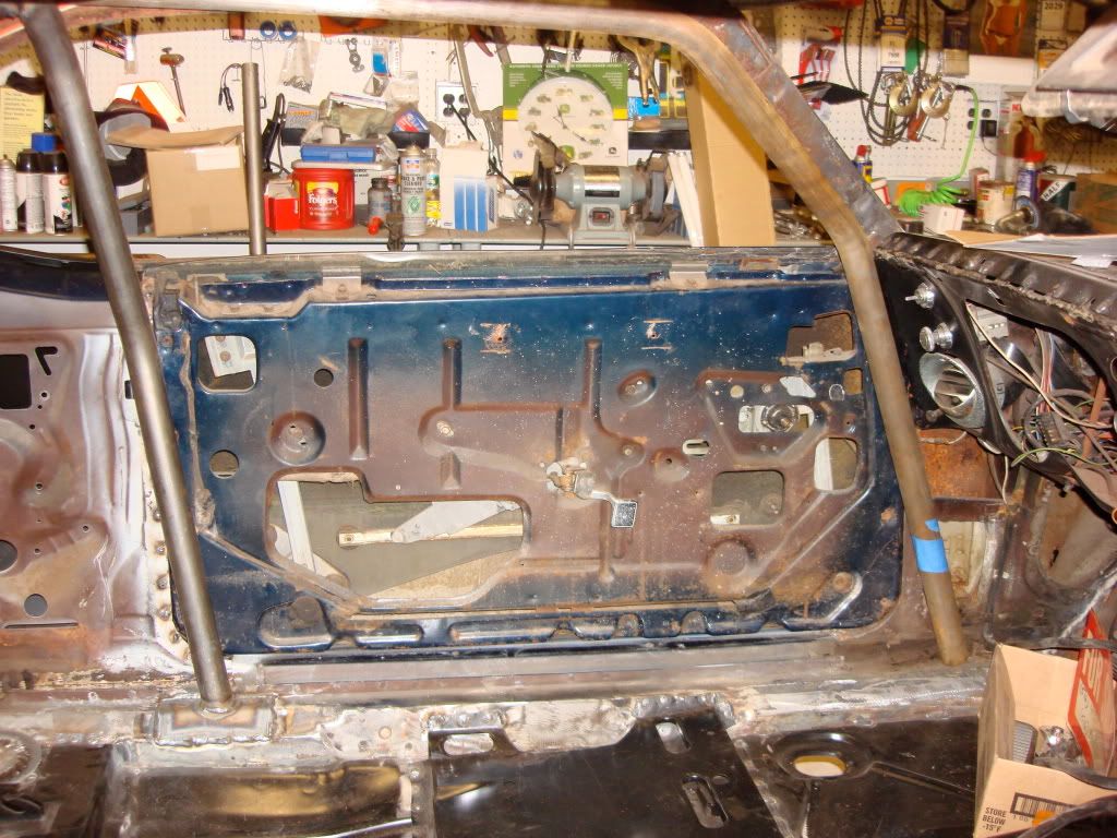

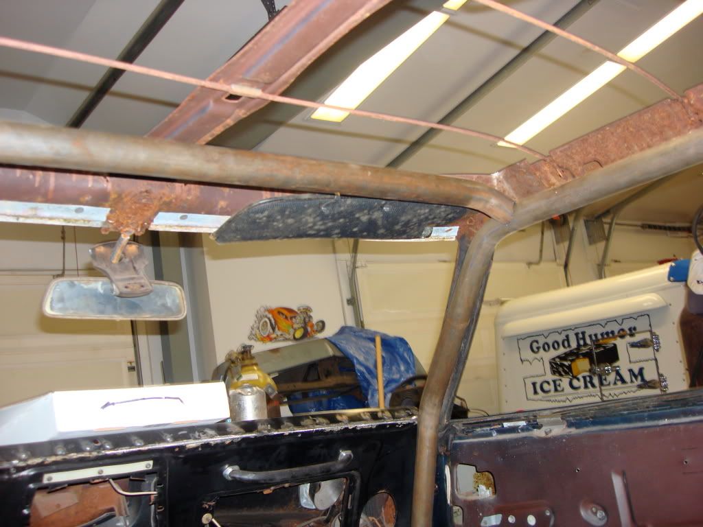

First part of the cage is in. DSE really did a good job of making it fit well. The main hoop fits like a glove with the most possible room you could get out of it.
http://i819.photobucket.com/albums/z...o/DSC02020.jpg

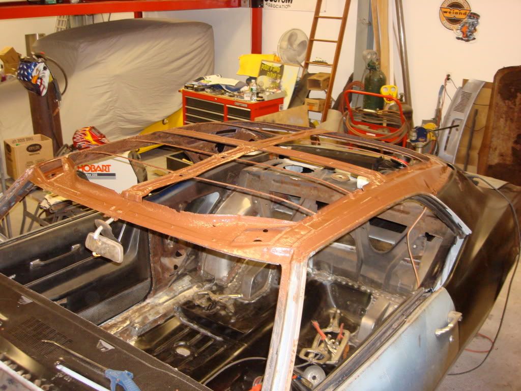

We took the roof off, wire wheeled it and used a rust preventing primer. It was pretty nasty looking when we first took the roof off.
http://i819.photobucket.com/albums/z...o/DSC01964.jpg

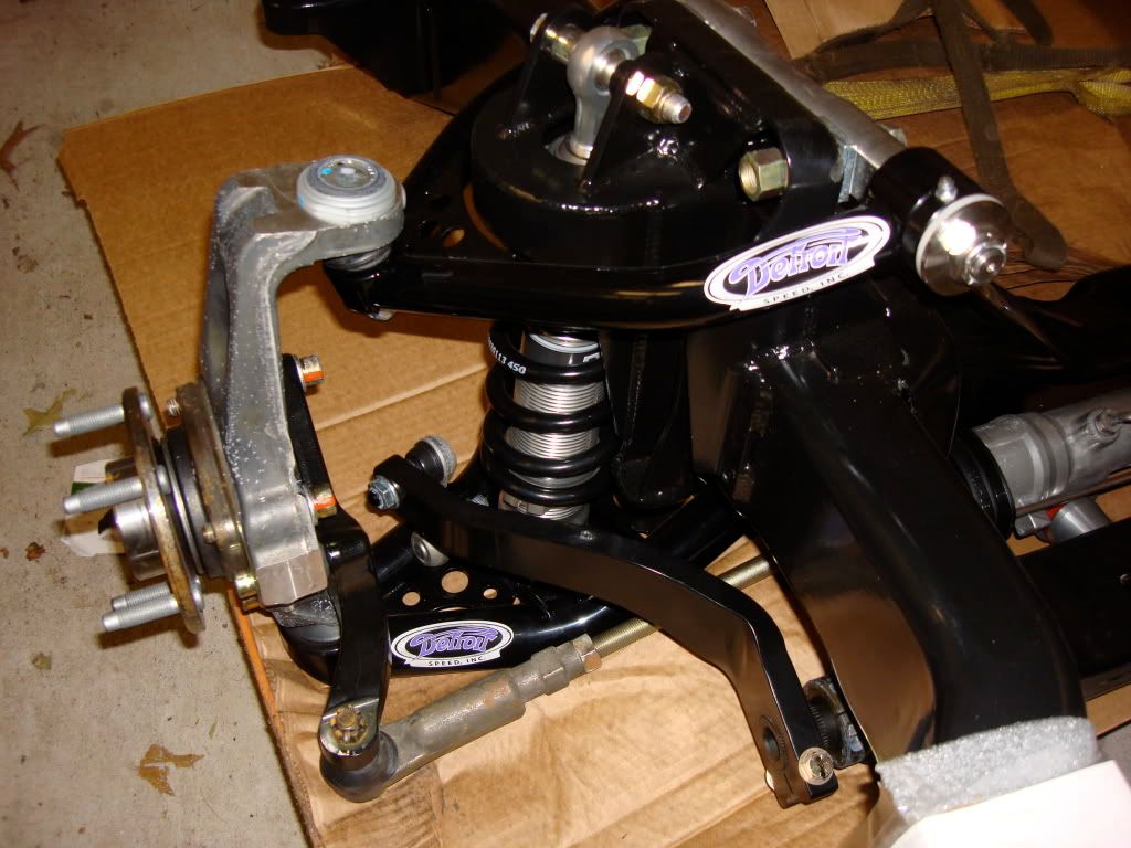

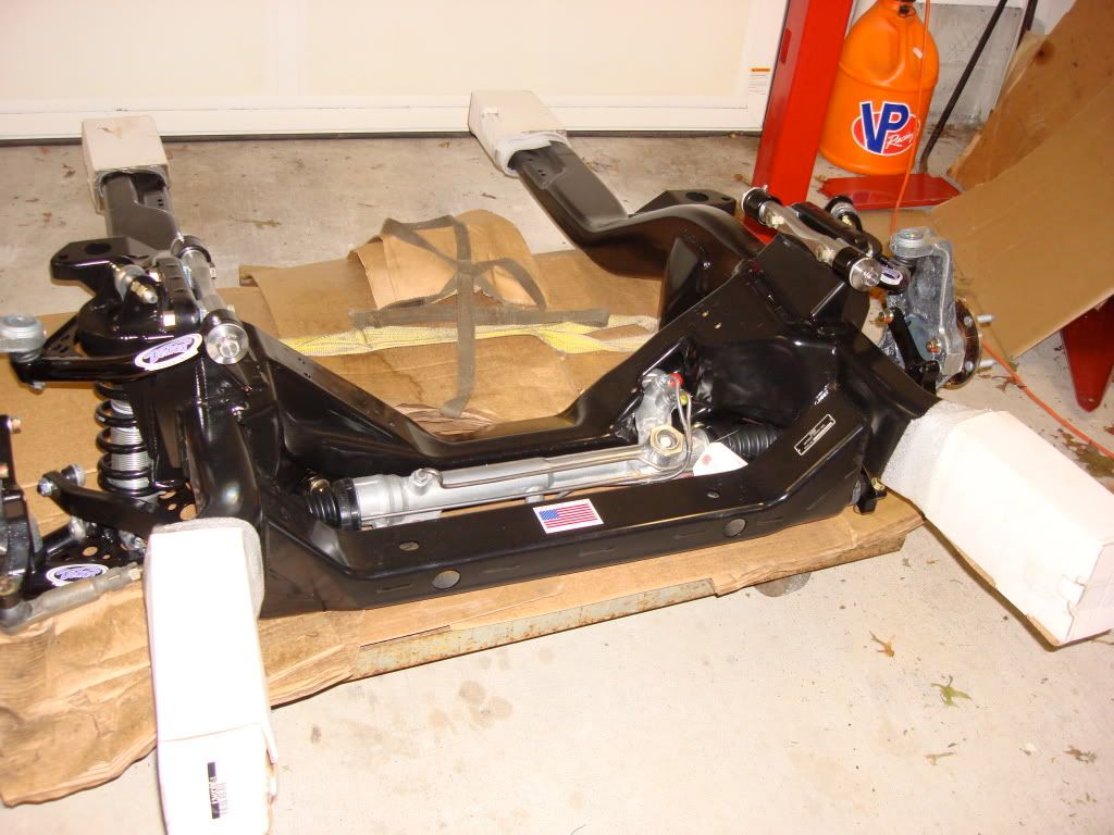

More DSE stuff. I could... i have stared at this frame for hours. It is a work of art to say the least.
http://i819.photobucket.com/albums/z...o/DSC02028.jpg
http://i819.photobucket.com/albums/z...o/DSC02029.jpg

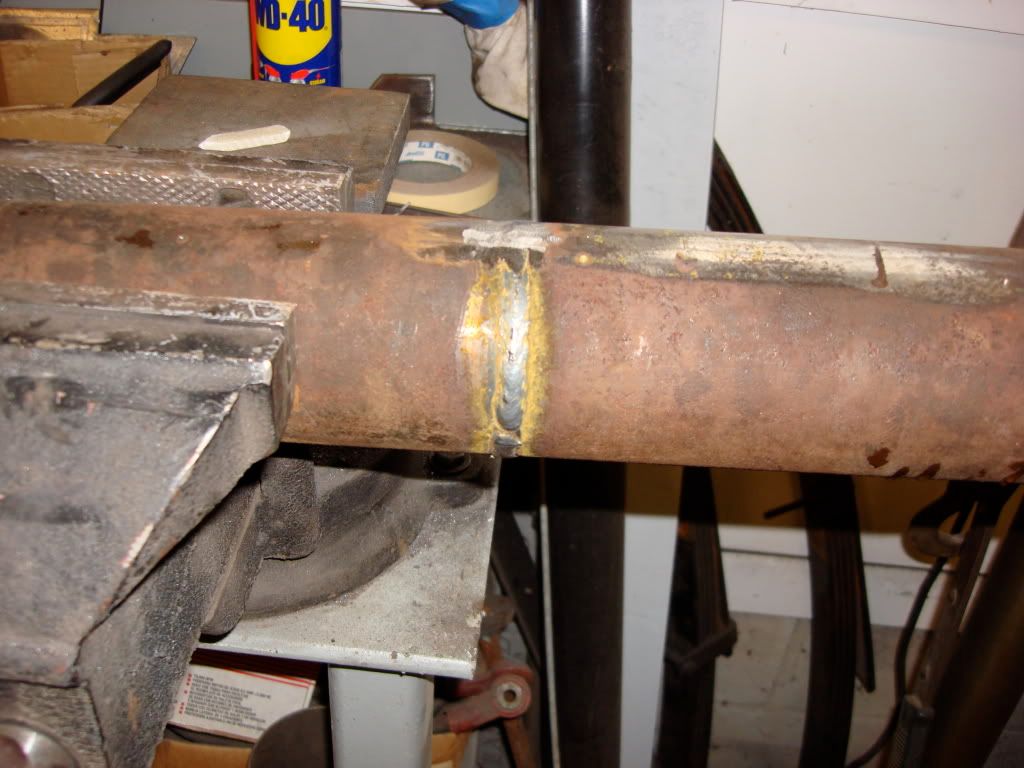

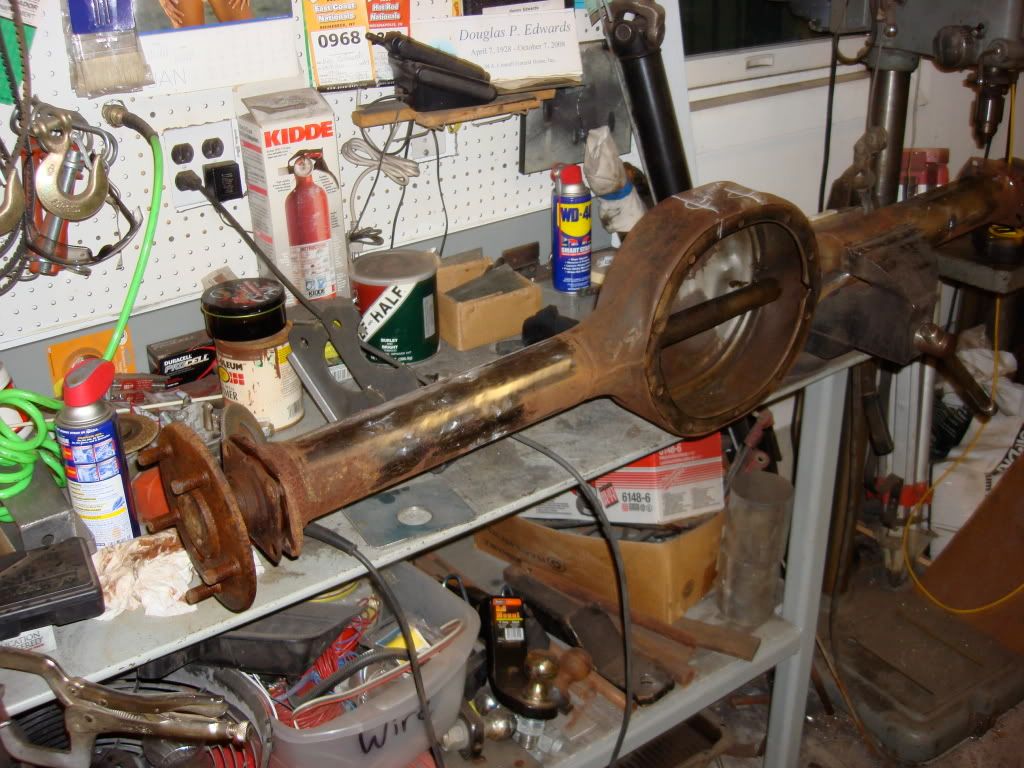

Narrowed the rear
http://i819.photobucket.com/albums/z...o/DSC02031.jpg
http://i819.photobucket.com/albums/z...o/DSC02032.jpg
http://i819.photobucket.com/albums/z...o/DSC02036.jpg
Mocking up the quadra-link brackets and double checking the measurments before I weld it solid and powdercoat it.
http://i819.photobucket.com/albums/z...o/DSC02055.jpg

We finished the front of the cage, two down bars coming from the main hoop to the front of the rockers with a arched hoop between.
http://i819.photobucket.com/albums/z...o/DSC02058.jpg
http://i819.photobucket.com/albums/z...o/DSC02061.jpg
http://i819.photobucket.com/albums/z...o/DSC02064.jpg
http://i819.photobucket.com/albums/z...o/DSC02067.jpg
http://i819.photobucket.com/albums/z...o/DSC02070.jpg
Looking through these pictures makes me want to finish it NOW :willy: :willy: :willy:
