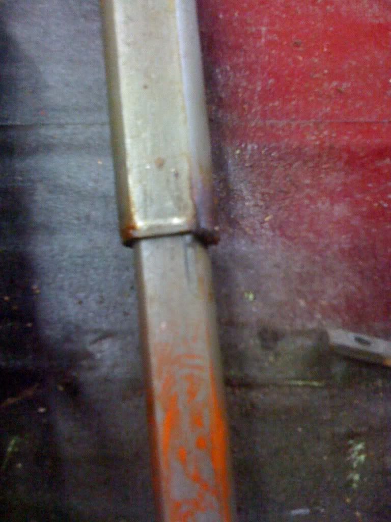

GM Muscle 04-02-2010 02:03 PM
ok, so i removed the rag joint collar. the problem is that the splined end of the steering shaft was flaired to hold the collar on!
http://img.photobucket.com/albums/v3...b/7f7d50ab.jpg
:willy: so can i just cut off the flaired portion and use the straight part thats left (maybe 1/2 and inch) or should i disassemble the lower part of the column and use a weld in a splined insert? i would really like to use a ujoint and be done but i want whats going to work best.

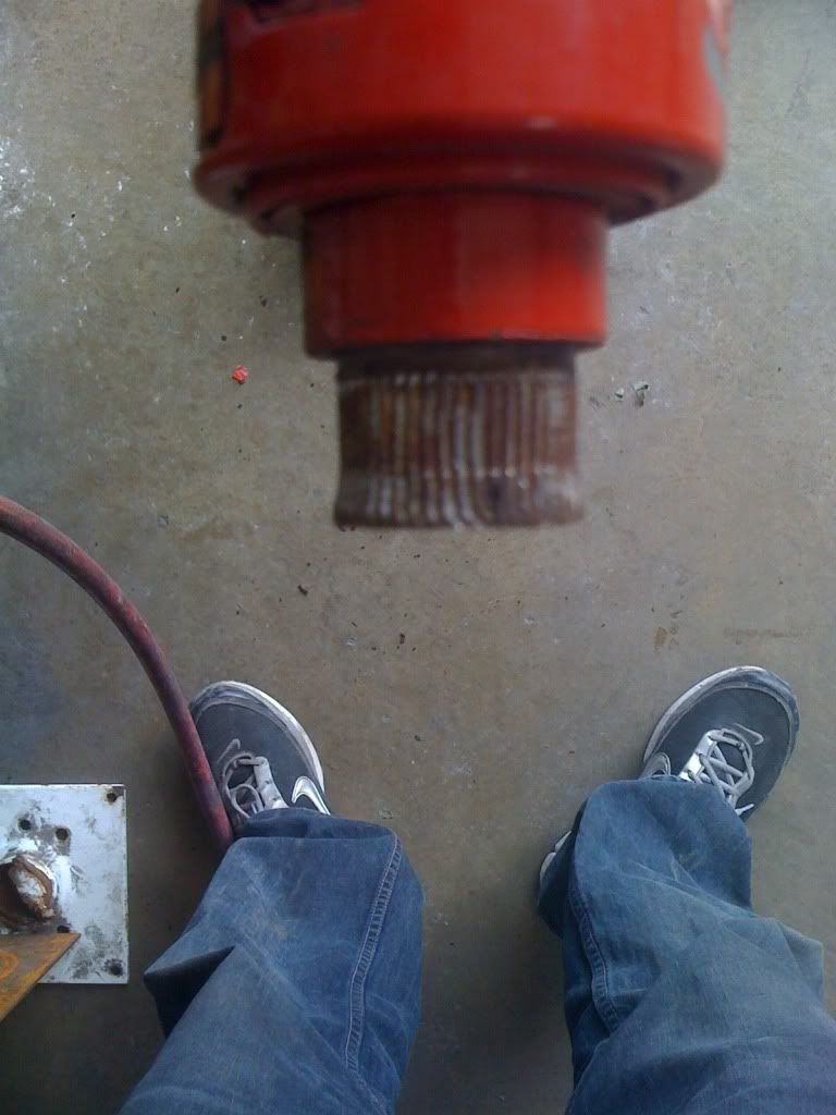

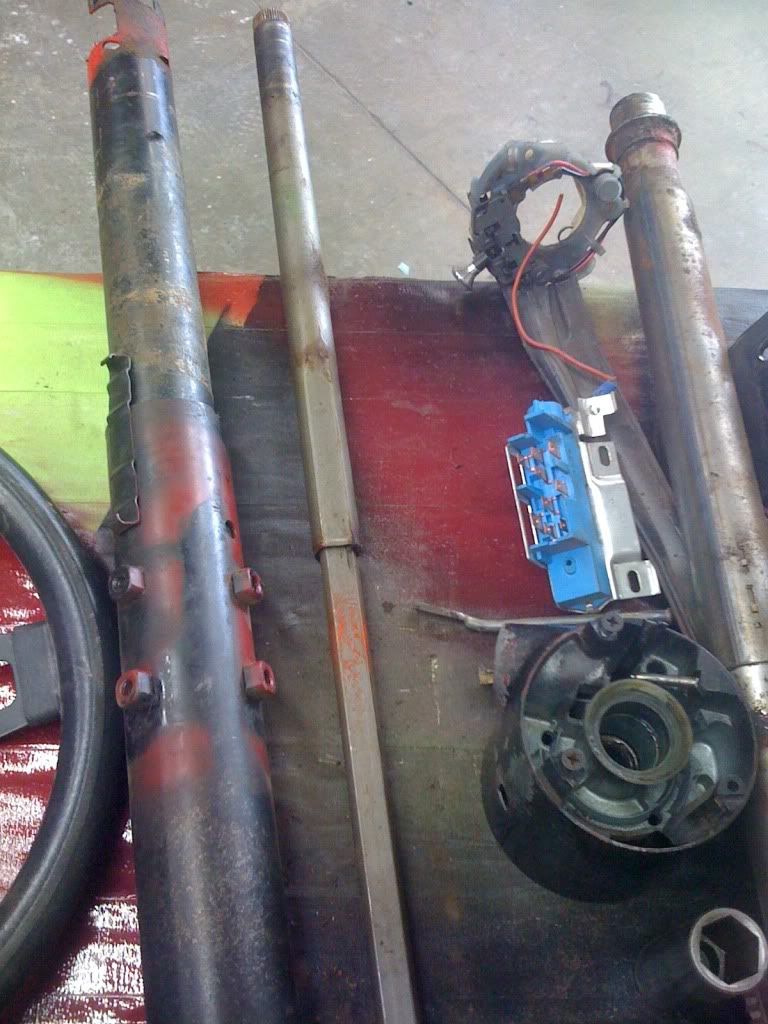

GM Muscle 04-02-2010 03:45 PM
ok.. i said #^&* it and went deeper.. looks like i may be able to find a d shaft and run it down in the steering tube and use a few plug welds to secure it. then i can still use the factory bearings and i can also use a cheaper u-joint. what do you guys think?

then i have to figure out how all this goes back together:faint:
