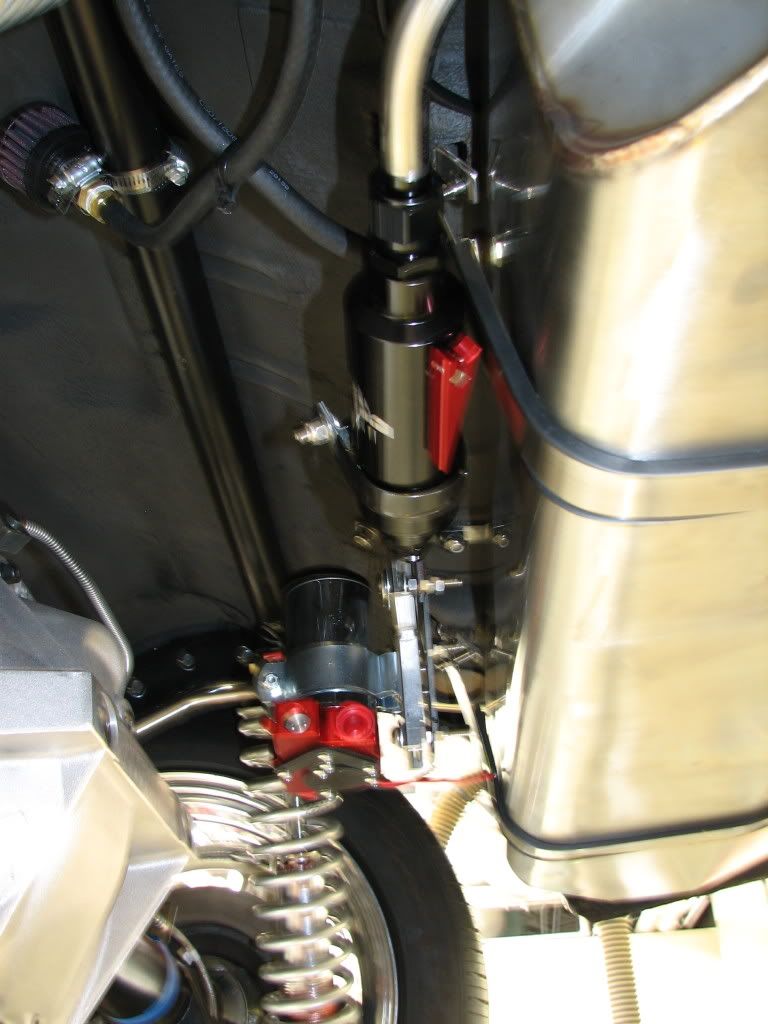

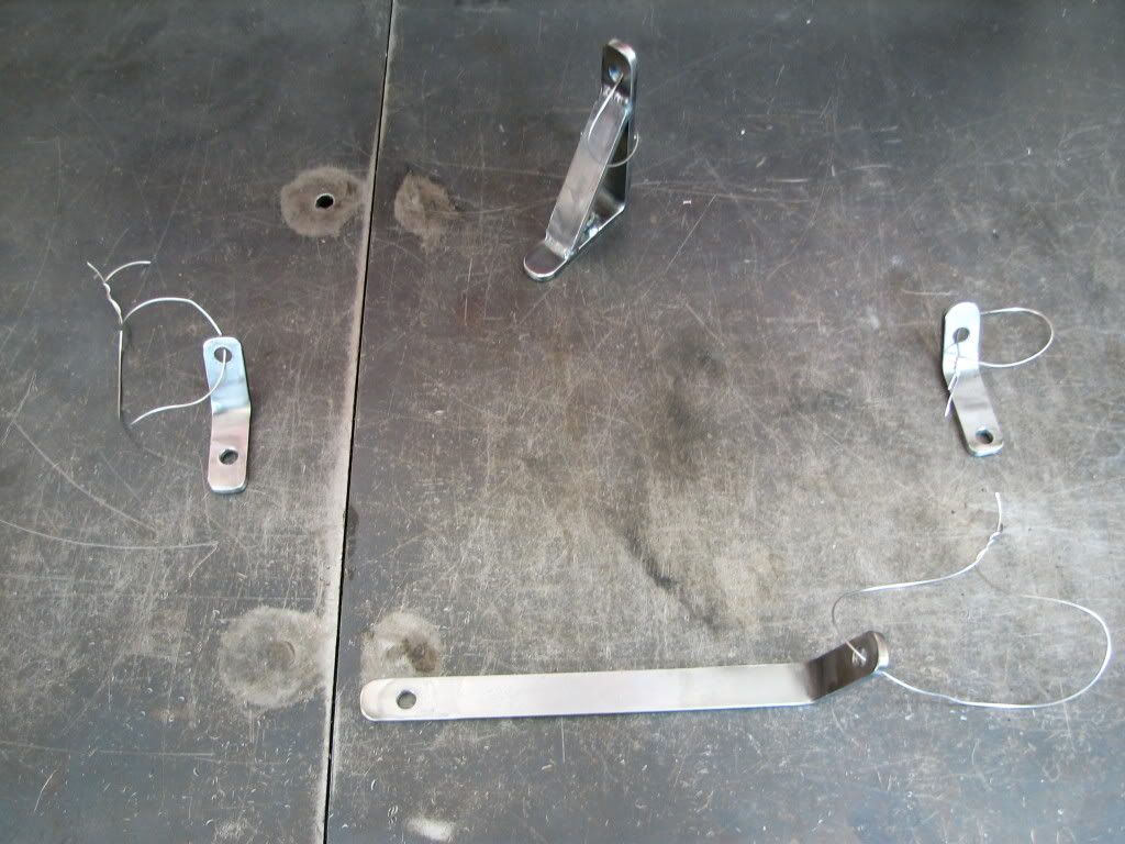

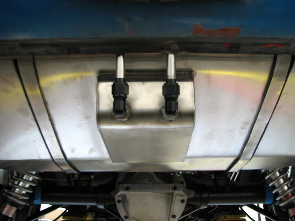

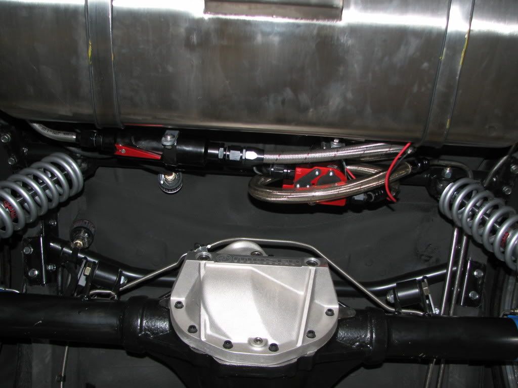

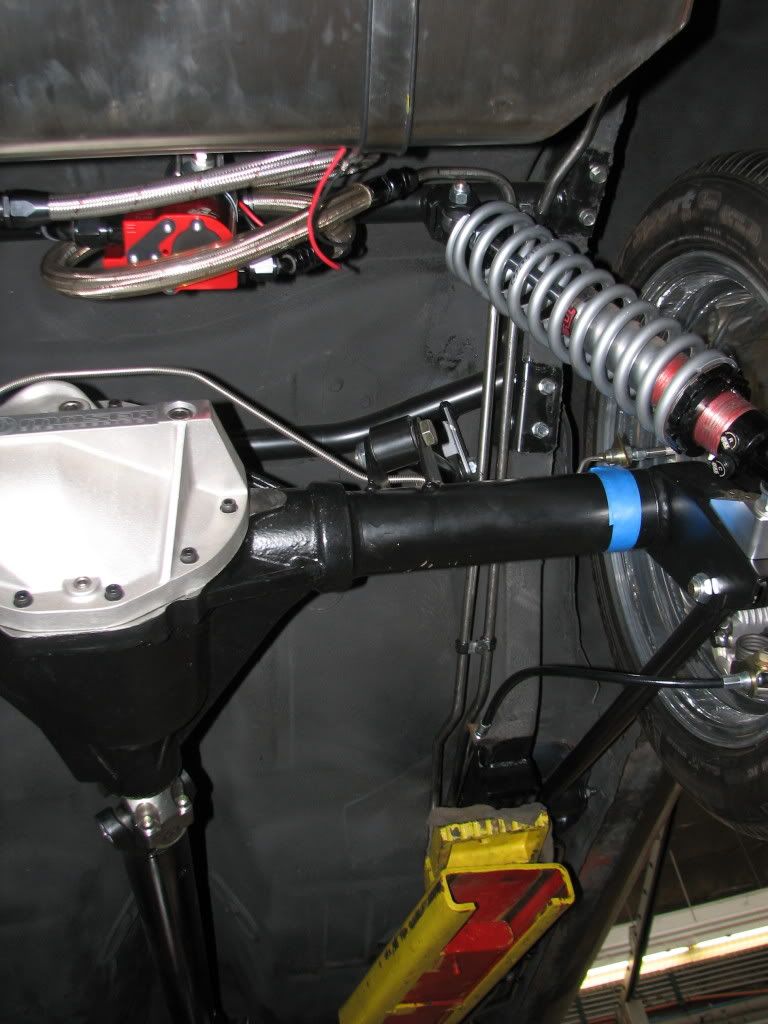

Not a A1000 but their SS Pump with a Rick's sumped tank:
Mounted on a straight bracket bent at like 45* angle with bolts through grommits (to dampen pump vibration) mounted to a some aluminium channel that was made into a "T":
http://i328.photobucket.com/albums/l...lSystem012.jpg
All tucked up in between the pumpkin and tank:
http://i328.photobucket.com/albums/l...lSystem009.jpg
http://i328.photobucket.com/albums/l...lSystem018.jpg
The Brackets being powder coated silver:
http://i328.photobucket.com/albums/l...lSystem014.jpg
Also each of side the pump has a short stainless steel flex hose to allow for motion/movement.

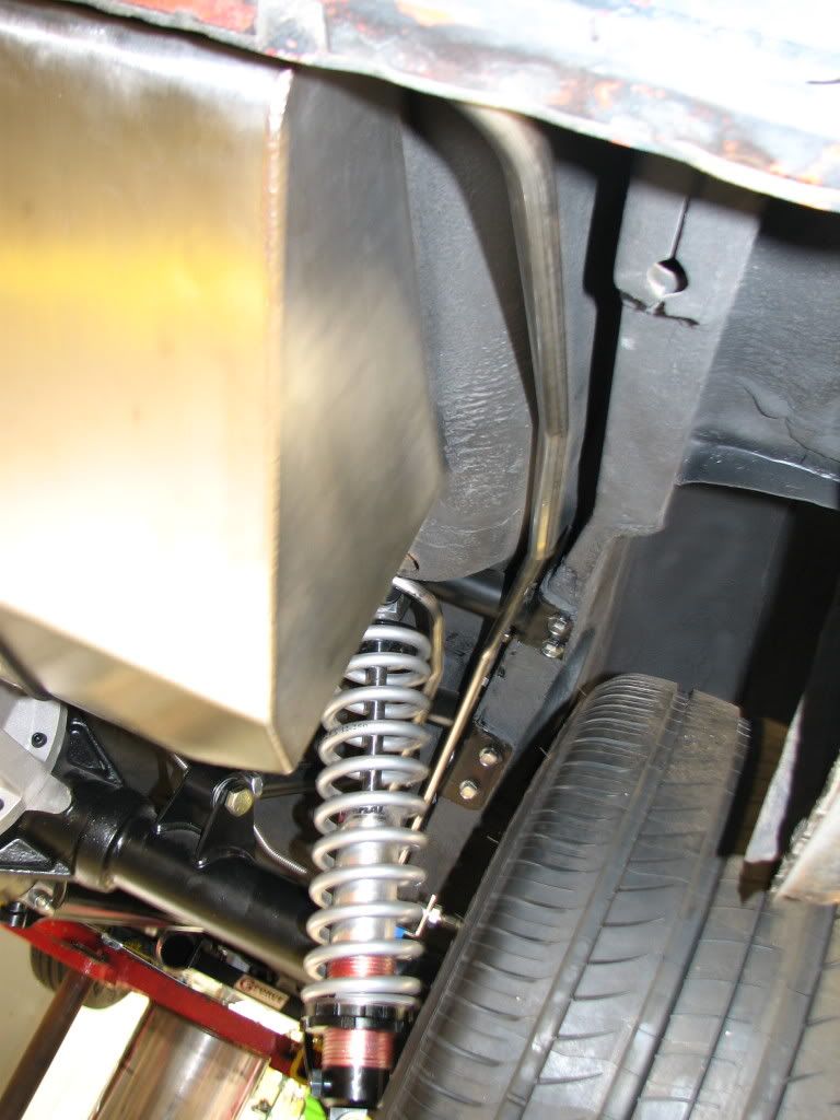

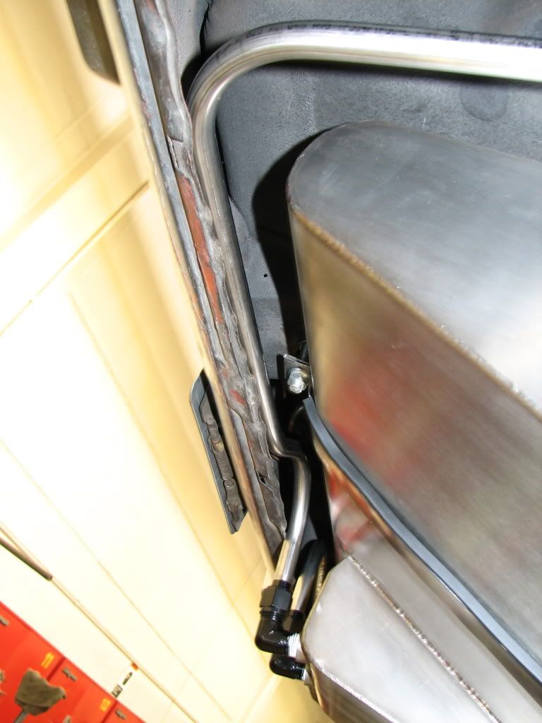

Routing of fuel lines:
http://i328.photobucket.com/albums/l...lSystem004.jpg http://i328.photobucket.com/albums/l...lSystem005.jpg http://i328.photobucket.com/albums/l...lSystem006.jpg http://i328.photobucket.com/albums/l...lSystem019.jpg

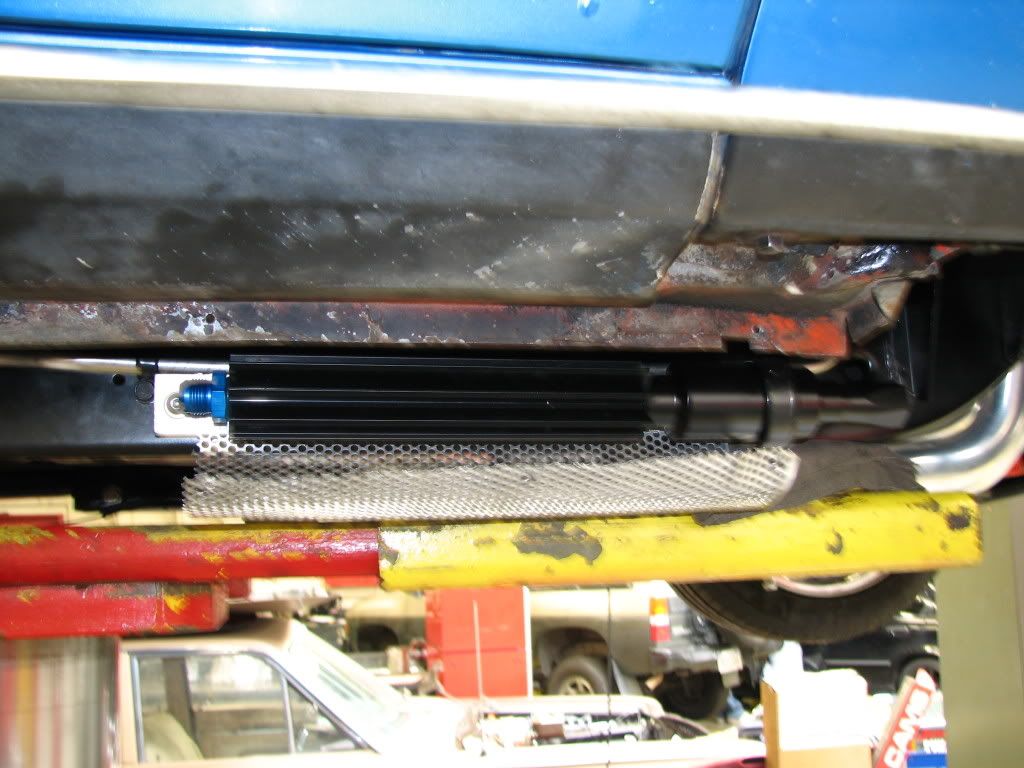

Even put a fuel cooler right before the carb on the passenger's undercarriage:
http://i328.photobucket.com/albums/l...lSystem001.jpg http://i328.photobucket.com/albums/l...lSystem026.jpg

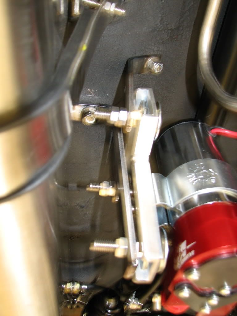

awesometool 08-05-2010 07:55 PM

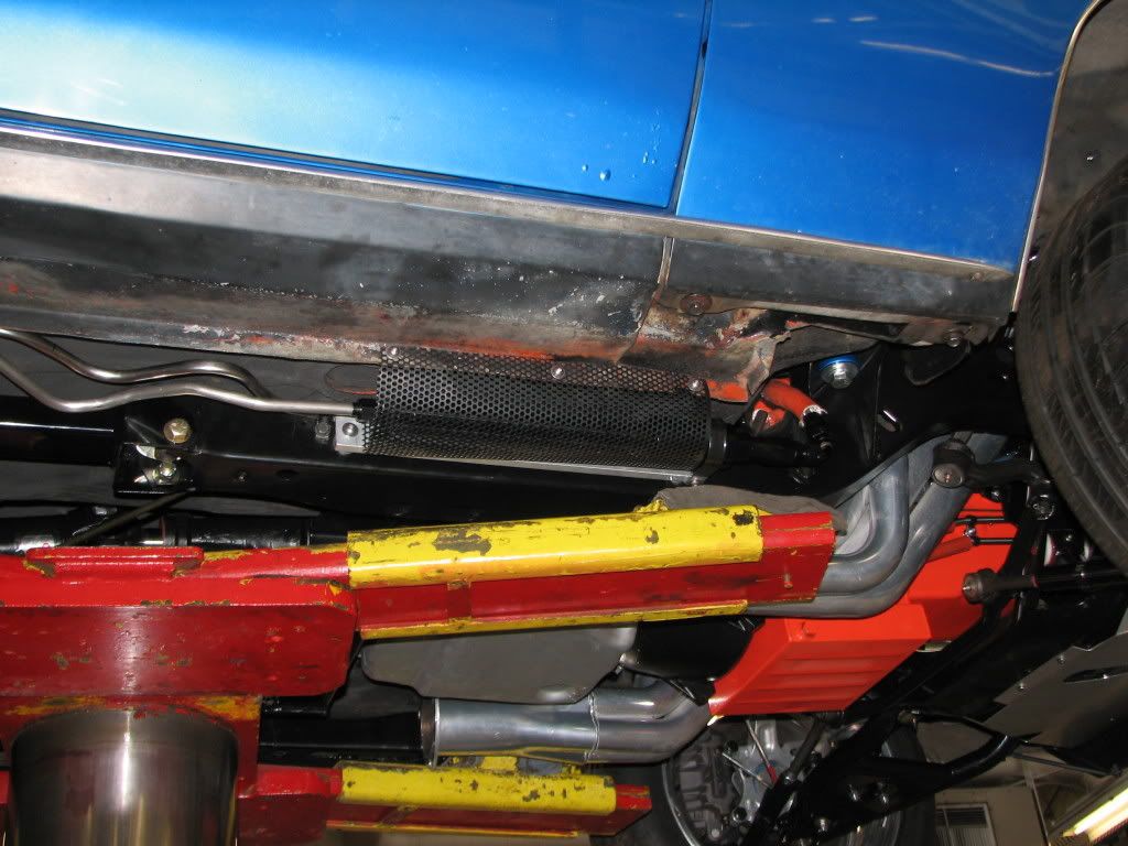

I have an L shaped bar bolted to the fuel tank straps with a plate for the pump and rubber backing on the plate. Here are some pics.
http://a.imageshack.us/img651/7105/9exhaust3.jpg
http://a.imageshack.us/img713/5950/9exhaust13.jpg
