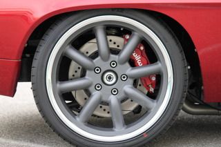

BBC with very little vacuum and running a manual Wilwood front/rear setup with a 7/8 bore master. Hit the pedal hard and if you are not paying attention and you will bury yourself into the steering wheel. We have a number of kits that we can offer you. Feel free to call, PM, or email for pricing and info.
http://i2.photobucket.com/albums/y8/...5/IMG_1329.jpg
