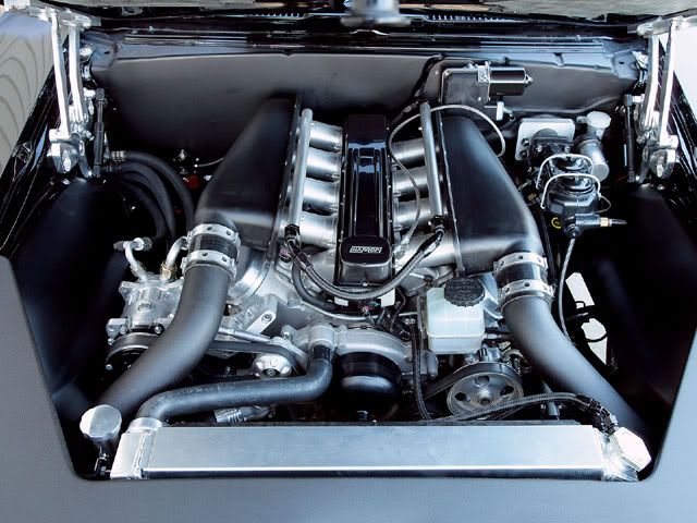

Need to replace one of the intake boxes on my Harrop so I'm researching which is better, the cold air intake pictured below or individual stacks. I guessed cold air intake. Looks like I may be wrong and individual stacks are better due to some pressure build up in the 'central air' set up.
Any one have the definitive answer? I've searched so much and read so much tech on ITB's and intakes my head hurts. Better = more HP and maybe drivability?- maybe.

If you are talking about just putting filters on the end of the stacks and pulling in engine heated air, then I would say that you should stick with the current cold air package. Outside fresh cool air is always better then engine temp heated air for power and running more timing.
If you do change to individual filters and pull in engine temp air, most likely a retune in relation to AF and timing will be needed.
Did one side warp or crack?? Or did you have an "Oops" ??
Hope this helps.
Mike Norris

I guess the questions are (1) do you want to make more power and (2) does the engine have enough potential to support the full airflow of 8 ITB's?? One easy way to see if there is more in the engine is too see what the MAP sensor is doing at WOT. If the readings stay in the high 90's kpa, then it is doing pretty well. If the MAP is dropping to low 90's or even high 80's kpa, there is a signifigant restriction and more air should help.
I agree that the dual 3" tube are about a 35% drop of potential airflow, but going to dual 4" openings will equal it out and still allow fresh cool air.
I guess if it were me, and not knowing the potential HP of the engine beyond where it sets now, I would prefer to have the dual 3" openings and fresh cool air versus 8 ITB's and hot engine bay air. Now going to 3.5" dual tubes brings up the potential airflow by 25%.
Best scenario with re-engineering and retuning is dual 4" tubes to a slightly larger but similar plenum for each side.
A few options for sure. Hope this helps Dave.

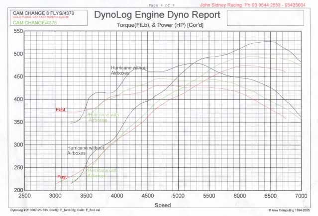

So I heard from Harrop, the boxes are not even sold with the intake anymore. Better performance without and most people did some thing unique. Below is a dyno graph comparing Harrop with- box / stacks / vs / FAST
http://i232.photobucket.com/albums/e...ne-vs-Fast.jpg
Mike helps a lot, thanks. I'll get back to you with details. More HP of course!
