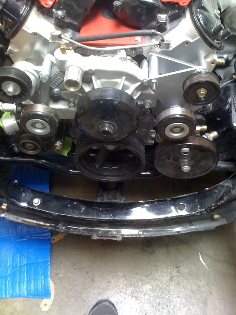

Now i know this guy isn't the master fabricator but do you guys think this is an effective breather setup? i will still run a pcv valve from the intake to crankcase.
I was thinking about running one on each side between the head and the acc brackets.
http://img.photobucket.com/albums/v3...g?t=1270587653
The thing i like about his article is that i can build these tanks myself in a small enough fashion that they will fit. Do you guys think the area given ~(6"x3") would be big enough? i might have to drain them more often but at least i could keep them small and clean. i was thinking -10 or bigger line from the front of each valve cover to the tank on each side or just building a "log" between each cover. then on the rear of the passengers valve cover running the pcv to the manifold (ls1 performer rpm)
camcojb 04-06-2010 02:13 PM
they'd be fine with a larger breather, as long as you run two of them.
