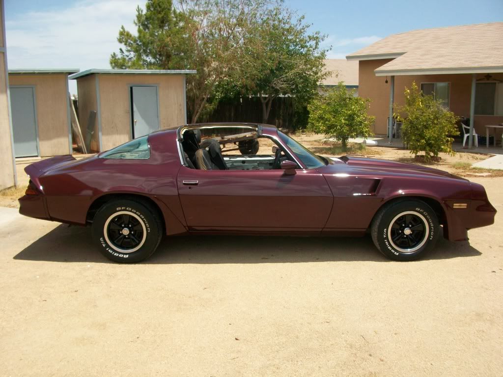

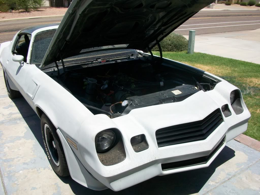

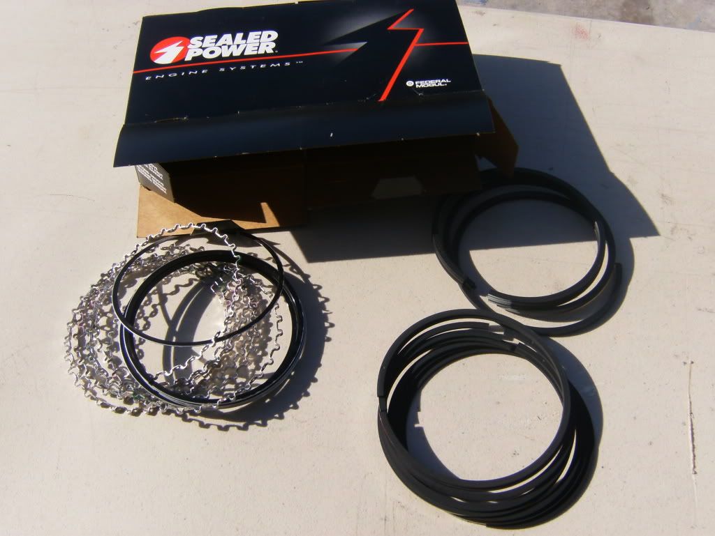

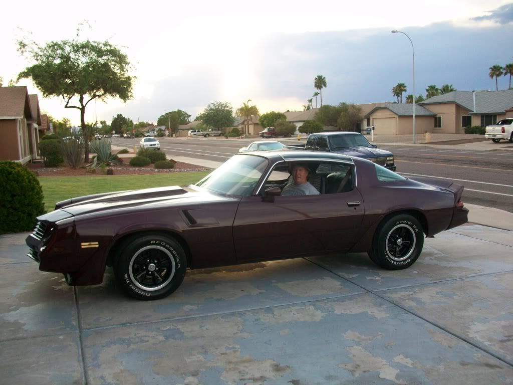

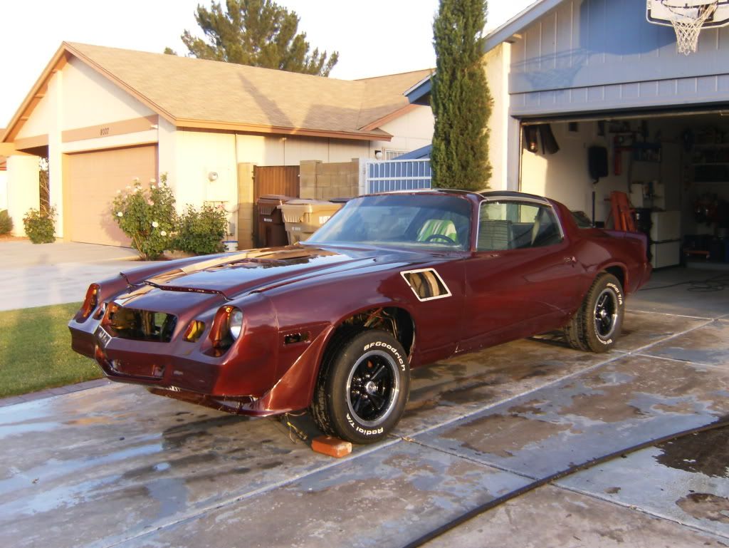

Well since my dad and I have geared up and started working on his Camaro project again (he dubbed "Trailer Trash Treasure") I figured I would go ahead and post up a build thread on it.
The car is a 1980 Camaro Z-28 that I bought for him about 8 months ago (he used to own one in the 80's). I painted it the color of his old car and now we are working on building the engine for it. It will have a 5.3l LM7 out of an 04 Tahoe. Plans for the engine include and LS6 cam, LS6 intake, a set of 317 heads milled .030 off an LQ4 (w/LS6 springs), and flat top 4.8l pistons all over a stock bottom end. We are hoping to just about double the factory 190hp with this combo. It will have a 4L60E out of a 2001 Camaro behind it with a little stall in the converter. The idea is to have a factory appearing 80 Z-28 with modern drivability and power. Let us know what you guys think of the car and the progress so far. All criticism is more than welcome!

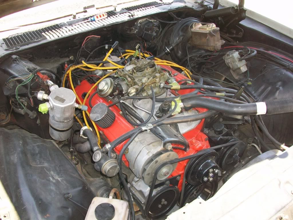

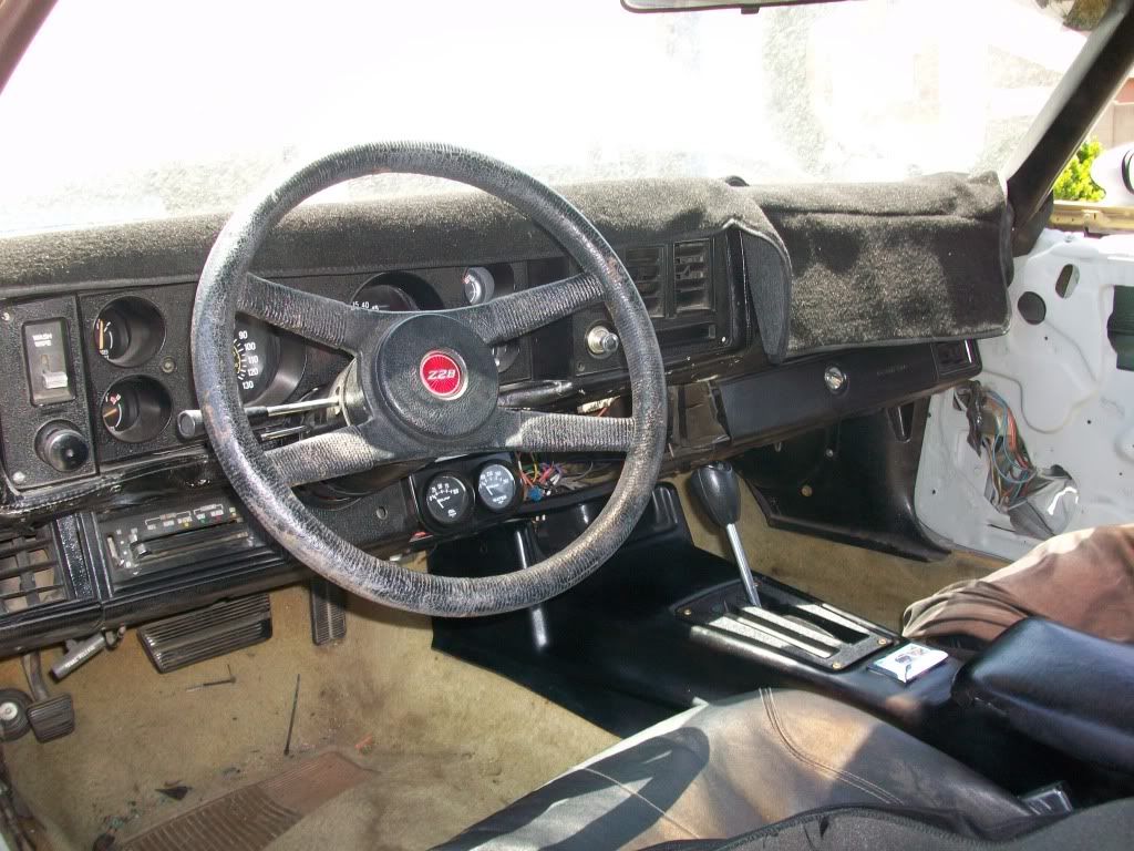

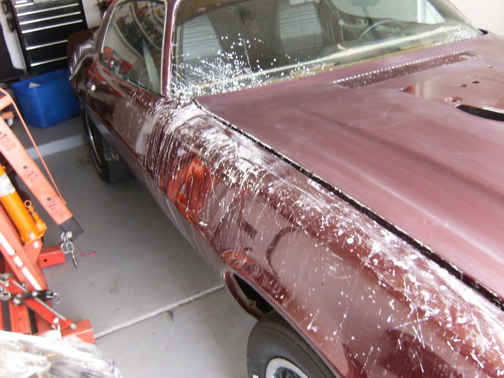

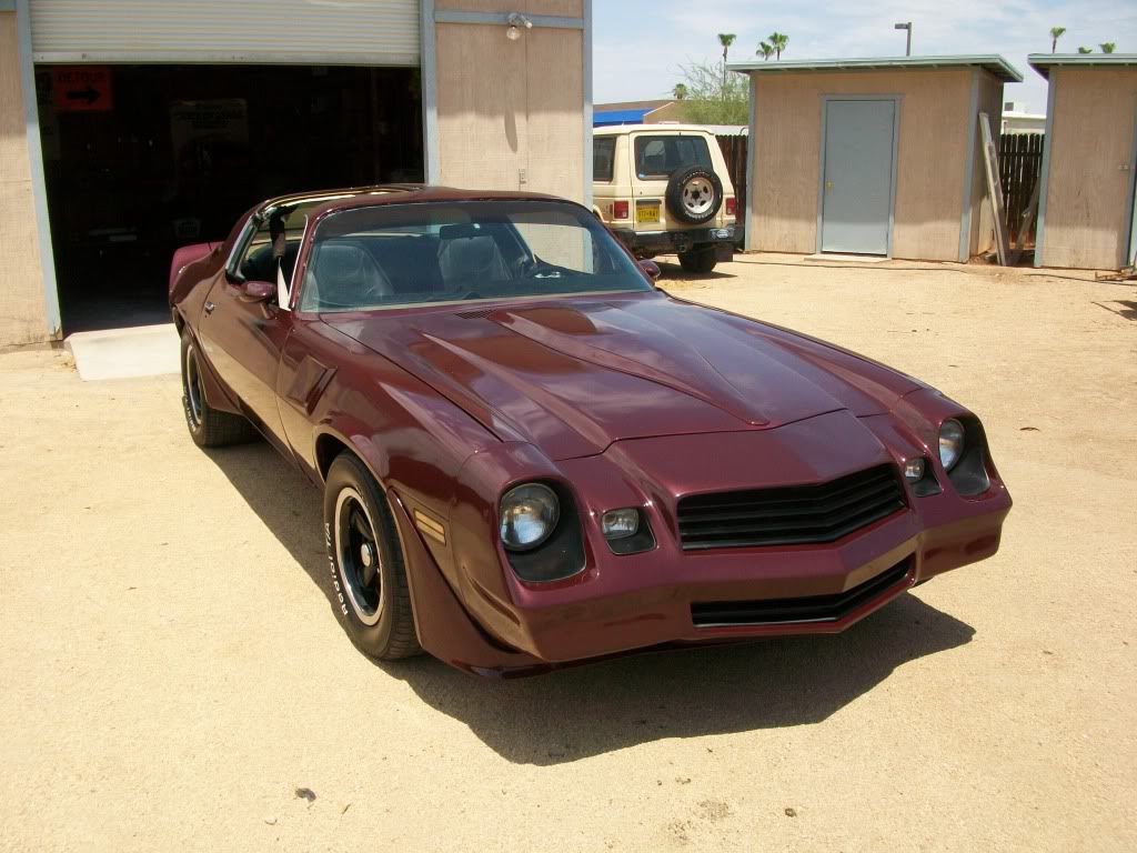

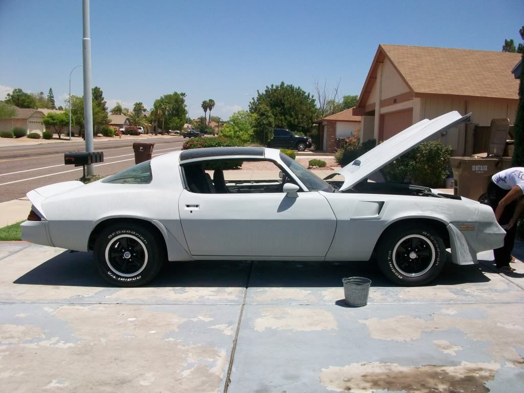

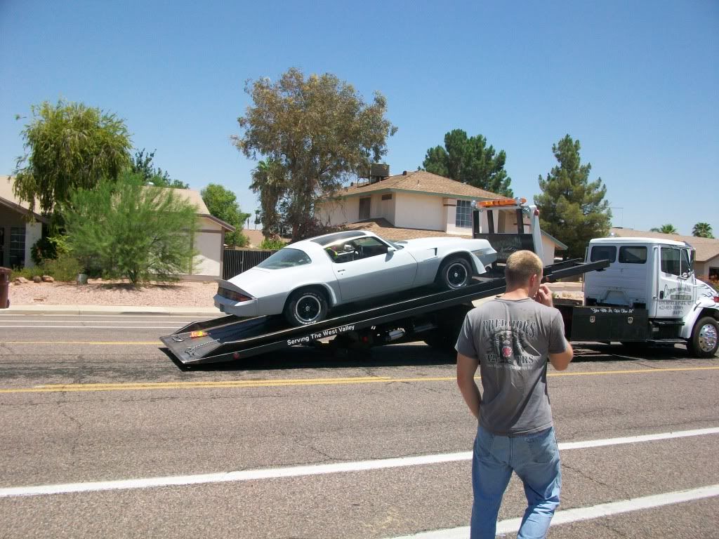

The day I got it;
http://i270.photobucket.com/albums/j.../14July092.jpg
http://i270.photobucket.com/albums/j...14July0915.jpg
http://i270.photobucket.com/albums/j.../14July094.jpg
http://i270.photobucket.com/albums/j.../14July095.jpg
http://i270.photobucket.com/albums/j.../14July097.jpg

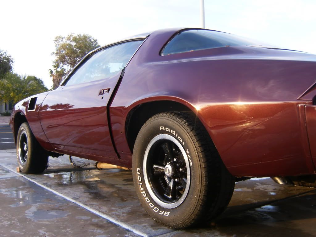

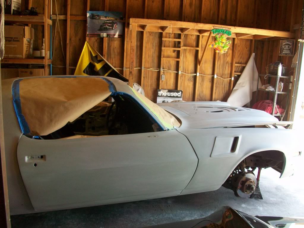

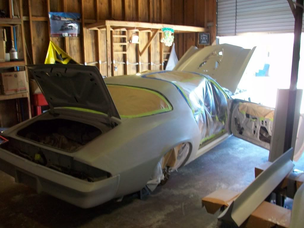

70TWO NOVA 04-06-2010 02:27 PM

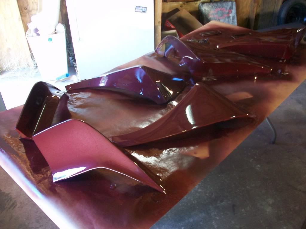

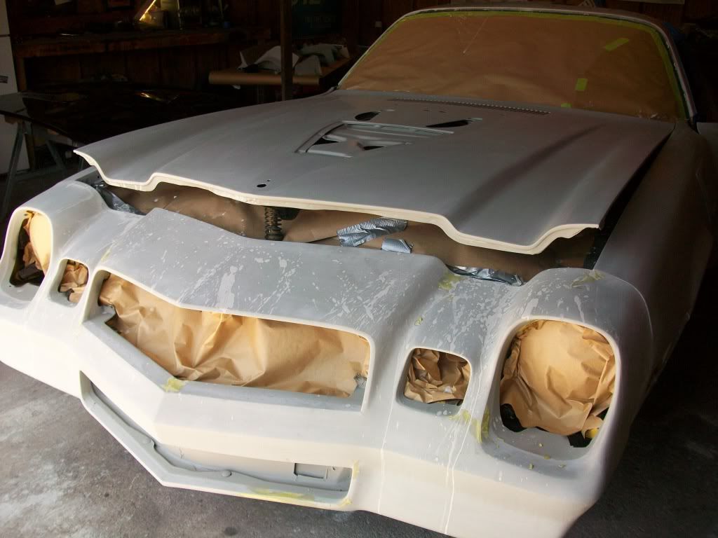

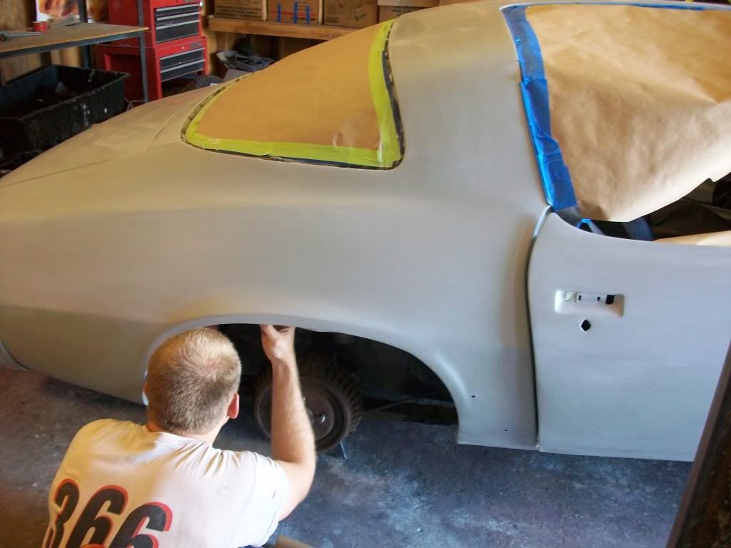

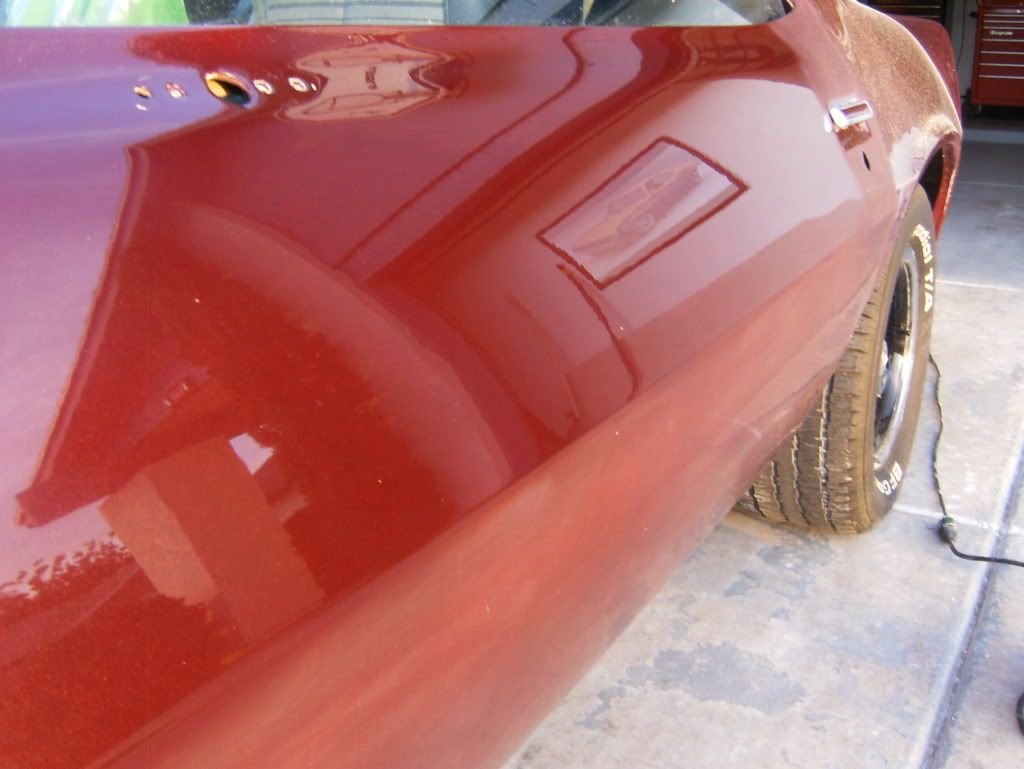

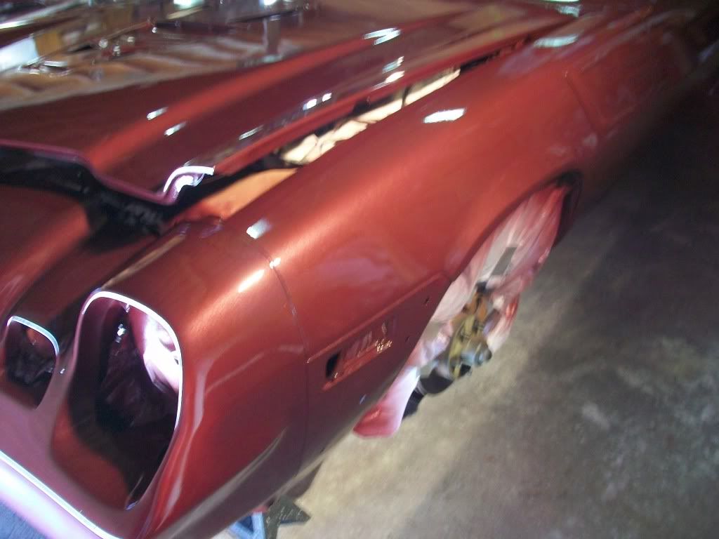

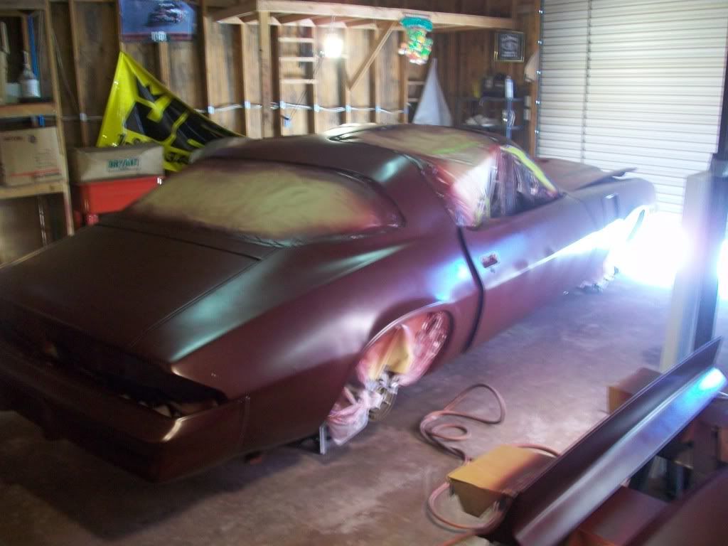

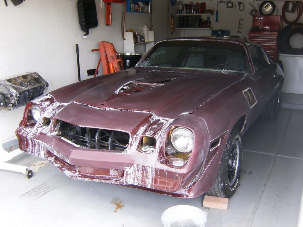

body/paint;
http://i270.photobucket.com/albums/j.../19July093.jpg
http://i270.photobucket.com/albums/j.../19July092.jpg
http://i270.photobucket.com/albums/j.../19July096.jpg
http://i270.photobucket.com/albums/j...8/19July09.jpg
http://i270.photobucket.com/albums/j.../20July099.jpg
http://i270.photobucket.com/albums/j.../20July095.jpg

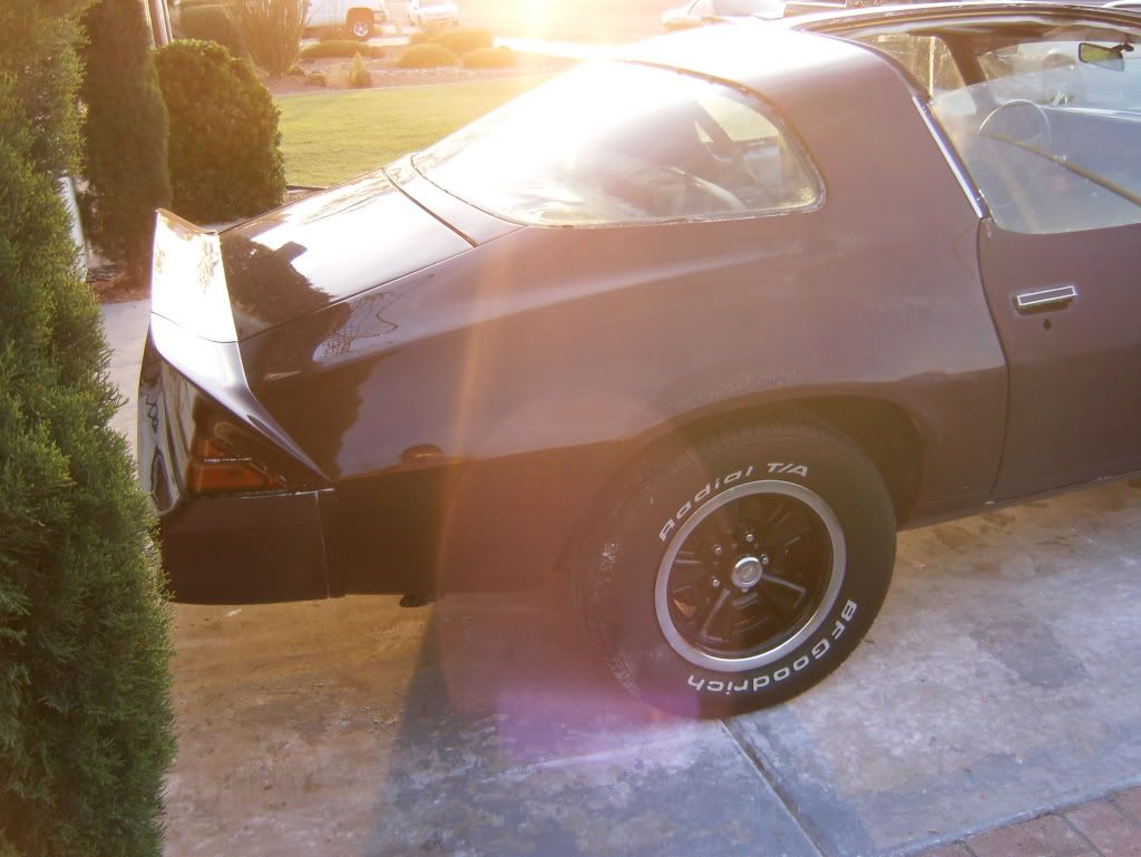

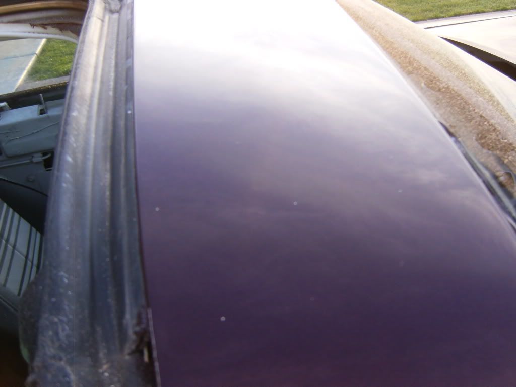

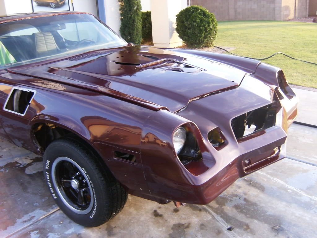

70TWO NOVA 04-06-2010 02:29 PM

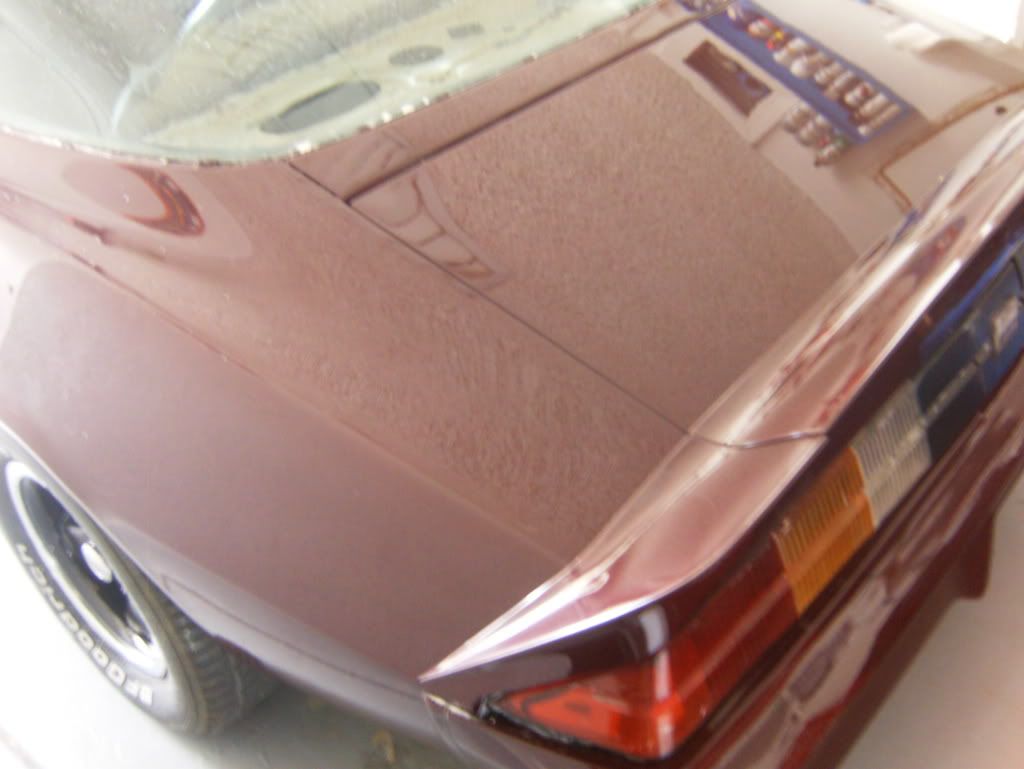

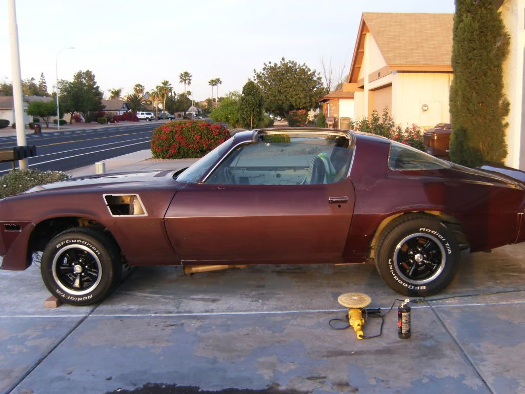

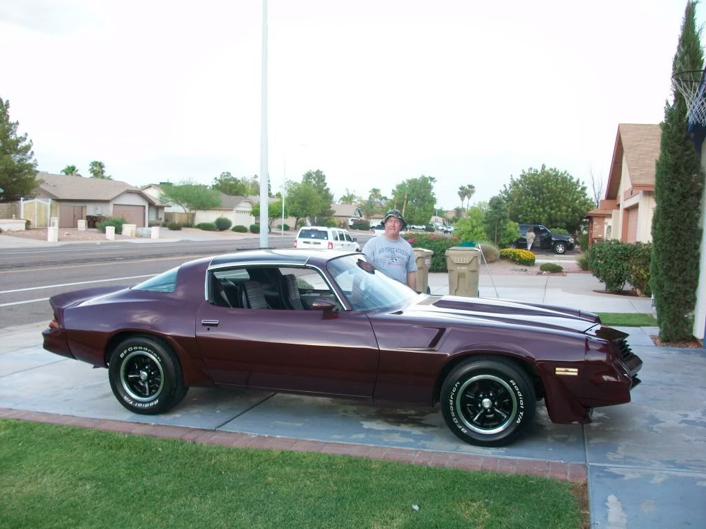

after clear...
http://i270.photobucket.com/albums/j.../20July096.jpg
http://i270.photobucket.com/albums/j.../21July092.jpg
http://i270.photobucket.com/albums/j.../21July095.jpg
http://i270.photobucket.com/albums/j...8/22July09.jpg
http://i270.photobucket.com/albums/j.../22July092.jpg

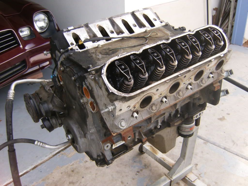

70rs 04-06-2010 02:30 PM
So far so good. I like your plan for it. (and the color too).

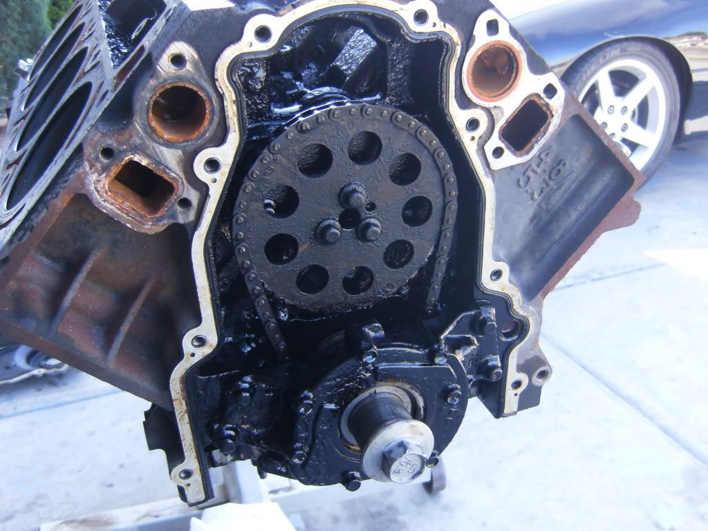

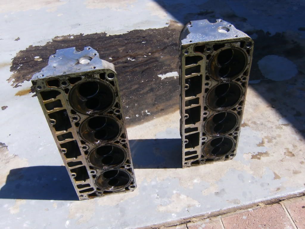

I am curious though, can you use the heads off a 6.0 on a 5.3 saflely? I ask because I thought the valves would hit the cylinder walls since the 5.3 has a smaller bore. Or am I confused? (and that is OFTEN:D )

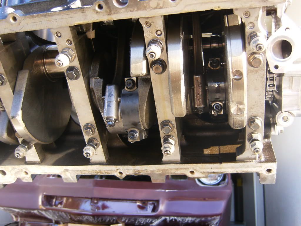

70TWO NOVA 04-06-2010 02:31 PM

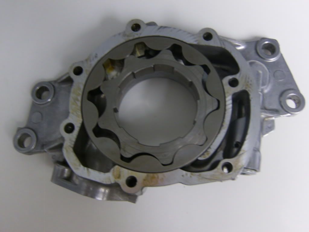

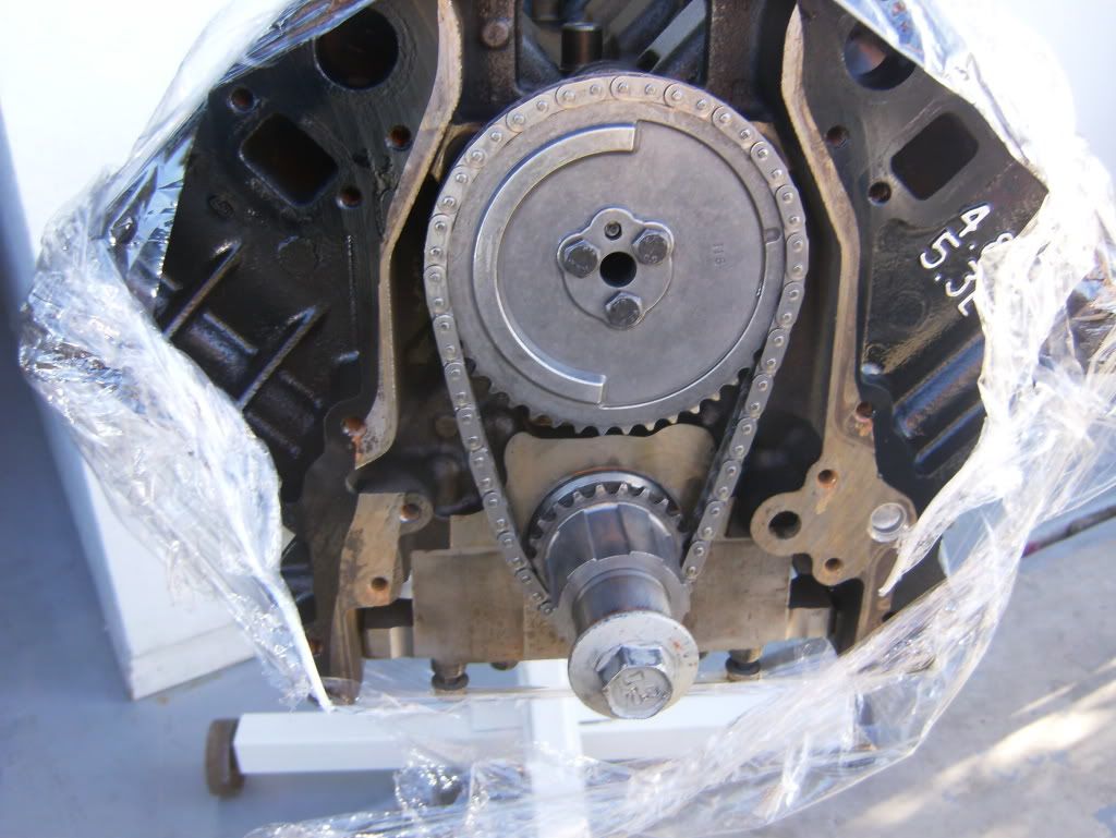

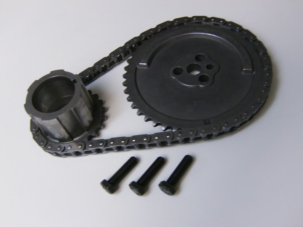

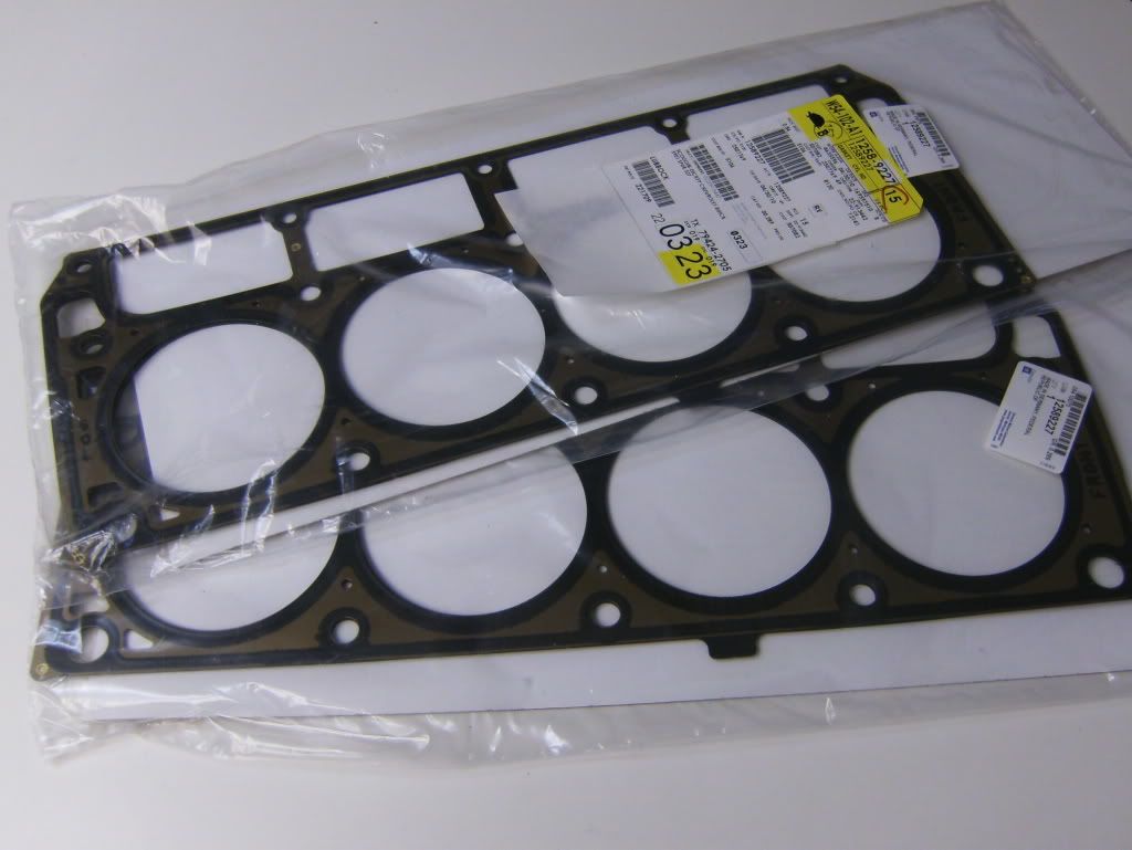

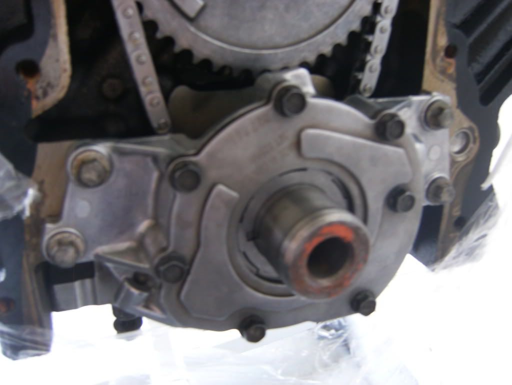

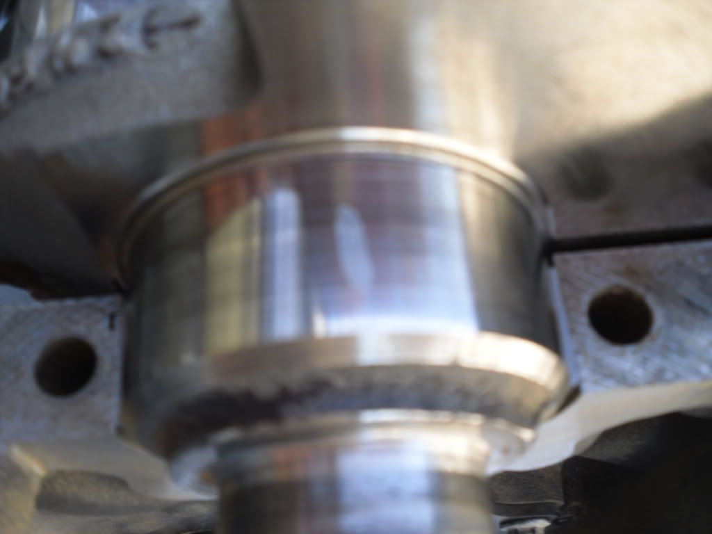

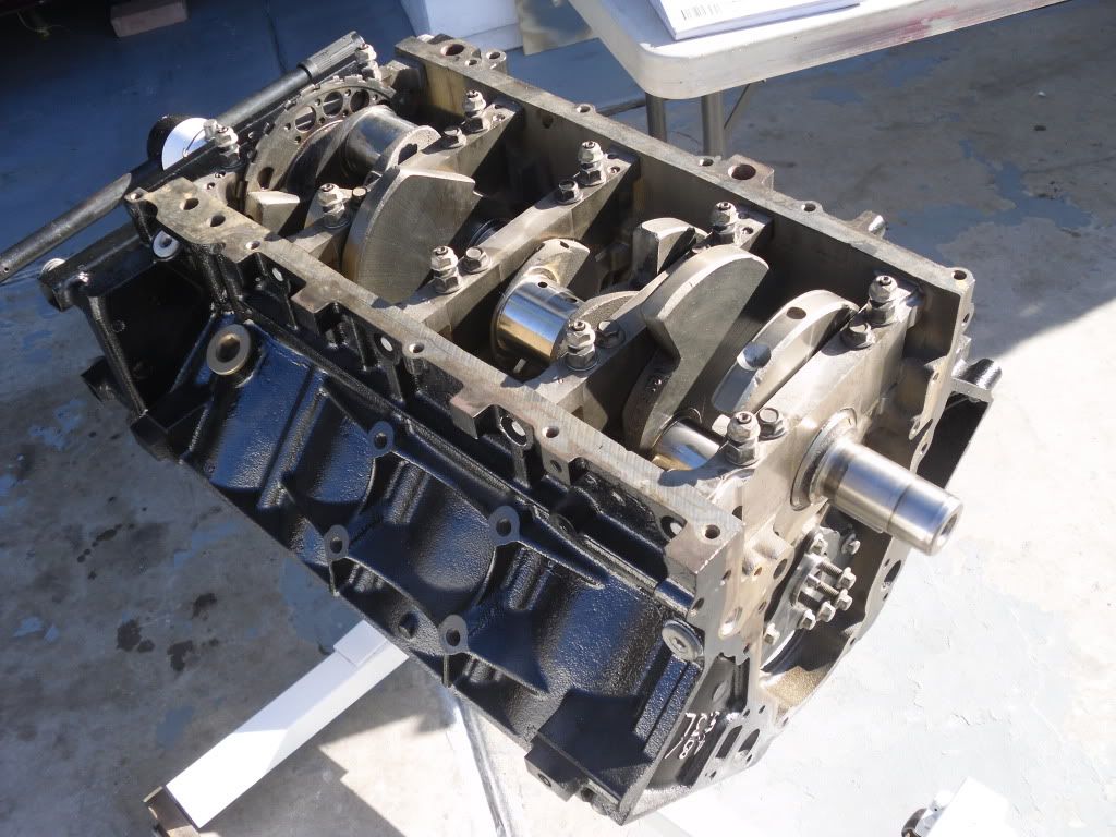

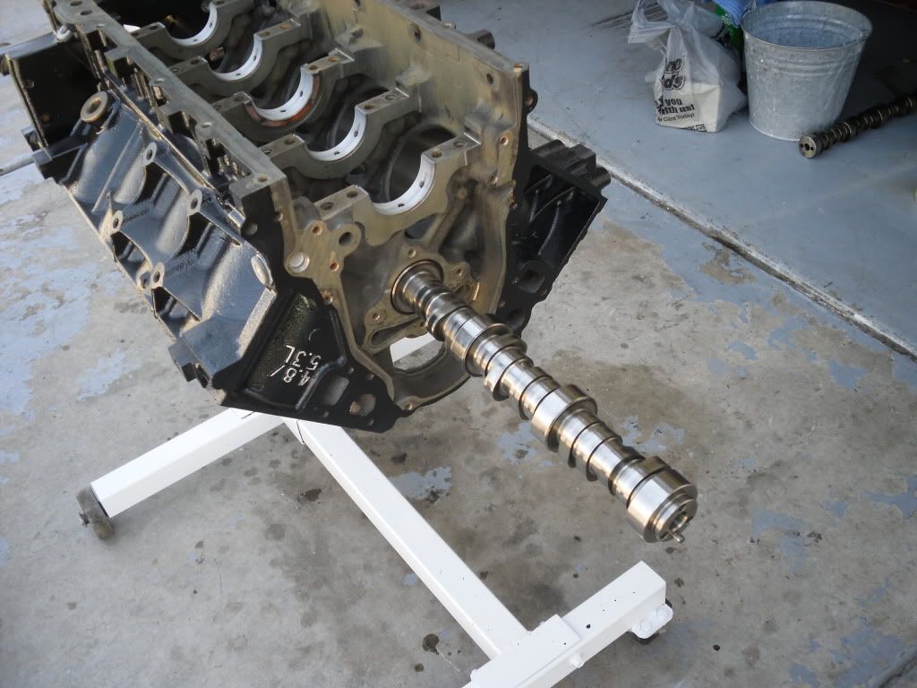

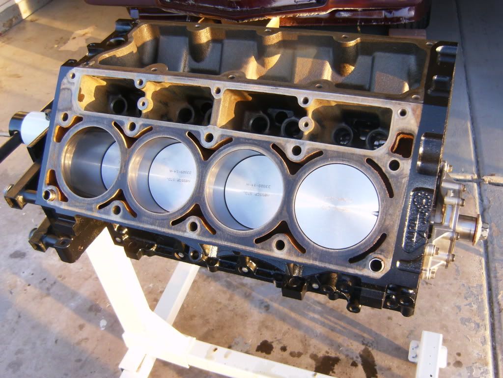

the engine stock LM7...
http://i270.photobucket.com/albums/j...Mar2920103.jpg
http://i270.photobucket.com/albums/j...Mar2920104.jpg
http://i270.photobucket.com/albums/j...ar29201016.jpg
http://i270.photobucket.com/albums/j...Mar3120103.jpg
http://i270.photobucket.com/albums/j.../Mar312010.jpg
70TWO NOVA 04-06-2010 02:33 PM
yes, you can use up to a 2.00" valve safely on a smaller 4.8 or 5.3. Its only when you upgrade to the larger valves in like the L92 heads that there are clearance issues. You have to have at least a 4" bore to run those heads.

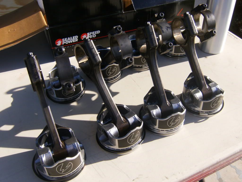

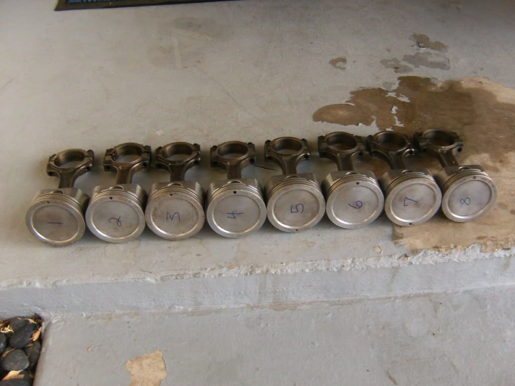

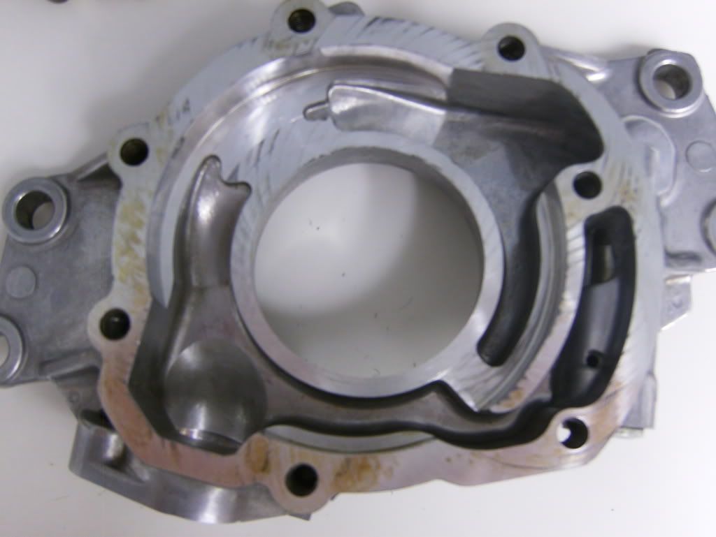

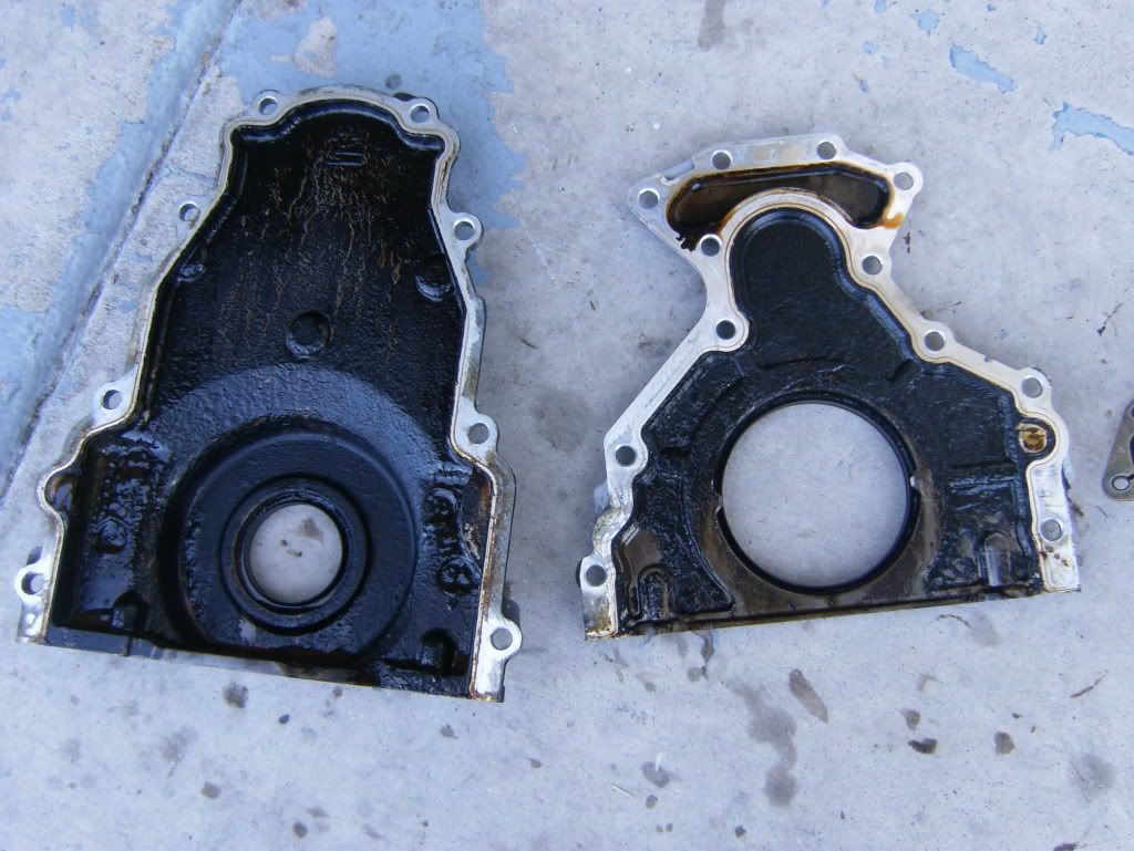

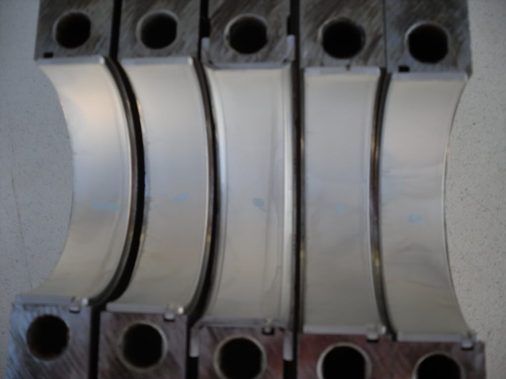

70TWO NOVA 04-06-2010 02:36 PM

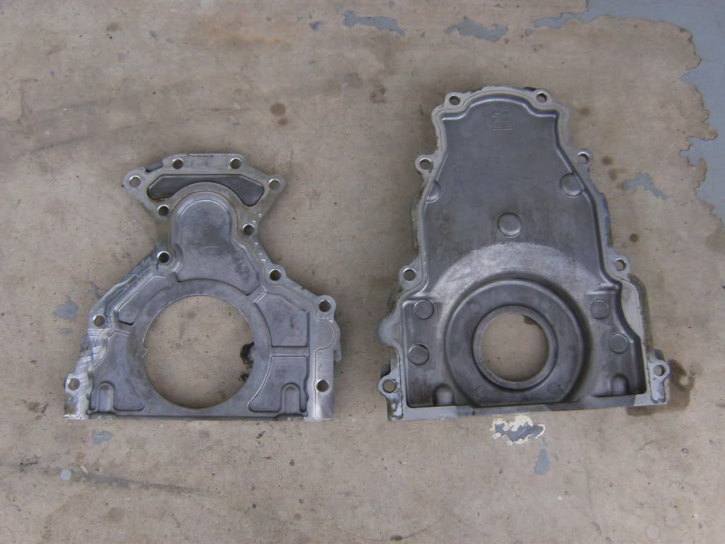

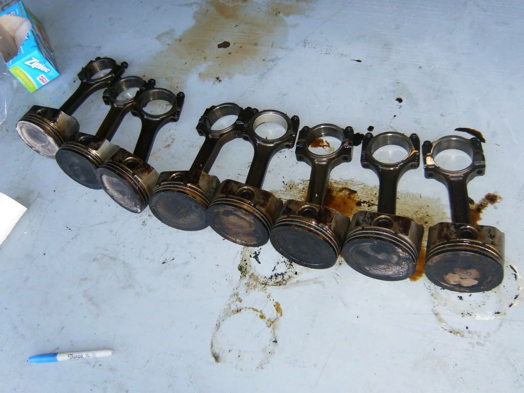

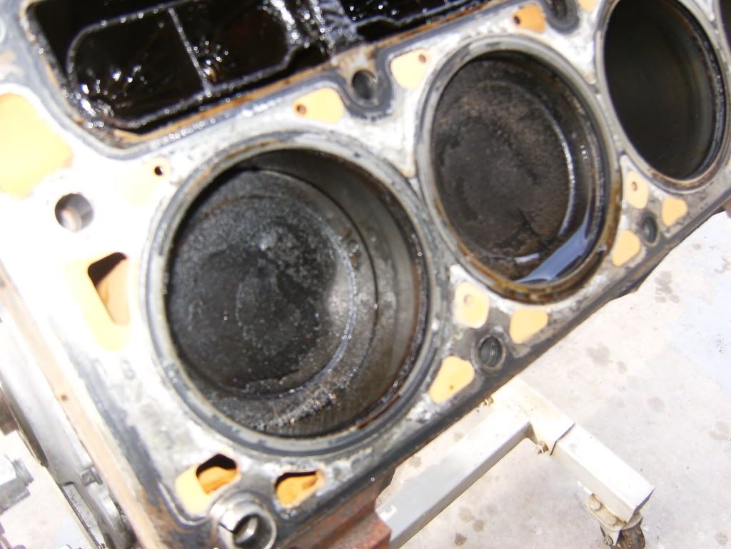

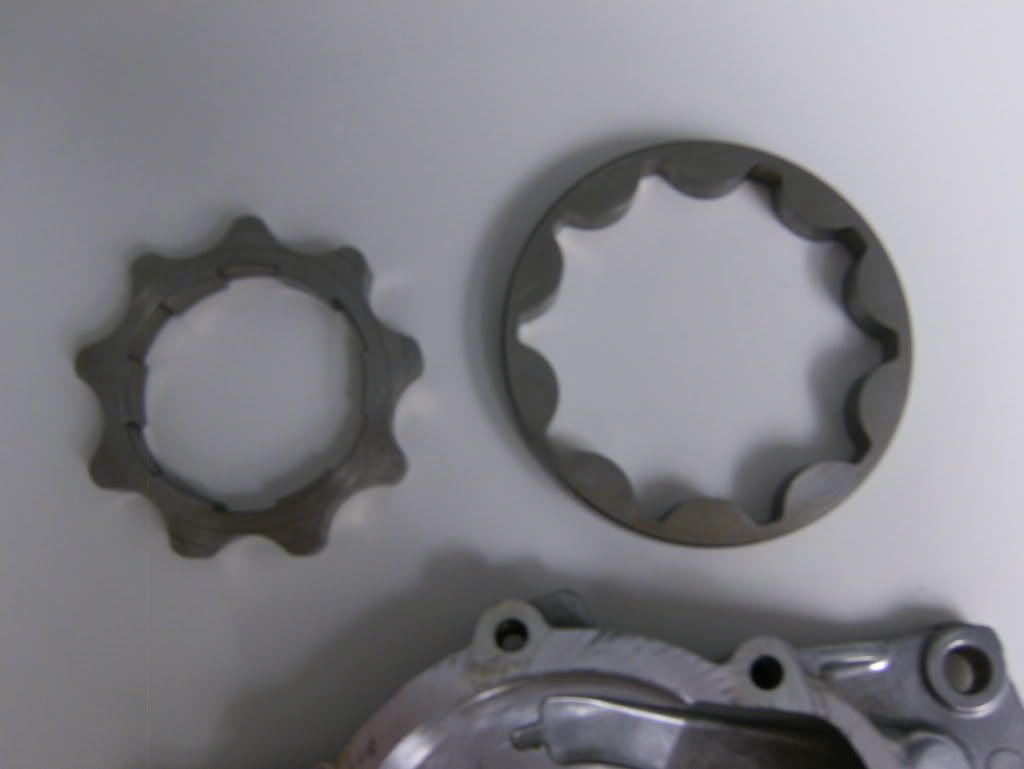

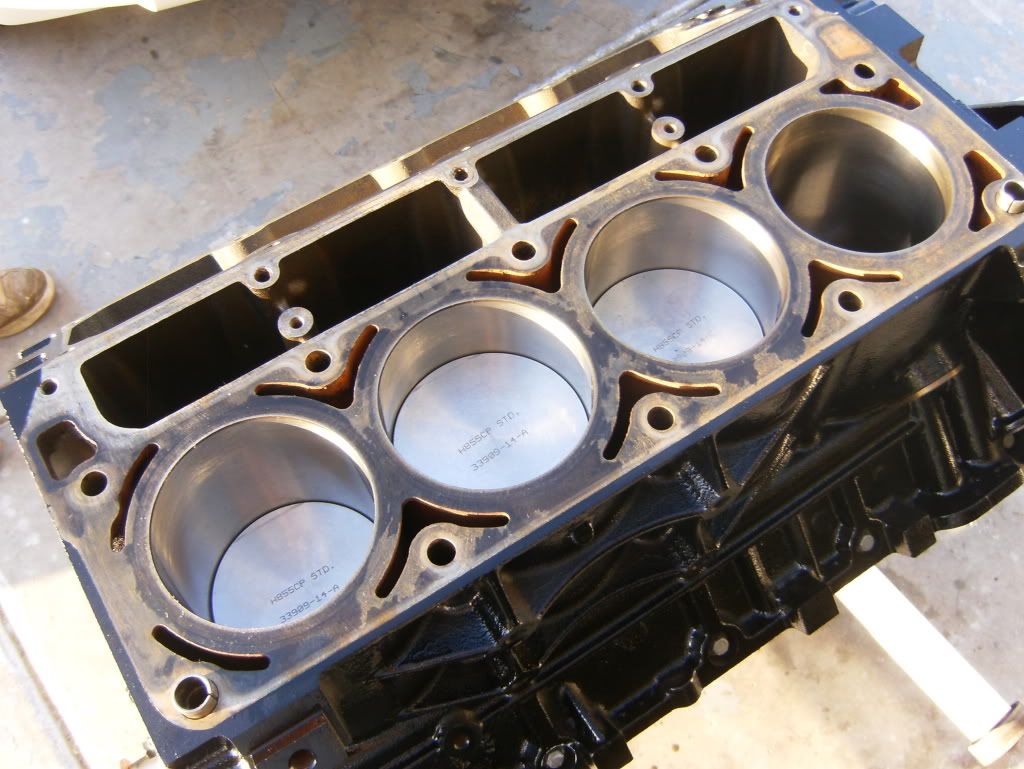

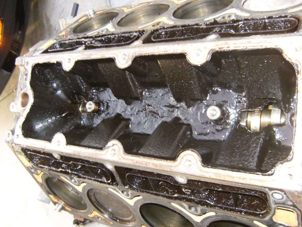

a little cleaning...
http://i270.photobucket.com/albums/j...ar31201010.jpg
http://i270.photobucket.com/albums/j.../Apr120104.jpg
http://i270.photobucket.com/albums/j.../Apr120103.jpg
http://i270.photobucket.com/albums/j.../Apr220102.jpg
http://i270.photobucket.com/albums/j...8/Apr22010.jpg
heads cleaned and milled .030
http://i270.photobucket.com/albums/j...Mar3120104.jpg

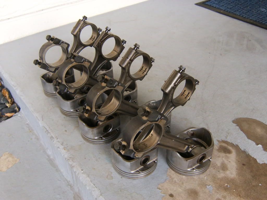

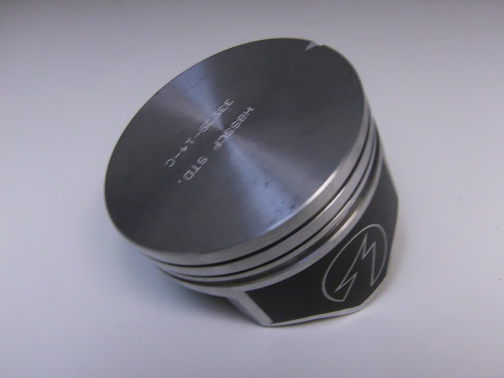

98ssnova 04-06-2010 02:41 PM
Looking good Brian the paint is sweet as always and should be a good engine when you are done. But please dont leave your pistons on the concrete no good can come of that:cheers:
70TWO NOVA 04-06-2010 02:43 PM
lol thanks man, ill be sure to pick them up before they get stepped on!
