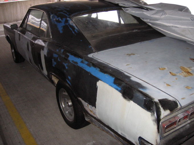

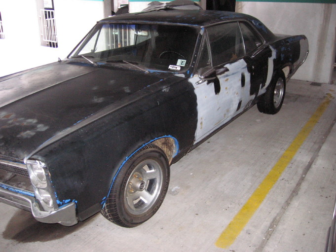

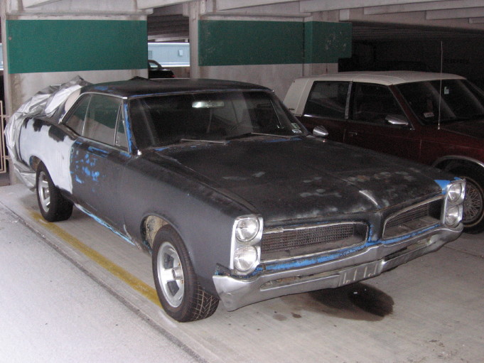

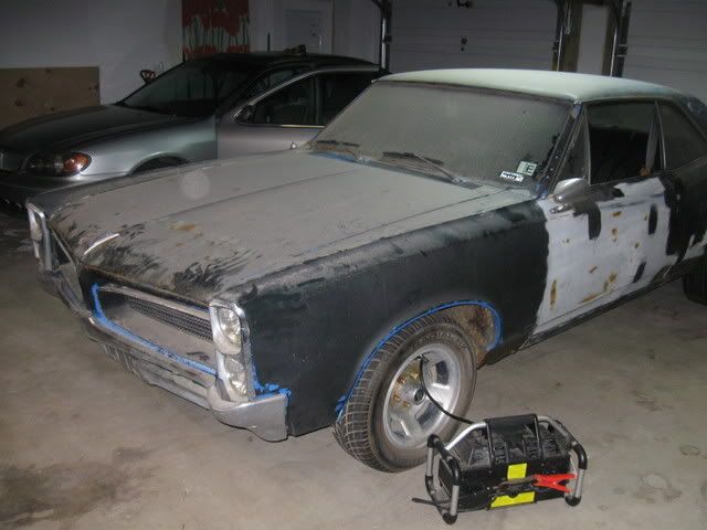

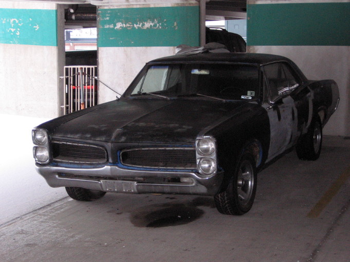

Here are some pics of my project car. It is a 1967 Lemans sport coupe (hardtop). Believe it or not the car was stolen. And was missing for about 18 months. It was recovered outside the thief's barn. Are you ready for this? He put in a new headliner in the car and threw a cheap paint job on it to disguise the car.
And you can see the paint peeling off. I don't have a garage so I work outside on it. The interior floor is solid. My wife painted the floor and trunk with POR-15 for me. If I can just teach her to change oil and do brakes I would sleep all day.
As you can see I have a lot of body work ahead of me. Which I plan to do myself! Wish me luck LOL! The engine work I will farm out to Chief Many Horses here in Massachusetts. They seem like a good bunch of guys to me. If anyone has any suggestion let me know.

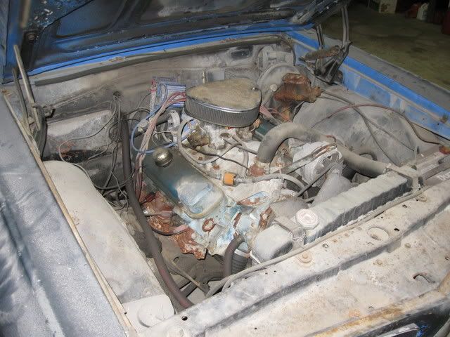

The old 400ci Ram Air IV cammed Pontiac V8 old and busted below.

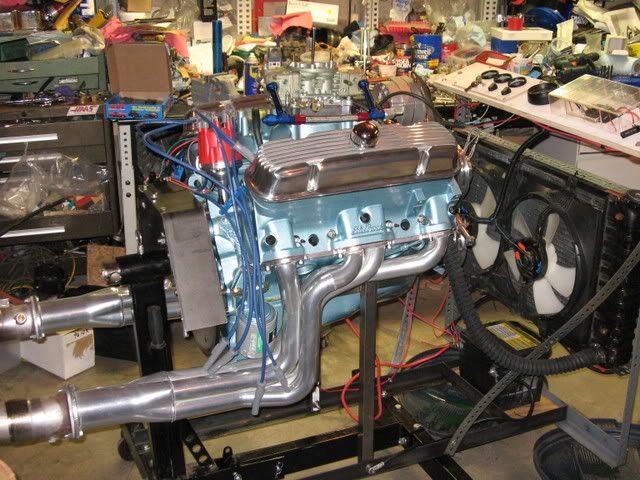

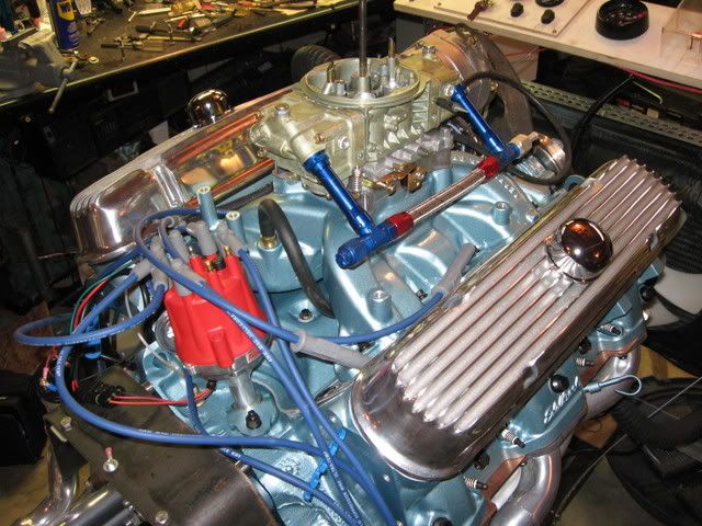

And now the new hotness below. A traditional 428ci Pontiac no LSX for me :D
[IMG]http://i632.photobucket.com/albums/u...Picture040.jpg[/IMG]
The body still looks like trash but that was unavoidable with limited budgeting. I did get the engine completed except for some Pontiac specific pulleys I need to source. I also to save cash took on the build with the help of a local buddy who is a talented machinist. He basicallly helped me through assembly so I would not hose anything thing up.
It's been 20 years since I built the first engine that still resides in the car. And I am proud that with the help of some friends and associates that at least the mechanical side is coming together. And with all the new tech advances I needed the schooling. Here are the specs:
Here's a few specs:
428 +.030 (434)
Wiseco custom flat tops
Zero Deck
Eagle 6.625 rods
10/10 crank
Race bearings
Melling MS54D pump
RPM intake.
72cc E-heads
.051" Cometic Head gaskets
Comp Custom Hyd "Extreme Street" lobes 248/254 @.050 .619/.639 lift w/ 1.65's
Crower Stainless 1.65 rockers
Mega brace
11.04:1 on pump gas
Ferra valves
Canton 15-452 road race pan, pickup, and windage diamond stripper
My custom built 1000 HP annular
MSD Drop-in & Blaster 2
[IMG]http://i632.photobucket.com/albums/u...Picture039.jpg[/IMG]
