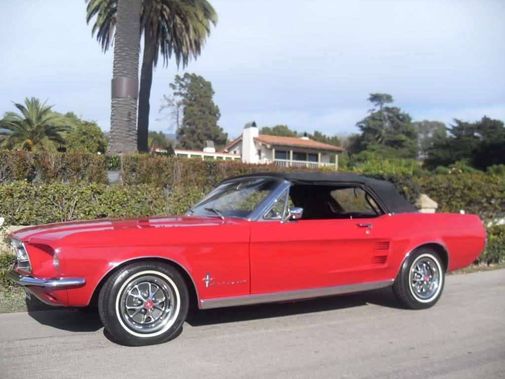

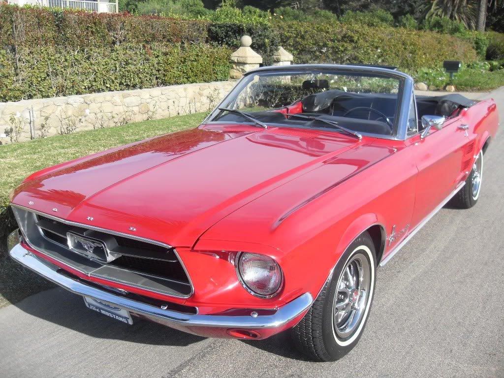

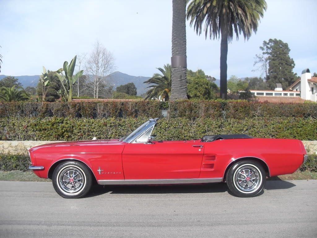

I had a very good customer of mine that was looking at buying this car. Look over the pics and let me know what you think. (NO WE HAD ABSOLUTLY NOTHING TO DO WITH THE BUILD OR BUY) I got the pics too late to say anything.
http://i269.photobucket.com/albums/j...S/SDC11391.jpg
http://i269.photobucket.com/albums/j...S/SDC11386.jpg
http://i269.photobucket.com/albums/j...S/SDC11384.jpg
http://i269.photobucket.com/albums/j...S/SDC11380.jpg
Seems like a nice car, price is great around $35,000 no way you could build it for that. Drives nice, underside looks nice, paint is very nice, can’t seem to find any rust or bondo problems, interior is perfect, everything works.
So he bought the car thinking man what a great deal and great buy. He looked at hundreds of pictures of the car and yes this car was a full rebuild. Everything new on it.
Look at the pictures and see just how nice the car really is.

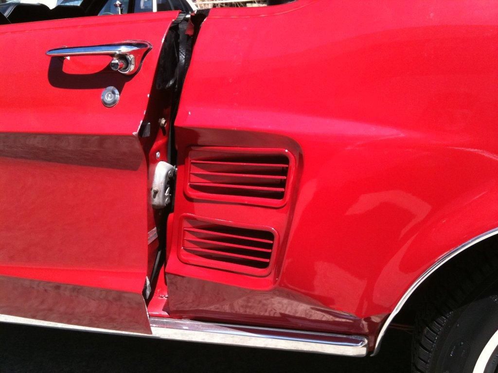

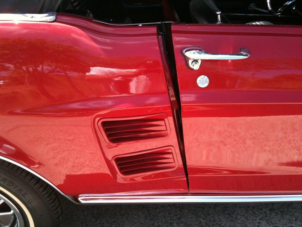

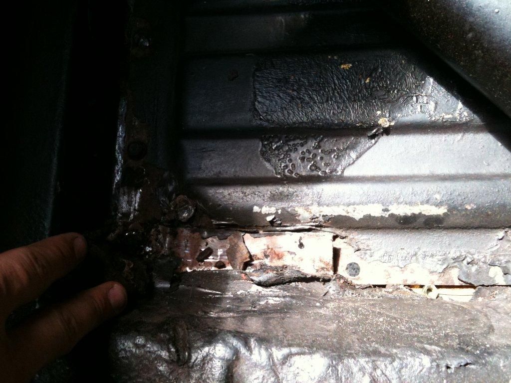

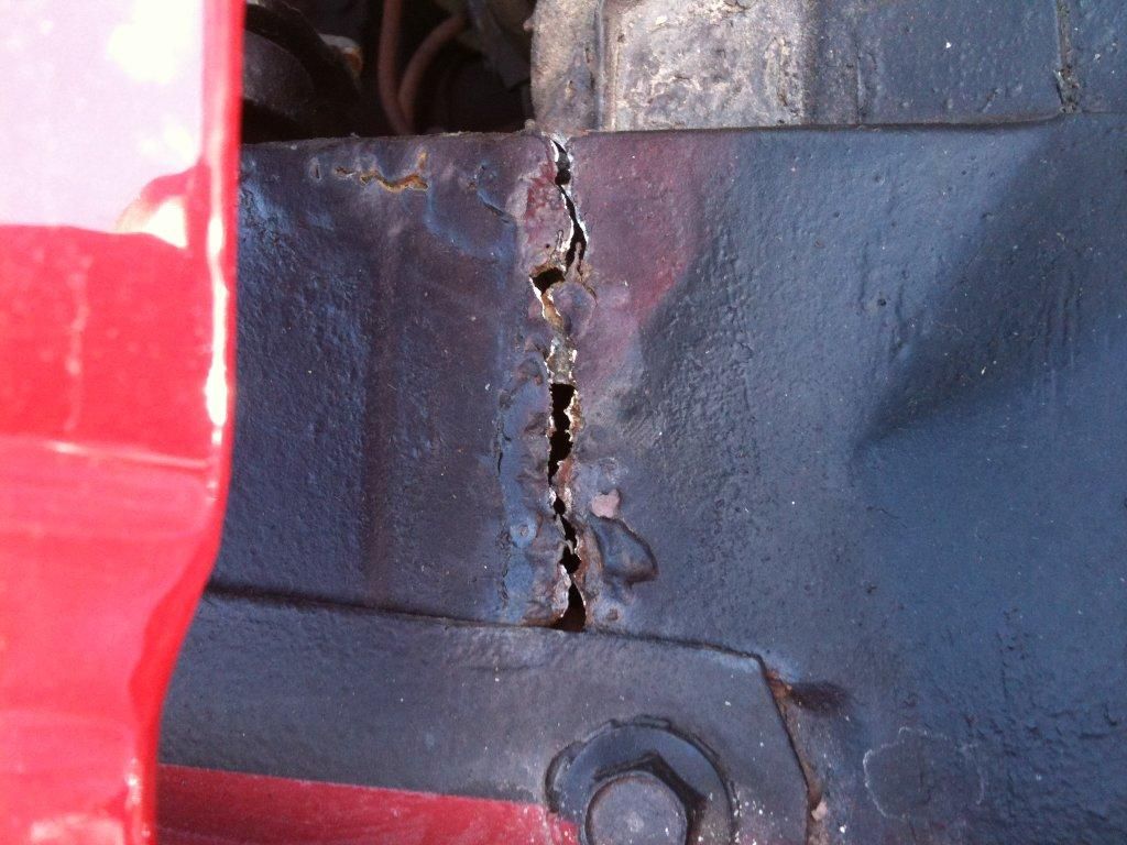

Now to the sad part of this story, this car looked really nice and drove really well but the scum bags of today have really figured out how to take advantage of everyone so OPEN your eyes and know what you are buying.
They put bondo over every part of rust but just thin enough that the bodo gauges had a rough time finding it. The complete underside of the car was coated and covered and looks completely factory. The work looked great and the average person would not be able to find this stuff.
There are people out there that will spend a ton of time thinking up ways that they can take advantage of someone buy cutting every corner of a build to make more money. Hours are hours when it comes to building a car and if you are going to be serious about this in any way it’s time to stand up and put these people out of business.
http://i269.photobucket.com/albums/j...S/IMG_0471.jpg
http://i269.photobucket.com/albums/j...S/IMG_0470.jpg
http://i269.photobucket.com/albums/j...S/IMG_0473.jpg
Yes the car broke into two parts all the way accorss
http://i269.photobucket.com/albums/j...S/IMG_0469.jpg
http://i269.photobucket.com/albums/j...S/IMG_0468.jpg
