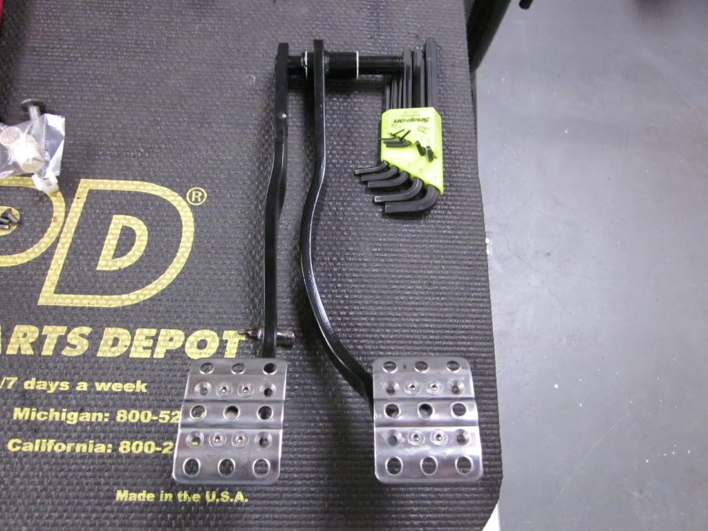

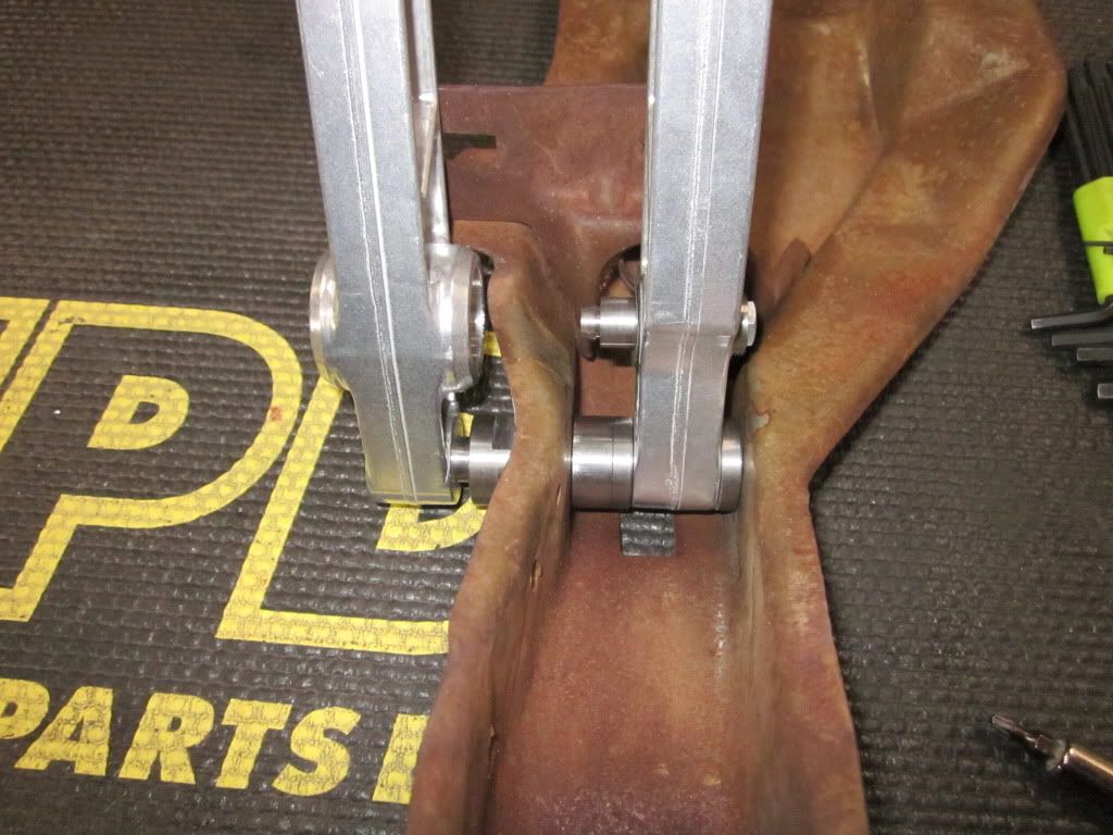

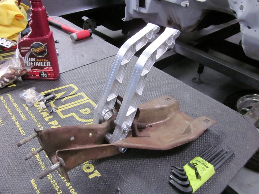

I have been working on pedal assemblies for a 69 & 70's here @ the shop. The 69 pedals are reproductions from Classic Headquarters that we cut off the the pads & machined some bases that were welded so that we can mount adjustable pads. The pads are stamped stainless pcs. The pedals for the 70 are forged pedals that Wilwood will have in production soon. We machined pins & hardware so that they will be a direct replacement on the stock base. JCG will have these here pretty soon to sell :D

Payton King 04-27-2010 01:07 PM
They look nice
I see where the 70 pedals have a provision for a balance bar for twin masters.
Cris@JCG 04-27-2010 01:16 PM
We are not going to do a balance bar.. We just used the balance bar pedal to get a view for how pedals will look on base..
