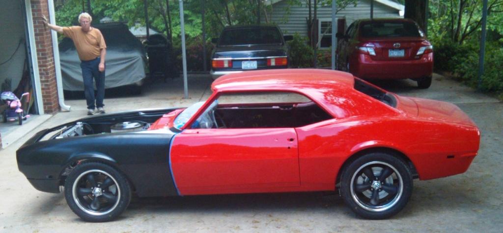

3 Attachment(s)
I dunno if these are what you consider cheaper sheet metal front fenders, but they are made by golden legion.
The fenders out of the box, some stamping score marks on the passenger fender along the hood bend. But other than that, no dents/dimples. It took 4 big shims up top and 3 below and one on the firewall and a little one in the door jamb for us to get it lined up with the door/rocker.
The driver side had no dents or scoring marks but 11 dimples that I will need to ping out. The fender fit tighter than the passenger but ended up requiring basicly the same shims as the passenger side did to get the body lines correct.
/shrug
The header and lower valance (pre modifications) are AMD, much nice stamped parts and a bit thicker it seems.
All in all the sheet metal is fine in my opninon, you have to skim/work old ones or NOS also so no big deal imo.
