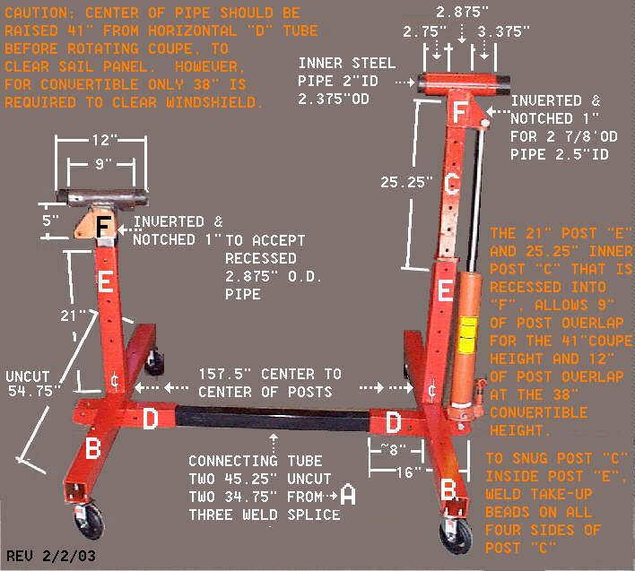

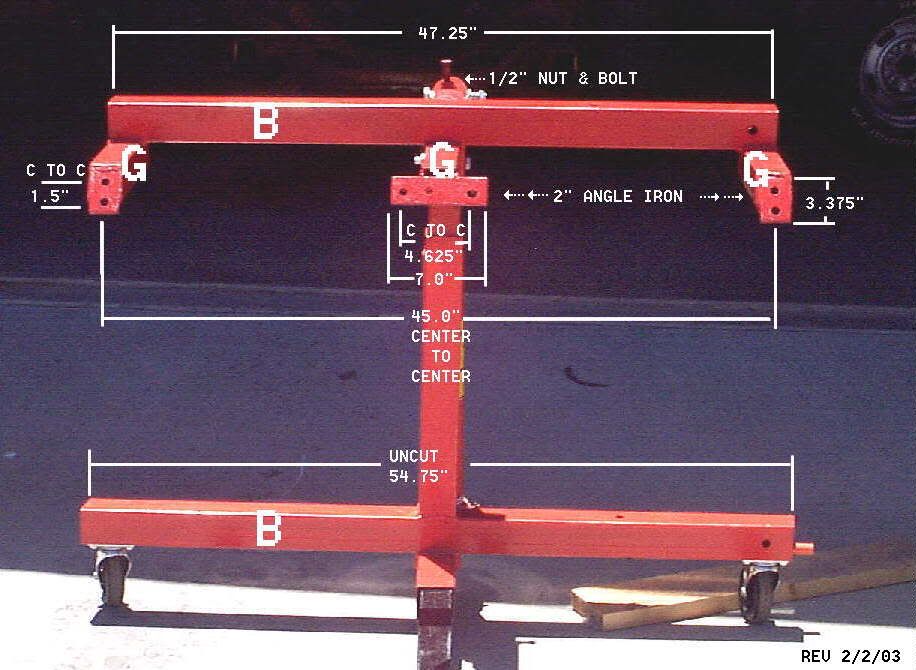

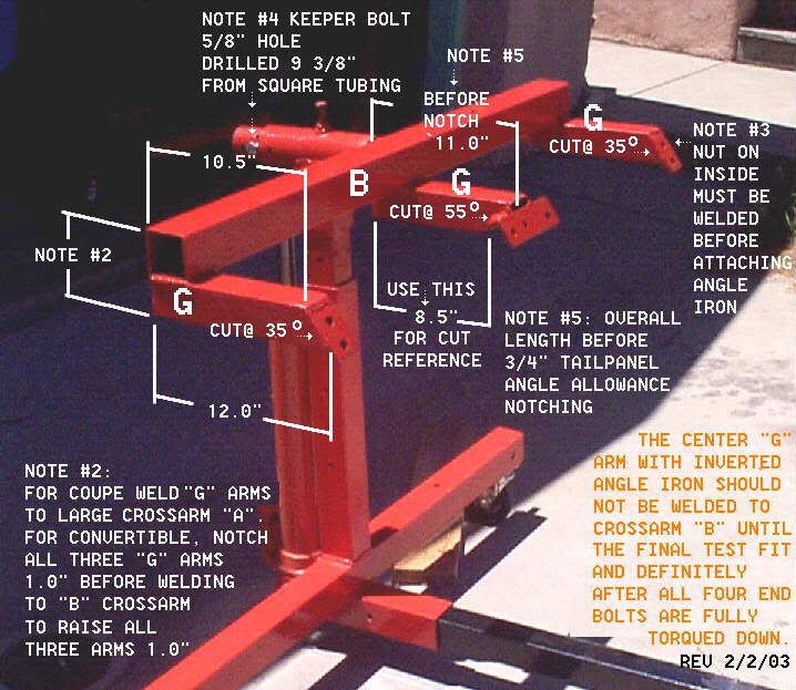

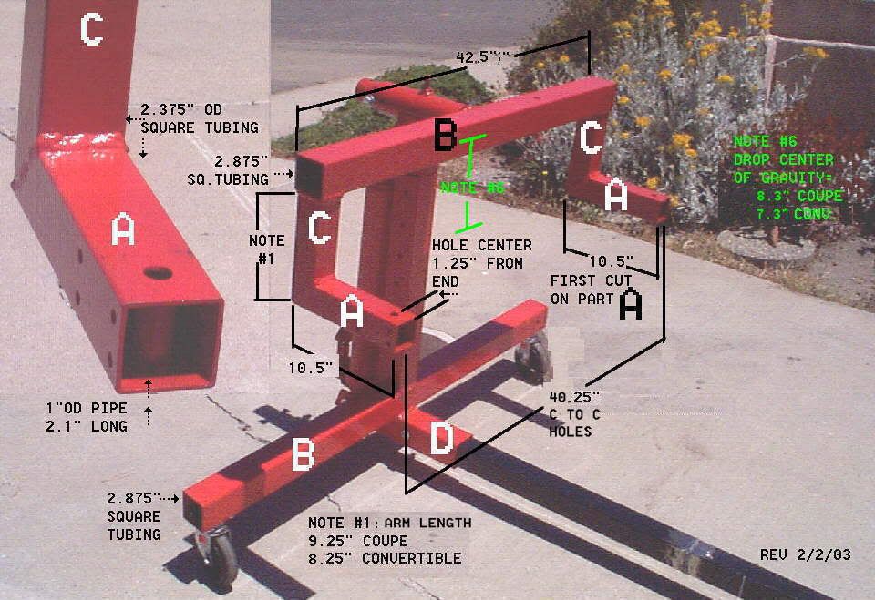

prostreet69cama 05-25-2010 11:37 AM
Rotessiere
Here is a set of drawings I used when I built mine.
http://i268.photobucket.com/albums/j...Rotissere1.jpg
http://i268.photobucket.com/albums/j...rontfront1.jpg
http://i268.photobucket.com/albums/j...rearframe1.jpg
http://i268.photobucket.com/albums/j...rearframe2.jpg
dhutton 05-25-2010 12:52 PM
Originally Posted by astross89 (Post 286948)
http://www.autobody101.com/rotisserie_plans.pdf
Found this. Thought it was good for the budget do it you selfers.
That is the one I built. I found that the center post was not tall enough for my A body so add about 6 inches to the height if you are going to use it for a large car. Other than that it is built like a tank if you use the material he specifies.
Don
