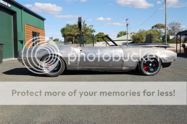

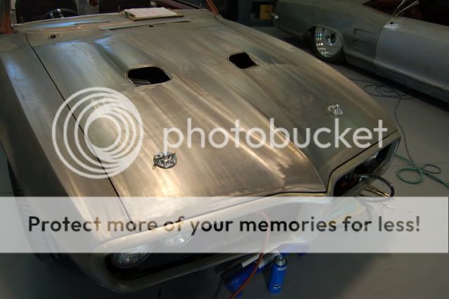

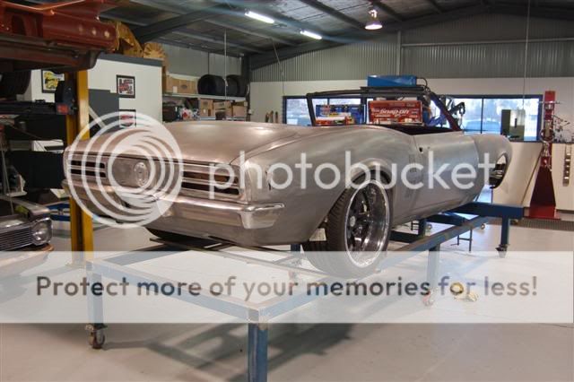

Hmmm,I dont see whats so ugly about the stock bumper when its cut and shut and pulled in.Same goes for the front.
Shane.
http://i492.photobucket.com/albums/r...Picture021.jpg
http://i492.photobucket.com/albums/r...re024Small.jpg
http://i492.photobucket.com/albums/r...Picture025.jpg
http://i492.photobucket.com/albums/r...t/DSC_4565.jpg

Nice work for sure...if you're staying all-Pontiac that's the ticket.
If it were my car,I'd be fabbing the thinner,much more eye-pleasing Camaro bumper in back.:yes:
