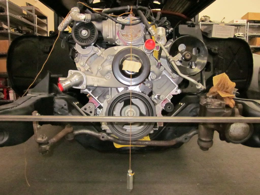

Kenny- Currently working on setting up a 2nd gen with factory sub-frame to a L99 with factory drive.. It is a challenge but looking @ how I going to make it work... Listed is what I have discovered in our research..
Factory motor & trans sits 1 inch towards pass side measured from centerline of chassis
L99 drive sits alternator in lower position from LS1
L99 drive sits about 1 inch further away from block(like a truck drive)
LS1 oil pan gives the best clearence on sub-frame
Machining & fabricating our own Altnator & A/C brackets with motor mounts with trans support
Here is where we are @ this time..
http://i1015.photobucket.com/albums/...n/IMG_0082.jpg

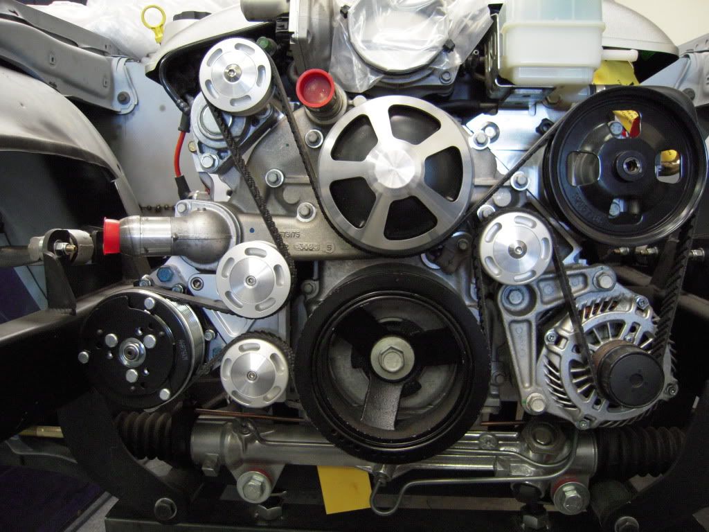

Here is a LS2 drive system that we made our own A/C brackets & dress up pulleys..
http://i1015.photobucket.com/albums/...irebird062.jpg
