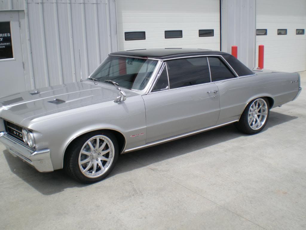

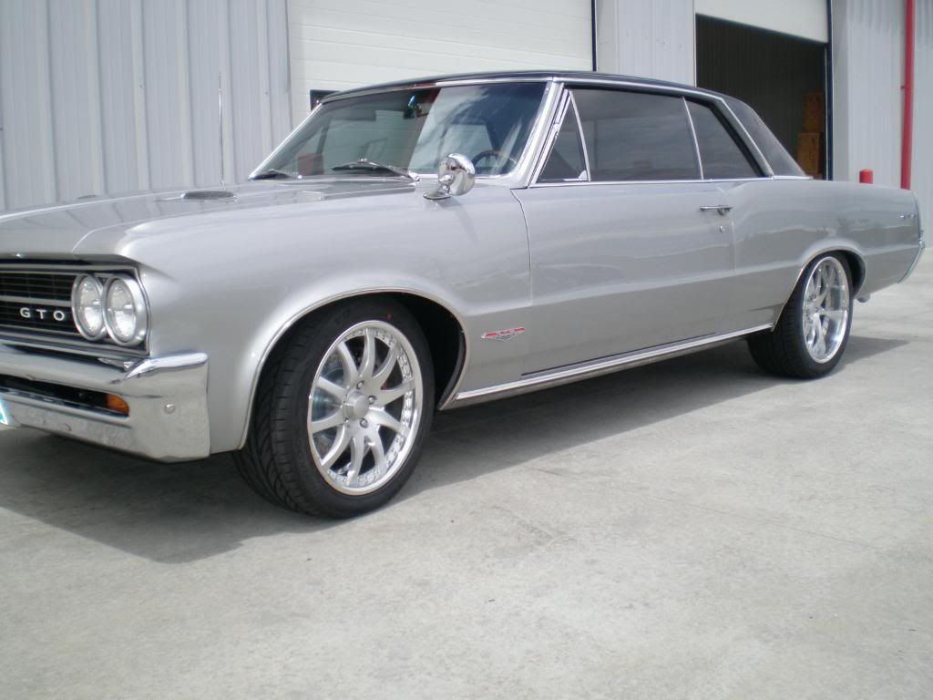

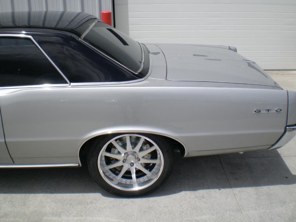

64 GTO running Rushforths
Here is a set of 18 and 19" Rated-Xes we just put on a 64 GTO with a full Hotchkis suspension and Baer Brakes. 18x8s up front and this little goat actually holds 19x10s on the back!

Looks great!!!! What kind of backspacing are you using? Also any issues with tire rub? or turning? Did you have to tub the rear or modify the rear wheel wells?
Thanks, Chris
JayR 06-10-2010 08:19 AM
Thanks Everyone! Glad you dig the car!
The fronts are 5.625" backspace and 6.0 in back with stock axle width and wheelwells. No issues!
