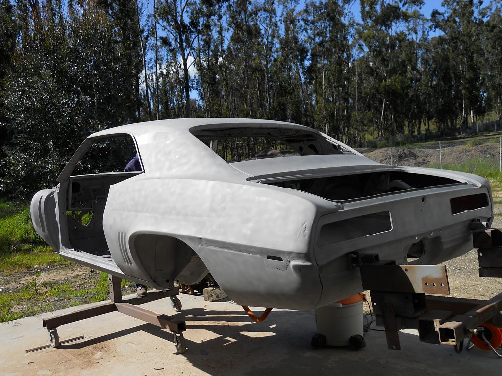

I recently had my '69 Camaro media blasted on a rotisserie. After blowing out and vacuuming all of the leftover media, we d.a.'d all of the exterior surfaces and picked up some DuPont 5717s metal conditioner (blue liquid) and red scotch brite pads. We followed the instructions, which called for diluting the blue liquid with water, working it into the metal with the scotch brite pads, and then 'rinsing thoroughly'.

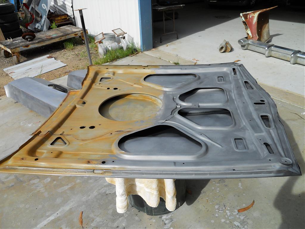

Well, before we even got to the rinsing stage, the metal was turning a rusty, brown color. We tried scrubbing and immediately wiping it down with a damp towel, but it didn't help. Eventually, the whole car inside and out was scrubbed with the blue liquid and then hosed down. We used the air compressor to blow out all the seams we could see/reach. Looking back, we probably shouldn't have broken out the hose, as I'm sure the water got to places it shouldn't have.
With the whole car in a rusty, brown mess, we went at it again a week later with the 5717s, but we didn't dilute it the second time, and we didn't use a hose to rinse it off....just a damp towel. Everything came out better...no rusty color, just shiny metal with an iridescent look to it.
Now I'm afraid about the pinch welds, nooks and crannies, and overlapped segments on the fenders, doors, etc. What if the water got in there and starts to cause rust? I guess the next step would be to get some etch primer, but I want to make sure the foundation is good first and not trap the rust in under the etch primer.

I doubt a little bit of water in the pinch welds just one time is going to cause major rust issues. I would just shoot it with a good quality epoxy primer and move on.

I'm pretty sure all of the metal prep sprays leave a yellow/light brown residue that can be mistaken for rust....but its really the solution doing its job. They usually leave a phosphate residue whihc is kinda yellow....
Check with the company that makes the metal prep spray you used.
