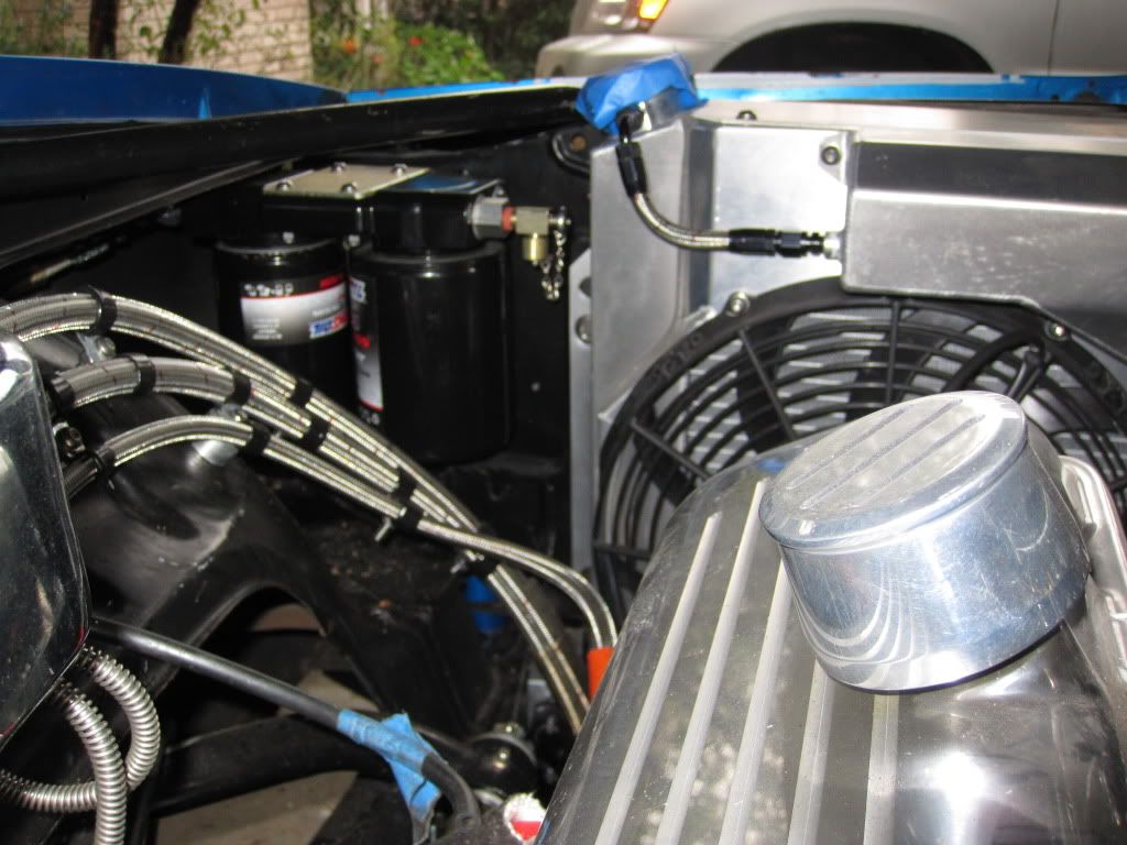

BBC69Camaro 06-20-2010 11:27 PM
-10s that's whats on the block:
http://i328.photobucket.com/albums/l...oseRouting.jpg
Routed the lines behind the inner fender. Amsoil's remote bypass kit.

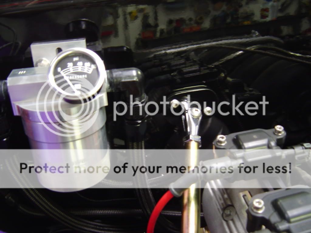

xtremelky 06-26-2010 02:26 PM
I used the Pure Power setup on my Elky. Is a really nice filter setup and nothing get's past it.
Mike Holleman
http://i518.photobucket.com/albums/u...intprep041.jpg
