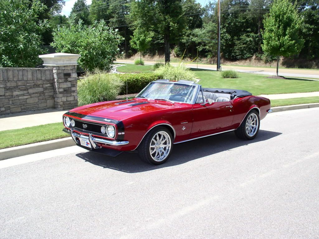

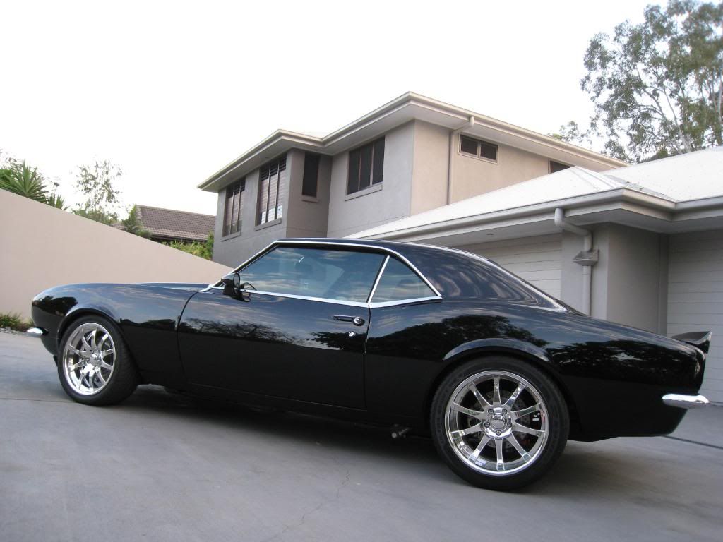

Whether it's stock height or on Air Ride, it will safely hold 8s up front and 9s in back.
http://i256.photobucket.com/albums/h...cture026-1.jpg
http://i256.photobucket.com/albums/h...P1010165-1.jpg

I will be doing DSE tubs in the rear and plan to run as big as i can get and still clear. is that an 18x8 or 17x8?

JayR 06-28-2010 02:03 PM
Those are 18x8s on both cars I posted and Justin has you covered on your other questions.
