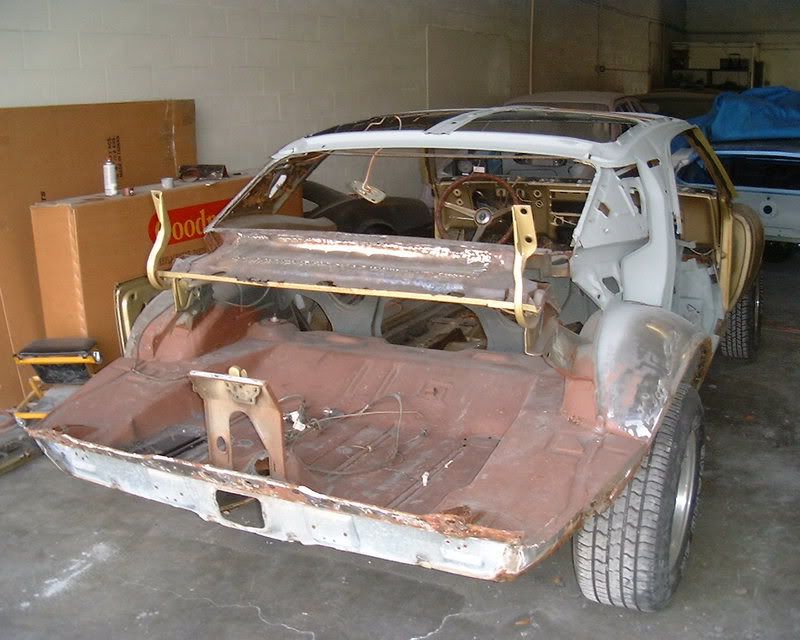

GPR 09-04-2010 04:31 AM
We did a 67 with Goodmark and the fit was good.
http://img.photobucket.com/albums/v3...0Camaro/07.jpg
http://img.photobucket.com/albums/v3...0Camaro/18.jpg
http://img.photobucket.com/albums/v3...0Camaro/20.jpg
http://img.photobucket.com/albums/v3...0Camaro/23.jpg
