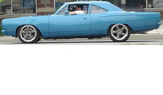

nazar 12-21-2005 09:47 AM
this is the look its going for(same wheels, different color)
http://i21.photobucket.com/albums/b2.../choppedrr.jpg
Car is gonna be either black, or silver with those wheels but in black/polished lip
