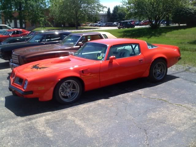

Well I picked up my TA from Brent Jarvis at Performance Restorations. I had a complete Heidt's front subframe and rear 4 link. I had 12.19" 6 piston Wilwood front and 12.19" 4 piston rear Wilwoods.The tires are Nitto 555 245/40/18 front and 285/40/18 rear,. The rims are Rushforth forged Live Wires. 18x8 4.75 bs and 18x10 5.75 bs. Car handles better and rides like a newer 4th Gen. What a difference between the rack and pinion and coil overs. Lost another 220 pounds. When I first bought the TA it weighed 4200 lbs. I am now down to 3600 and I have a full interior and all steel body.
http://i741.photobucket.com/albums/x...20Am/photo.jpg

Looks fantastic!:bow: I can't believe it weighed that much in the beginning. How long did it take them to do the conversion?
