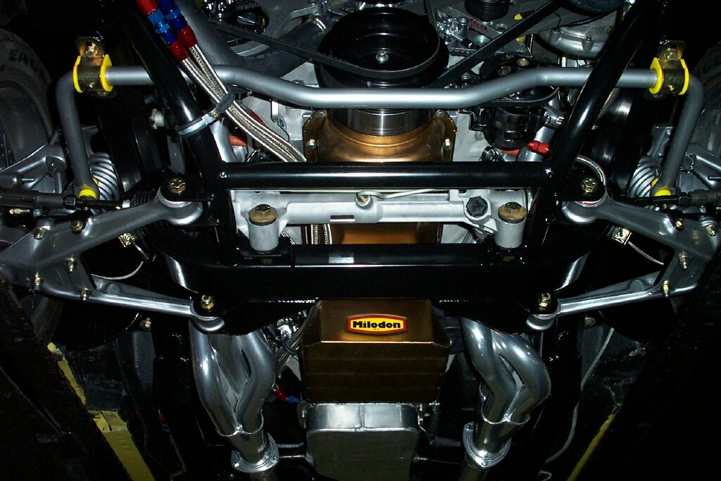

camcojb 07-16-2010 04:30 PM
I think that's a stock First Gen bar on this one............
http://www.camcojb.com/alumin8r/zl1chassis3.jpg
Joejaze 07-17-2010 06:03 AM
Nice! Thanks Jody!
It looks like there is a bracket made up for the end links that fits into the lower control arm. Thats the only thing I will need to figure out.
