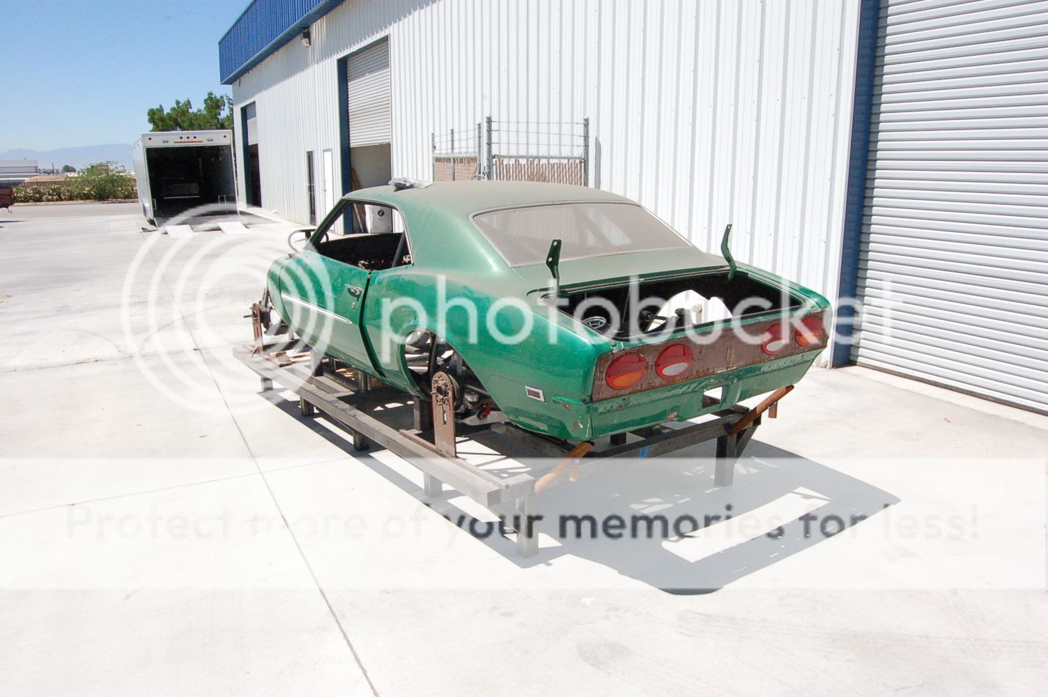

Well Sir you are correct, but if you look at definition #2 you will find it corresponds to this picture of these tail lights.
HACK -
http://i616.photobucket.com/albums/t...une2010018.jpg
And on that very note we will start back on your car right this very second....:D
What now???? You want more..... Pick on someone your own size....:D :D
Teetoe_Jones 07-27-2010 01:52 PM
Don't you touch that tail panel. If you do it will leave a scar. I just can't wait until you mount my HRE wheels to that chassis table- you know. Because my car has been welded to it for 2 years. I just figured it was part of the chassis at this point. Is that roll up door where you keep your Lear jet?

Lear JETs..... Plural.
At least the weight of the chassis table is low. The funny thing is it is probably lighter with the table welded to it, then when the car came in as a roller.....HEHE
