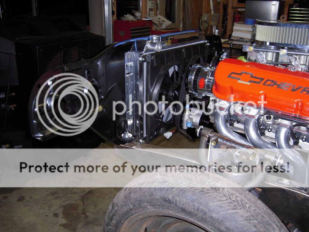

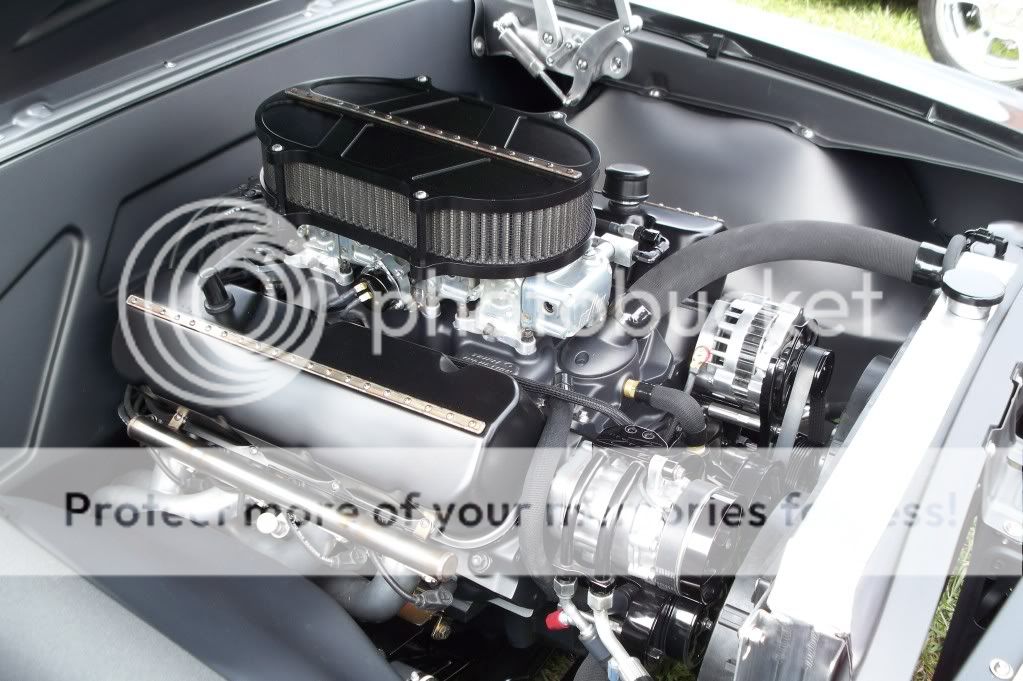

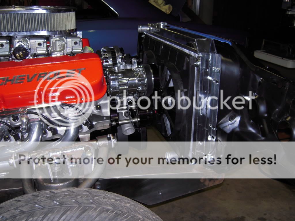

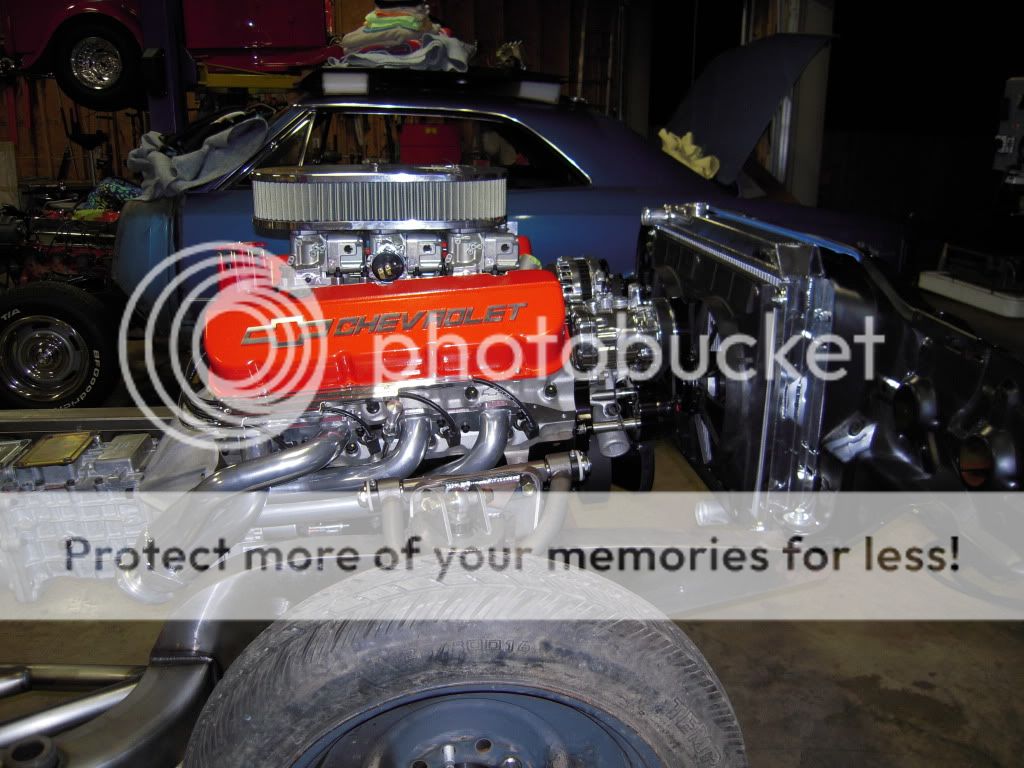

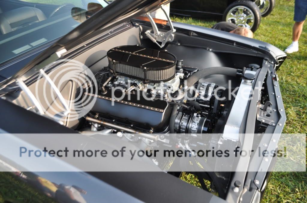

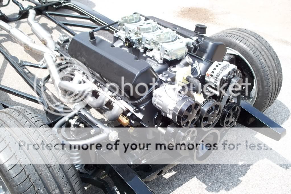

GoolsbyCustoms 08-10-2010 09:09 AM
Here is what I have on my computer sorry there isnt any better of the actual clearance but the customer has the car now and this is what I have... if you zoom in on a couple of them you can see its close but we have never had them touch and this car has been flogged on hard... as far as cooling it stays at 200 and never moves... we long hauled this car on the power tour ( and even won the Sema Power Tour Challenge .. sorry shameless plug) and never had a heat problem ... I know everyone says it but its true 100 degrees with the air on and in dead stop traffic !!!!! ha ha

LILBuzzy 08-10-2010 04:02 PM

thanks for the pics. it is close. is the motor in the stock location on that roadster shop chassis? it looks to be. we are in decatur near huntsville.
richie
ProdigyCustoms 08-10-2010 04:34 PM
Fairly certain that motor is moved back.
