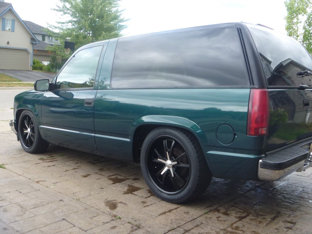

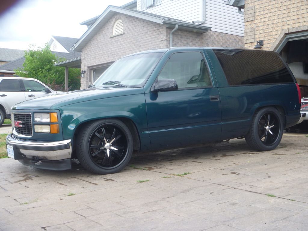

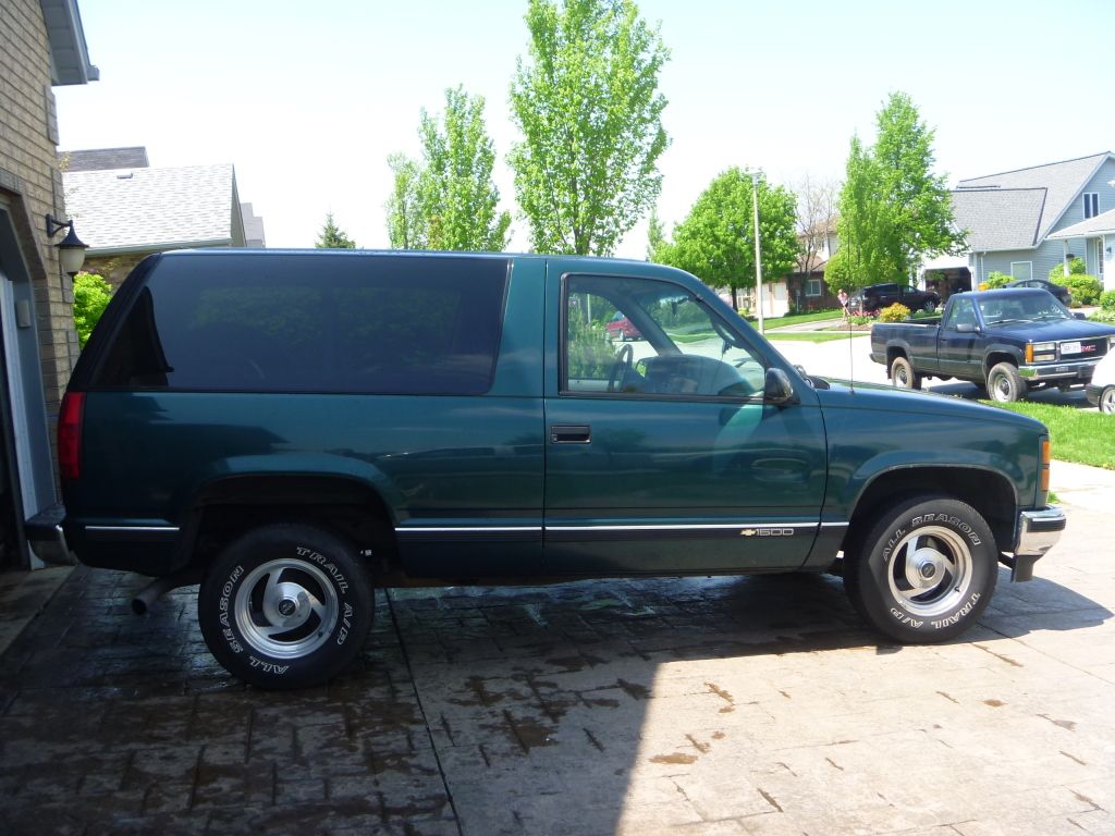

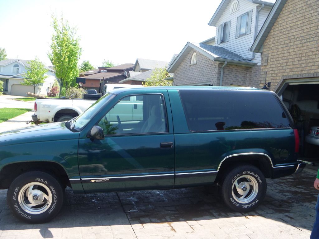

heres my 2dr did a 5 /6 drop its a 96 but did a complete 99 dash and interior swap , was a base truck now fully loaded still orig, paint. Pics of when I bought it . and now

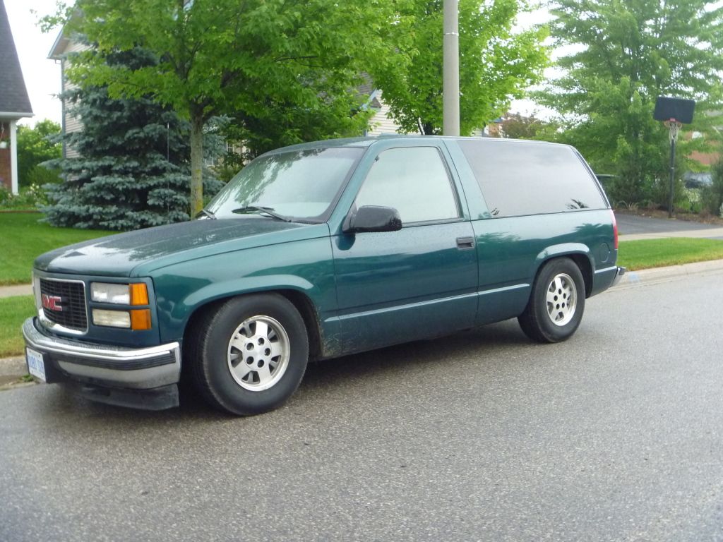

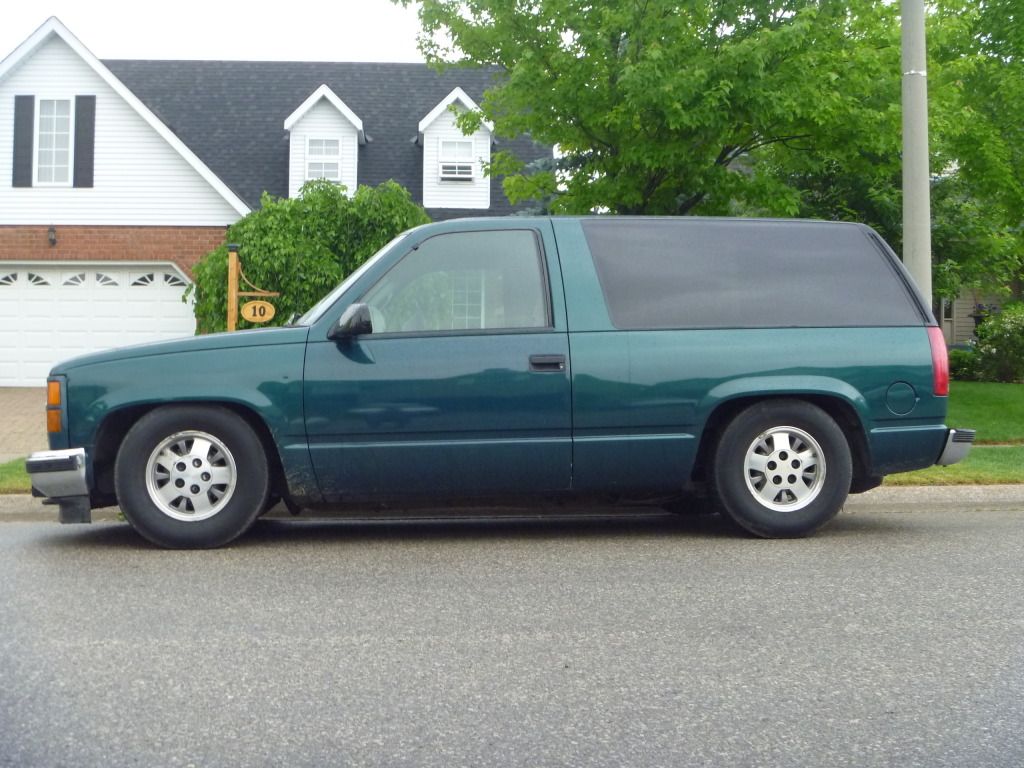

Heres mine, I just put my spindles on and aired out the helpers to make it level.

front dropped spindles and cut coils , rear flip, notch and shackels only thing I bought was the dropped spindles ,
xvette 09-08-2012 05:14 PM
20x 8 with 5 in back space
