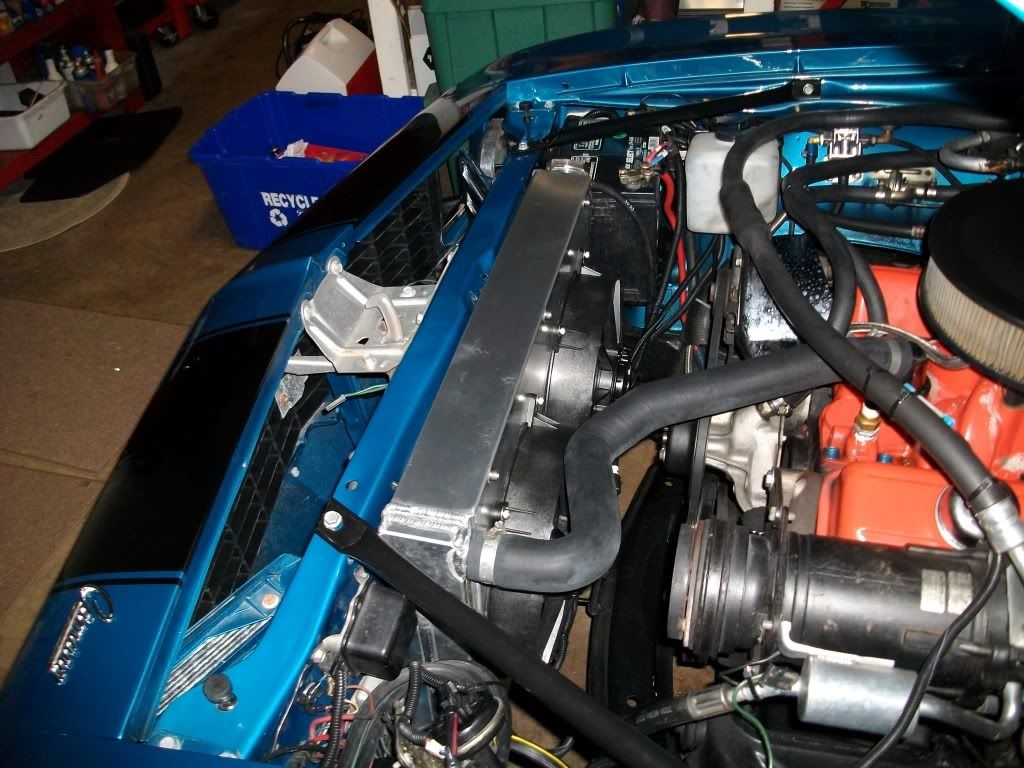

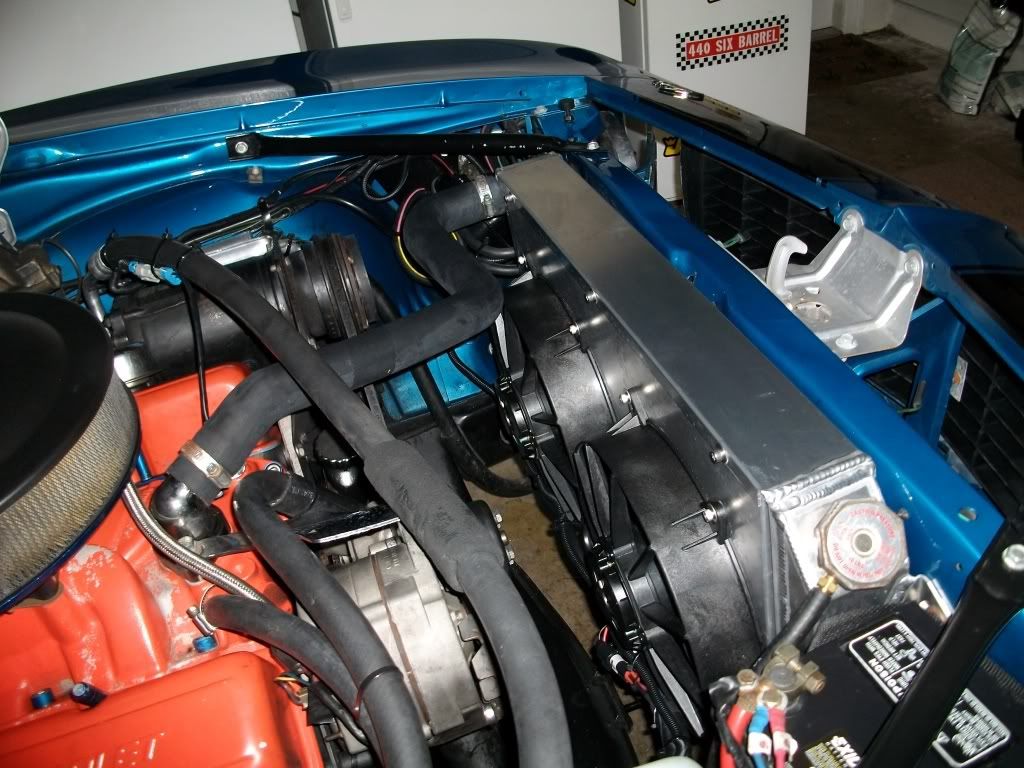

pavell 10-02-2010 11:50 PM
hey, since flash68 requested some pictures here you go.
this new setup cools great; no overheating issues at all. its a huge aluminum radiator. it looks good too!
it used the factory holes; although i did have to redrill the bottom driver side hole (i think maybe because my radiator support is a repro).
i also had to buy a "swivel" radiator neck, because the temparature sensor was in the way of stock water neck. I used a 72' camaro big block hose and it seemed to fit fine!
http://i842.photobucket.com/albums/z...SANY0068-1.jpg
http://i842.photobucket.com/albums/z...t/SANY0070.jpg
Flash68 10-03-2010 10:05 AM
Looks very nice! Thanks for posting pics. That is a bulky looking piece.
