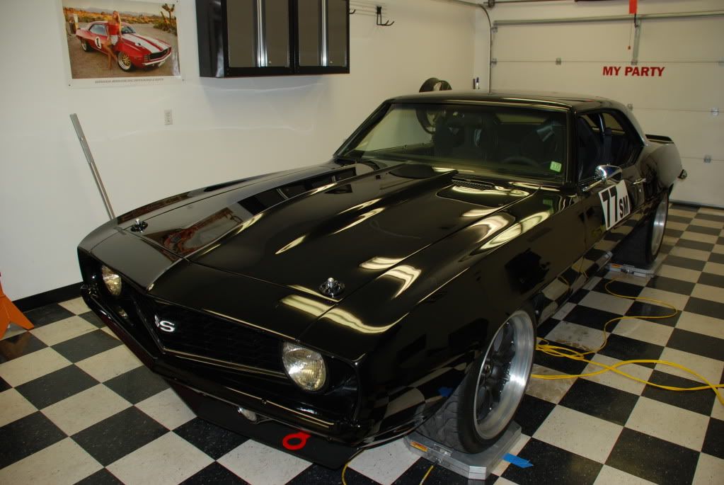

I've always wanted to get my car on the scales. I agreed to show my car two night for the SCCA. I got paid back with a member lending me his Longacre scales. Not a bad deal. :thumbsup:
The first thing I did was measure the track width and length so I could find the best spots on my garage floor. Once I did that I then placed the scales and oriented the scales so they set as level as possible. I then headed to the gas station and topped off the car. I always race as close to a full tank as possible. I took all the loose belongings out of the car to simulate race trim. Next, I took the shocks down to 0 compression setting. I jounced the car on both ends and made sure it simulated my normal ride height.

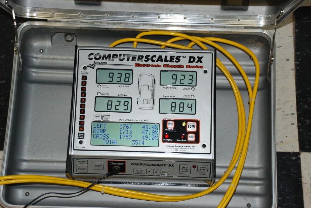

She's not super model skinny at 3574 lbs. :rofl: Keep in mind that's full of gas, AC, dynamat, heat wave pro, sub box, accumulator, etc. I was pleasantly surprised with the results with a big block. 52/48 with a cross weight of 49%. The biggest discrepancy is 55 extra pounds on the RR from the LR. At least half must be the battery. When I built the car, I tried to keep the weight fairly similar side to side with components. I'm not expert, but the RR isn't a bad place to have a little to much weight.

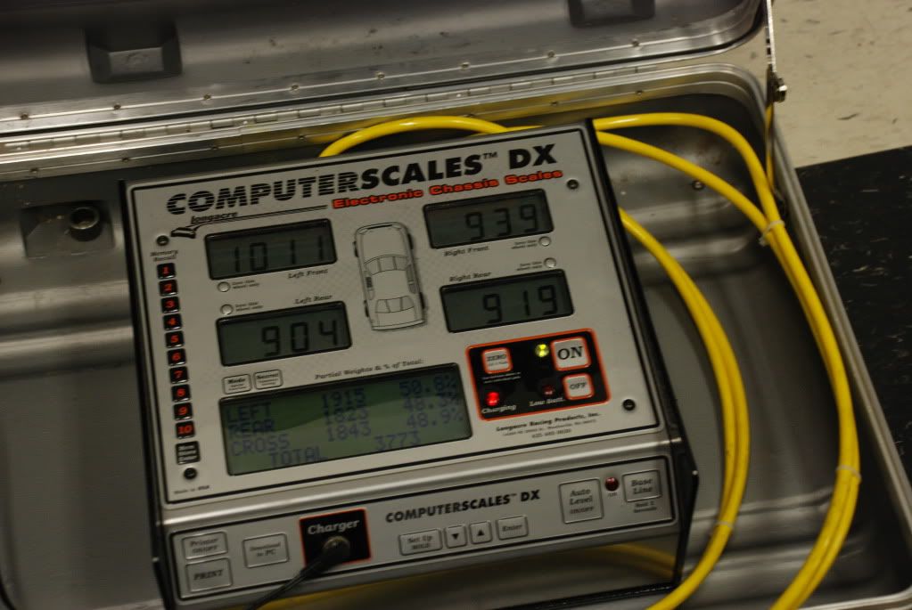

Since I clearly don't race with a remote contol in the pits, I got my fat ass in the car next. It pegged me at 199lbs. I guess I've been drinking a few to many beers lately and spending a little to much time using my new gym at the house. :D Anyway, the balance actually improved with a little extra rear weight. The LF did get a little heavy with an extra 72 lbs vs. the RF. The rear looks great.

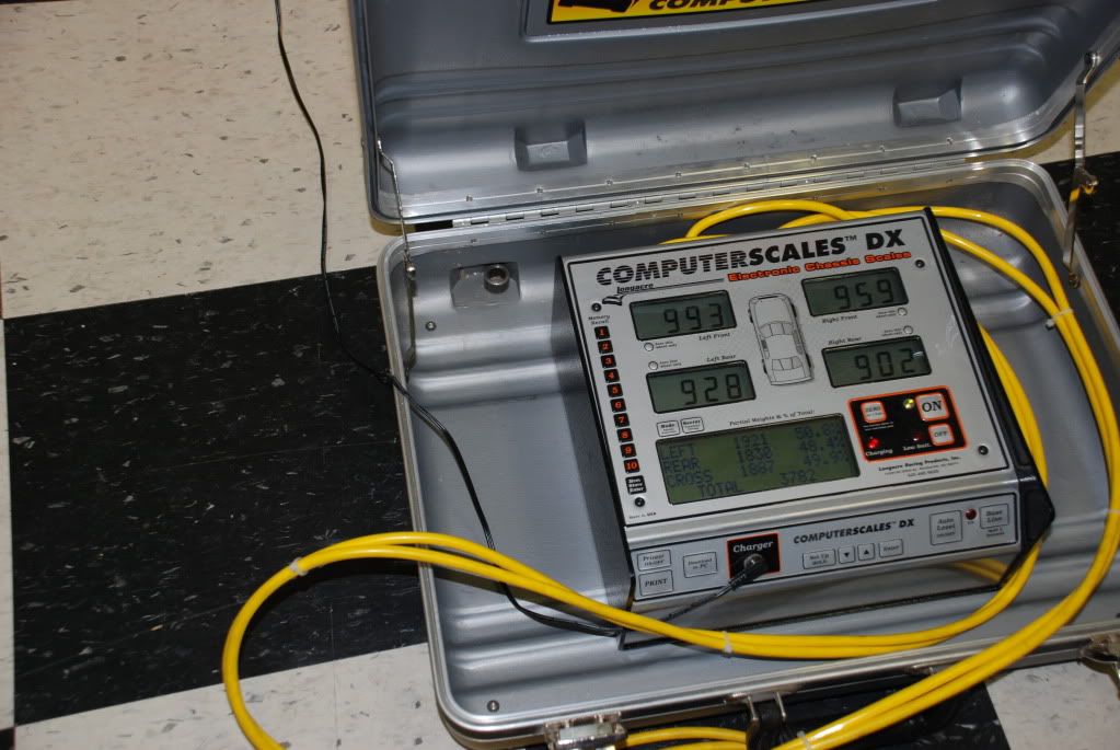

When it's nice, Kelli comes with me and rides shotgun. I get a ton of ride alongs as well. She'll never disclose what she weighs so I tricked her into it. :unibrow: Seriously, the car really looks good on the scales with her in the car. In her defense, I think the scales are about 4-5 lbs off. I tested them before I started and it had me at 195.

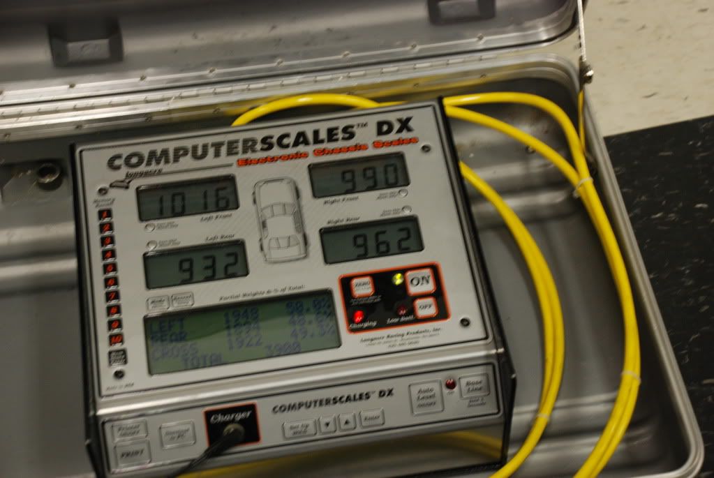

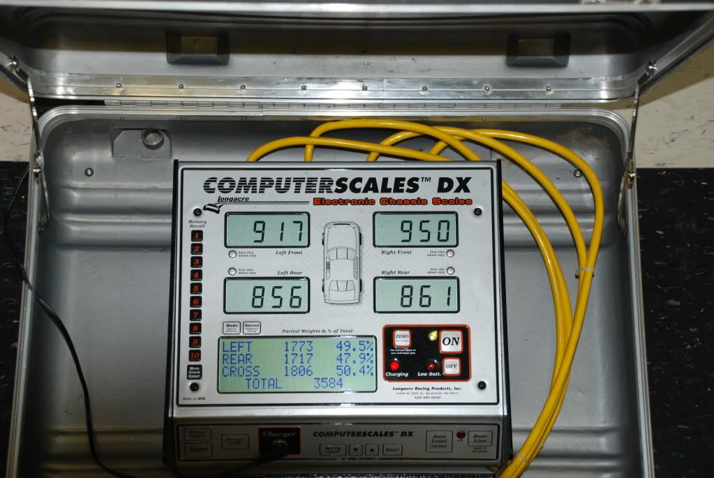

After 8 adjustments I think she's dialed. I ended up with .5 turn down LF, 1 turn up RF, and a whopping 6.75 turns up in the LR!
With me in the car I achieved 51.6/48.4 balance and a 49.9% cross weight. And I thought it was close before I started. :lol:
http://i200.photobucket.com/albums/a...ustment003.jpg
Me in the car:
http://i200.photobucket.com/albums/a...ustment009.jpg
