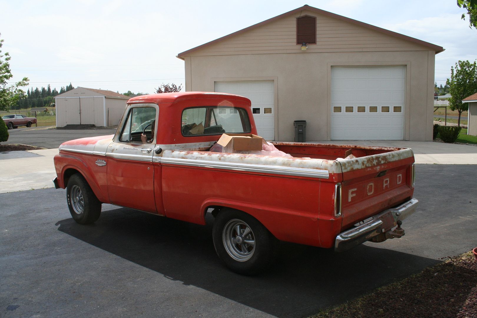

This started out a a very very nice unmolested Arizona Short Bed Custom cab in a very rare Orange/White 2-tone.
http://img.photobucket.com/albums/v5...psa7b1ed14.jpg
http://img.photobucket.com/albums/v5...ps4db782a1.jpg
http://img.photobucket.com/albums/v5...ps655feef6.jpg
http://img.photobucket.com/albums/v5...psc9f4333c.jpg

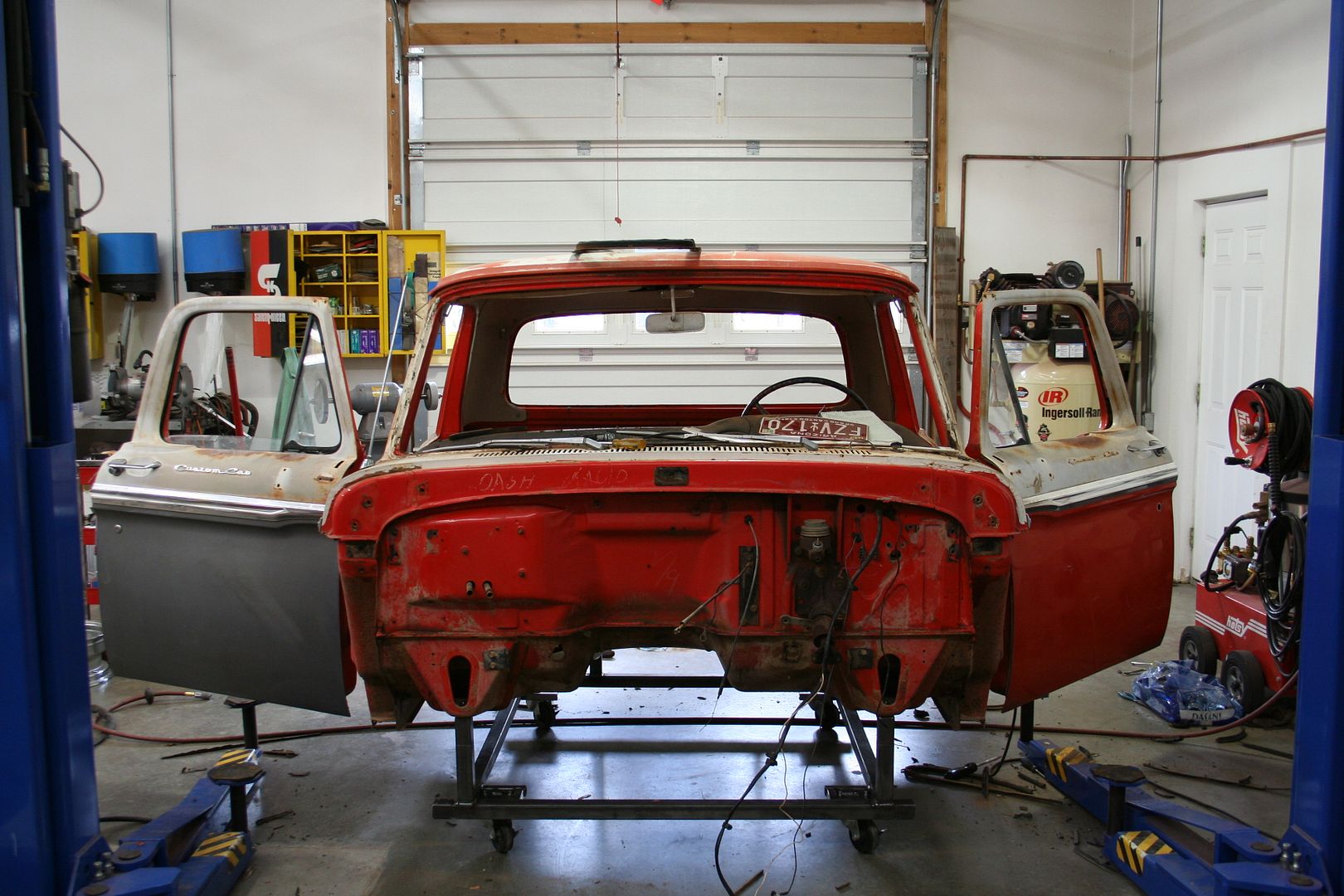

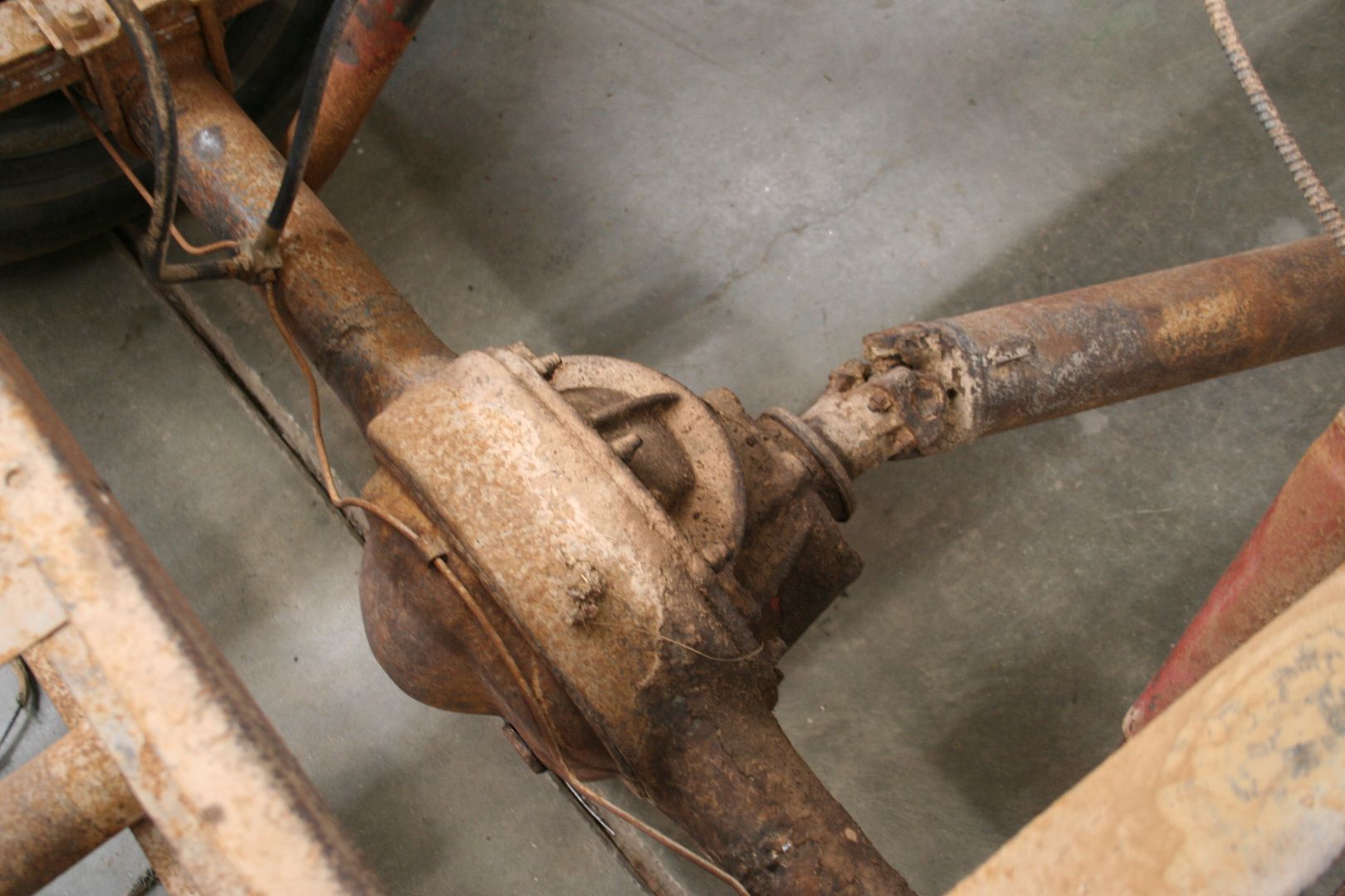

Stripping of Paint and teardown
http://img.photobucket.com/albums/v5...psbf68762e.jpg
http://img.photobucket.com/albums/v5...ps6bb3c507.jpg
TimeWarpF100 10-09-2010 06:16 PM

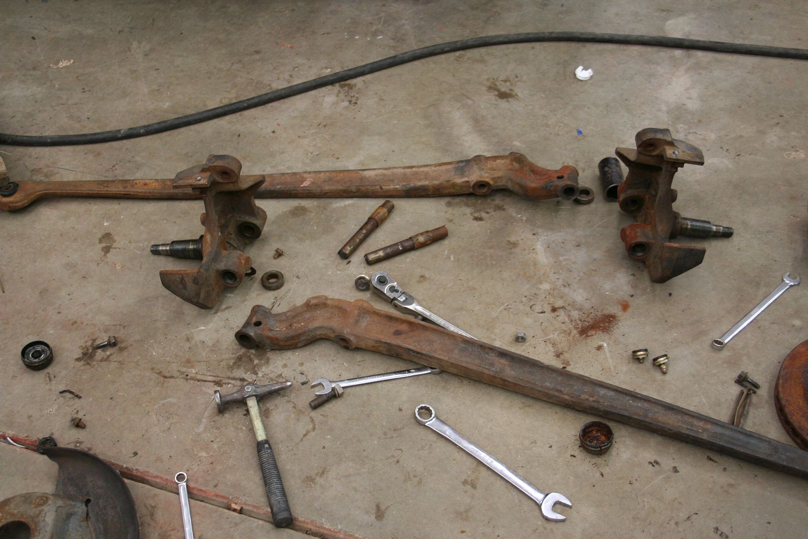

More teardown
http://img.photobucket.com/albums/v5...ps85a5bf2b.jpg
http://img.photobucket.com/albums/v5...psf4456ec6.jpg
http://img.photobucket.com/albums/v5...ps5e4947cf.jpg
http://img.photobucket.com/albums/v5...ps4ed92b05.jpg

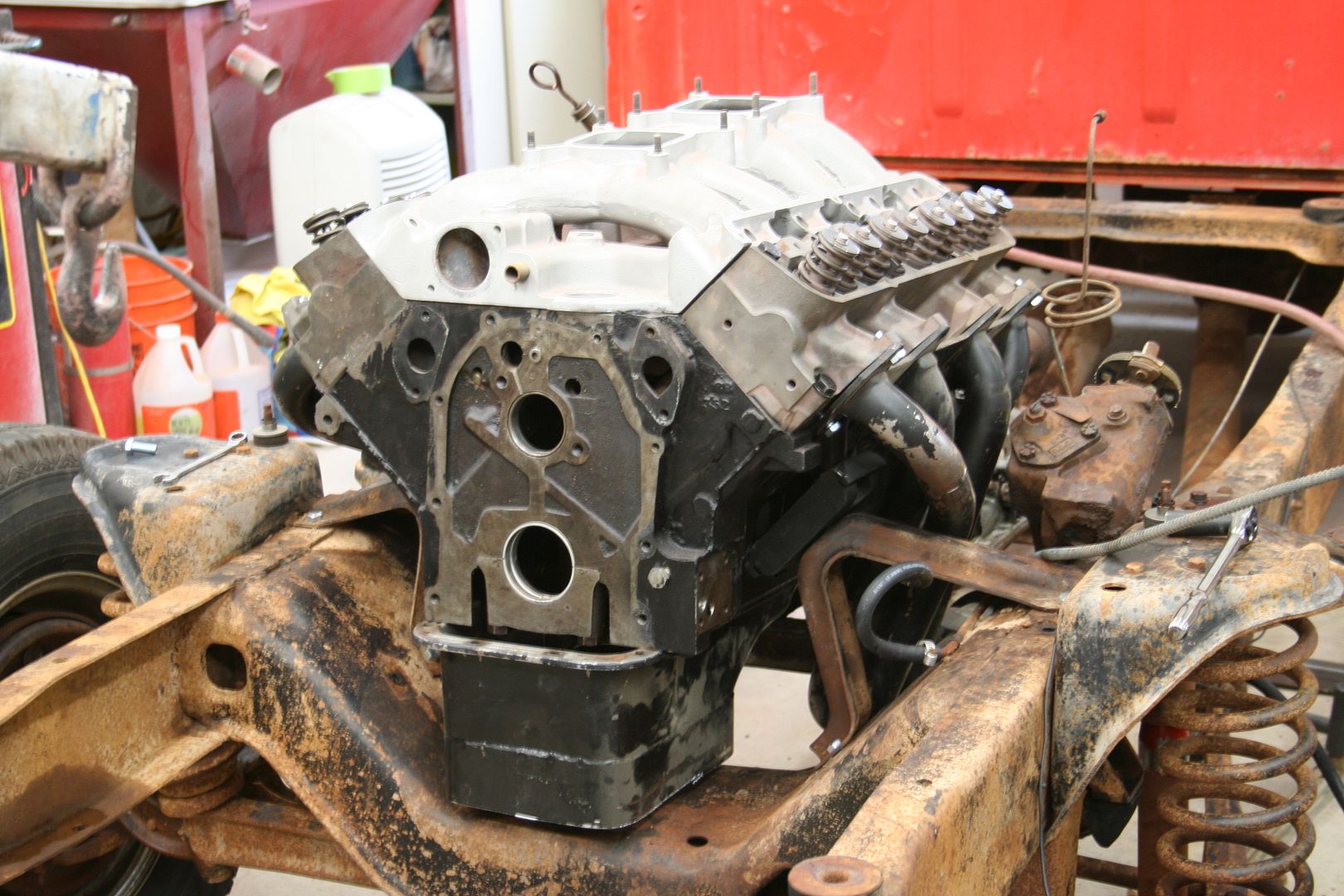

A trial fit of engine and trans prior to blasting and powdercoating of frame.
http://img.photobucket.com/albums/v5...psc50ecd08.jpg
http://img.photobucket.com/albums/v5...ps702d0ed9.jpg
http://img.photobucket.com/albums/v5...ps24d43554.jpg
http://img.photobucket.com/albums/v5...psed369210.jpg
http://img.photobucket.com/albums/v5...ps20308406.jpg

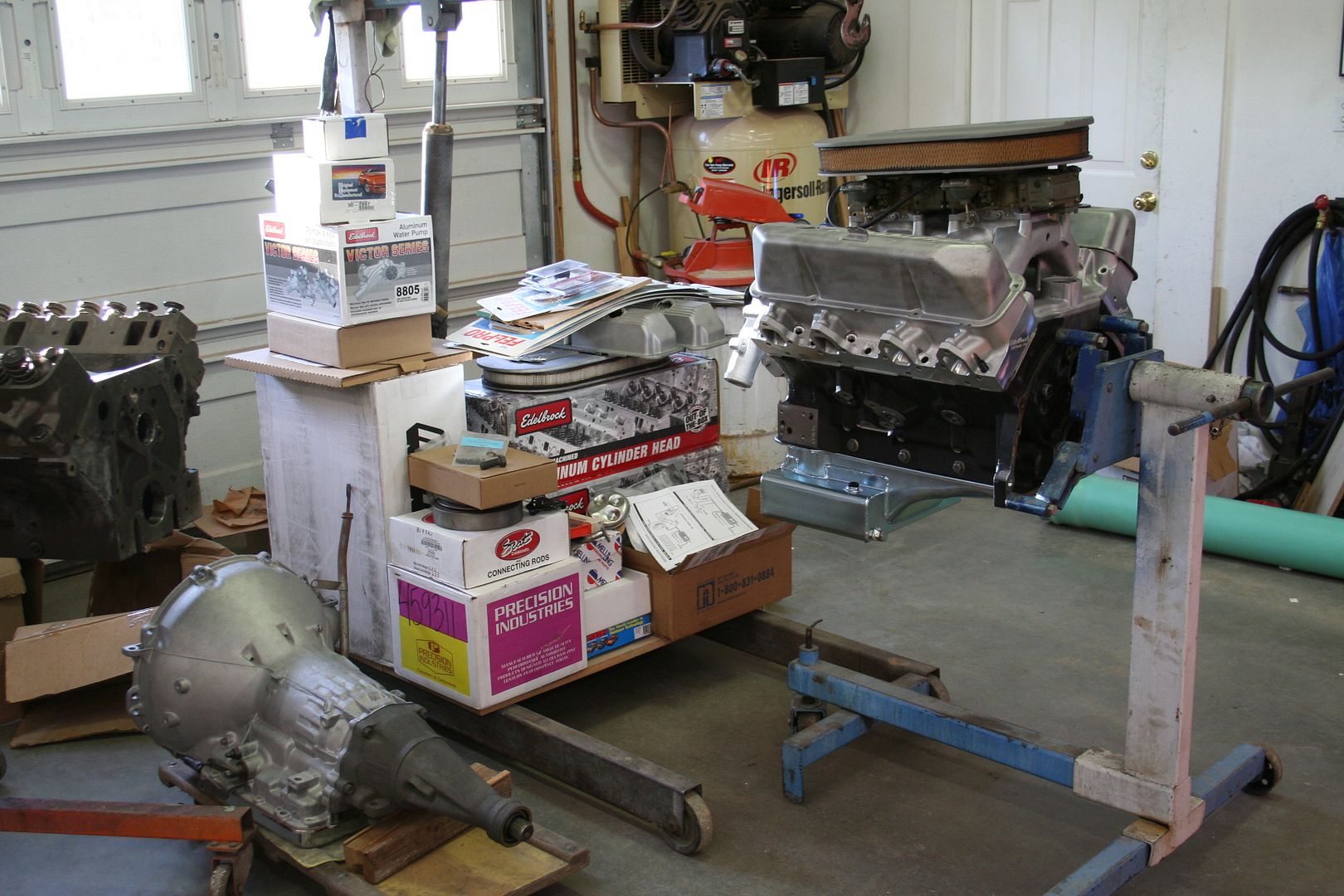

TimeWarpF100 10-09-2010 06:27 PM
a few key engine components started to show up and a bit of test fitting was done.
http://img.photobucket.com/albums/v5...ps83f1c2f5.jpg
http://img.photobucket.com/albums/v5...pse68643ca.jpg
http://img.photobucket.com/albums/v5...ps40d3497a.jpg
http://img.photobucket.com/albums/v5...ps78beffc7.jpg
http://img.photobucket.com/albums/v5...ps2f06e54d.jpg

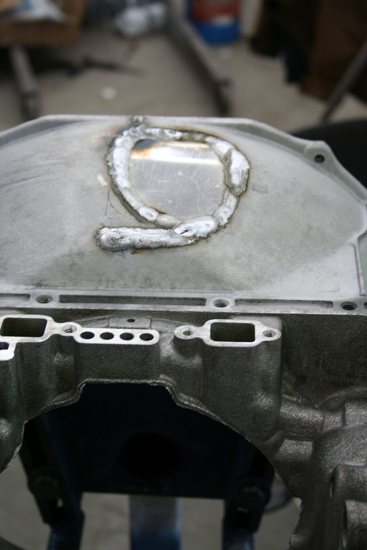

Took a Cobra Jet C-6 out of the cobwebs and started a rebuild. Had an "ISSUE" with the trans case because someone put a bottle jack under it to "LIFT" the car. A quick weld job and back at it.
http://img.photobucket.com/albums/v5...psc3986996.jpg
http://img.photobucket.com/albums/v5...ps59b0defb.jpg
http://img.photobucket.com/albums/v5...ps370fe292.jpg
http://img.photobucket.com/albums/v5...ps7e579b22.jpg
http://img.photobucket.com/albums/v5...ps3676ccb2.jpg
http://img.photobucket.com/albums/v5...psb679ad56.jpg

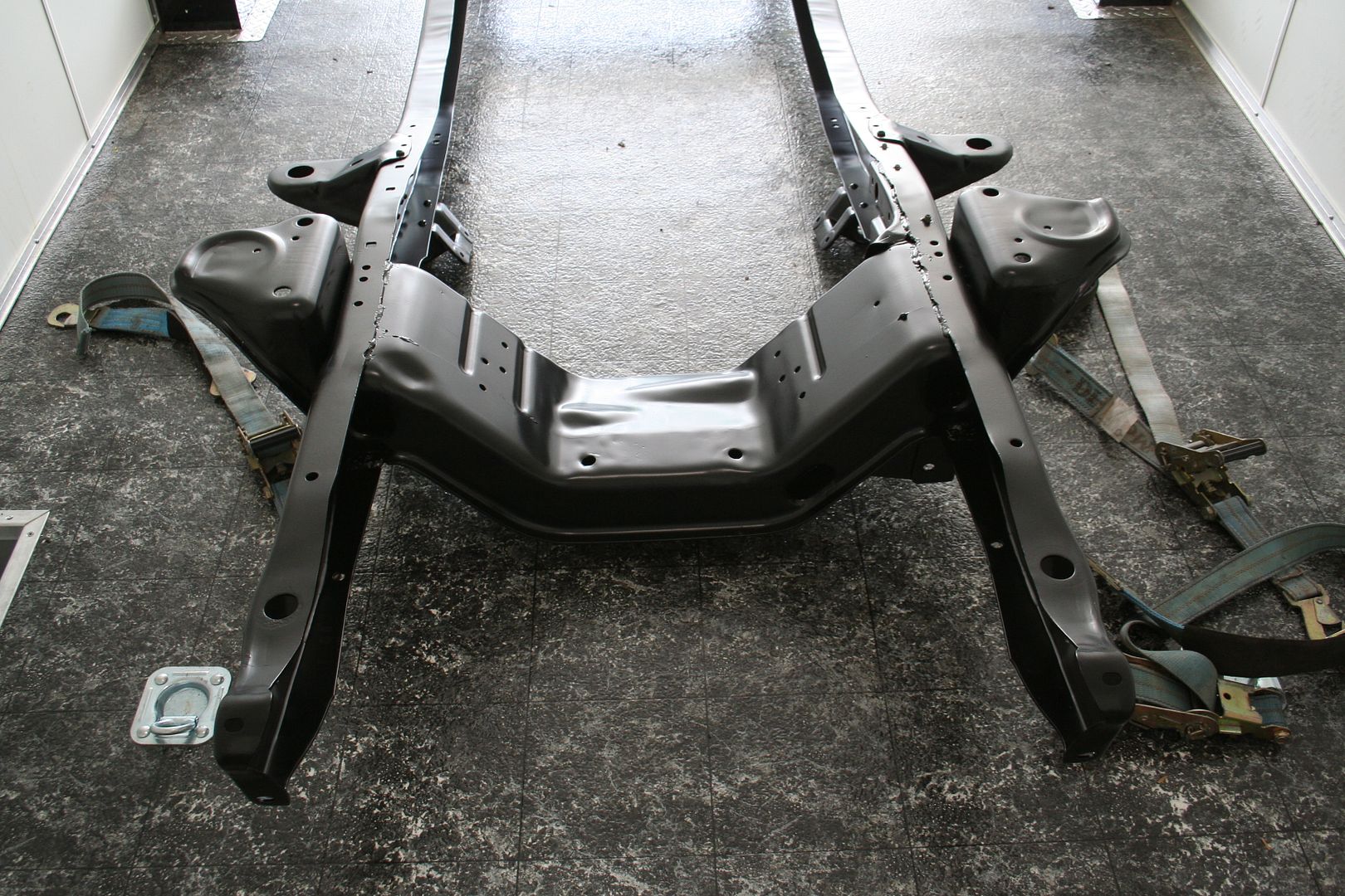

I then dragged the frame outside for a quick sandblast before bringing to the powdercoater along with other misc parts.
http://img.photobucket.com/albums/v5...ps829412bb.jpg
http://img.photobucket.com/albums/v5...psfae9d131.jpg
http://img.photobucket.com/albums/v5...ps40973836.jpg
A few days later they called to say it was ready! They did a VERY NICE job on the parts. And at a price I could not begin to buy paint and materials for.
http://img.photobucket.com/albums/v5...psea3d58c1.jpg
http://img.photobucket.com/albums/v5...ps4078e202.jpg
http://img.photobucket.com/albums/v5...ps83c4b02c.jpg
