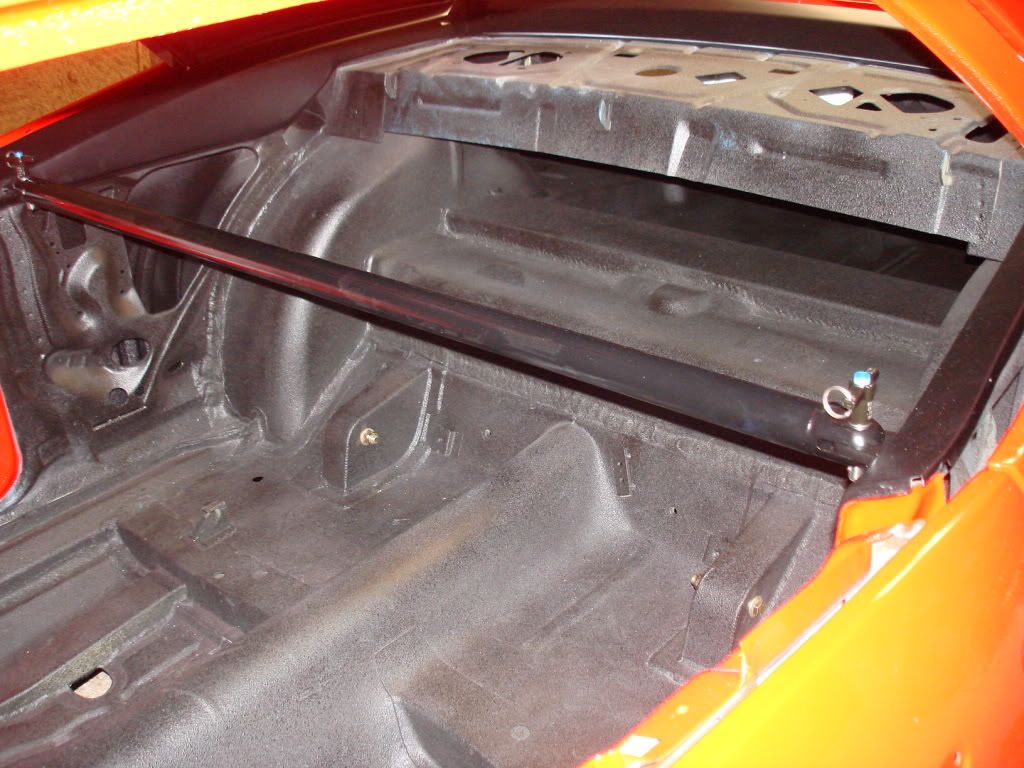

Ned,
We integrated one in to my chassis/body on my 69 camaro. I drew up some rough pics and sent it over to Mike Riggs he ran with it while preparing my sheet metal body . He had so many pics up on his website but took them all down. Im looking at this one pic of the car with no rear quarter on it and said to myself, how cool would it be to add a solid 1 inch bar from the b pillar to the end of the quarter where the striker is bolted in all reinforces with 1/8" plate and a 1/4" tab welded to the bar to protrude out a slot in the top beauty reveal. A couple of cletes in the trunk and the bar has storage as well. Its not for everyone but my logic is, Im not going through the windshield in the event of a front end collision and dont want a 3 point harness. Should hold you in the seat firmly during vigorous driving excursions. I wish I had the pics when Mike had the quarter open, here's one that gives you an idea. If you look closely at the right corner of the pic you can see the bar going to the b pillar, clears all the quarter window hardware nicely.
http://i168.photobucket.com/albums/u...cture193-1.jpg
Rich

obviously some reinforcement is needed where the mount is welded, but do you guys think we (the ones with quarters on) could do without the extra reinforcing bars that we've seen. my thought would be yes since the stock belts mount through sheet metal and the piece we are talking about isnt a flimsy piece and it is welded to tons of stuff around its perimeter.
thoughts?

That's simiar to what they did on the Kyle bush car. I'm leaning towards doing that.... I looked at that area yesterday and it looks like it wouldn't be too hard to reinforce that area even with the quarter panel on. In my car there's quite a bit of space in there and the access to get in there isn't too bad
I've been thinking about how much force it would need to support and if you look at the way the stock upper belt attaches to the c pillar area, it ain't too beefy up there :) and neither is the floor for that matter
When it comes to safety it's always better to over engineer something but in my mind alot of extra bars etc wouldn't really be necessary. A big flat plat the distributes all that force over a large area and the way the b pillar and inner structure all connects it's pretty stout to begin with
I think something pretty stout could be done with the quarters on. With the DSE car the took the top part of the b pillar off to get better access but did it with the quarter on
