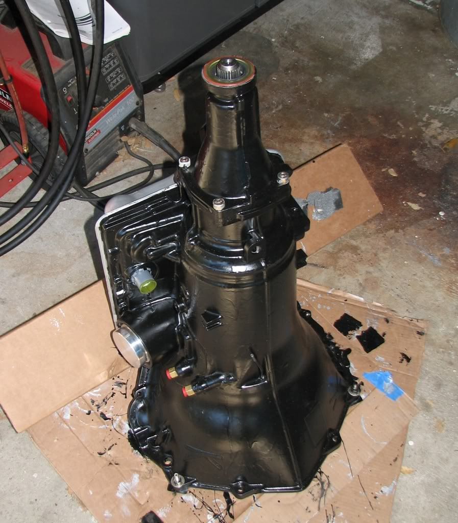

Por-15 + Chassis black on brand new trans case:
http://i328.photobucket.com/albums/l...ssion016sm.jpg

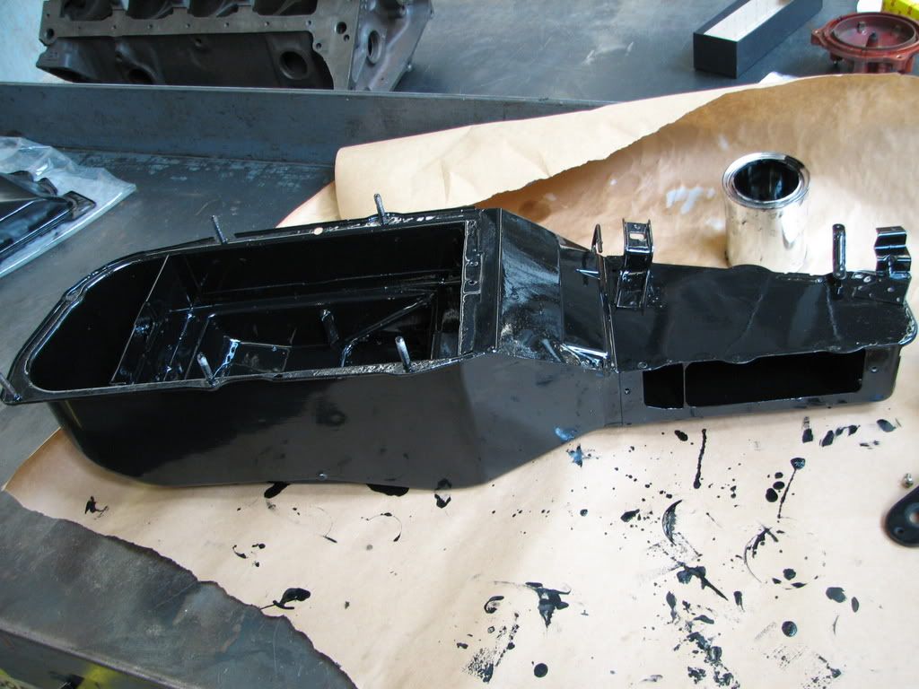

Por-15 + Chassis black on heater box:
http://i328.photobucket.com/albums/l...ension015e.jpg http://i328.photobucket.com/albums/l...ension015f.jpg

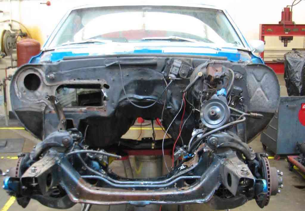

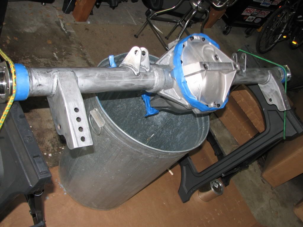

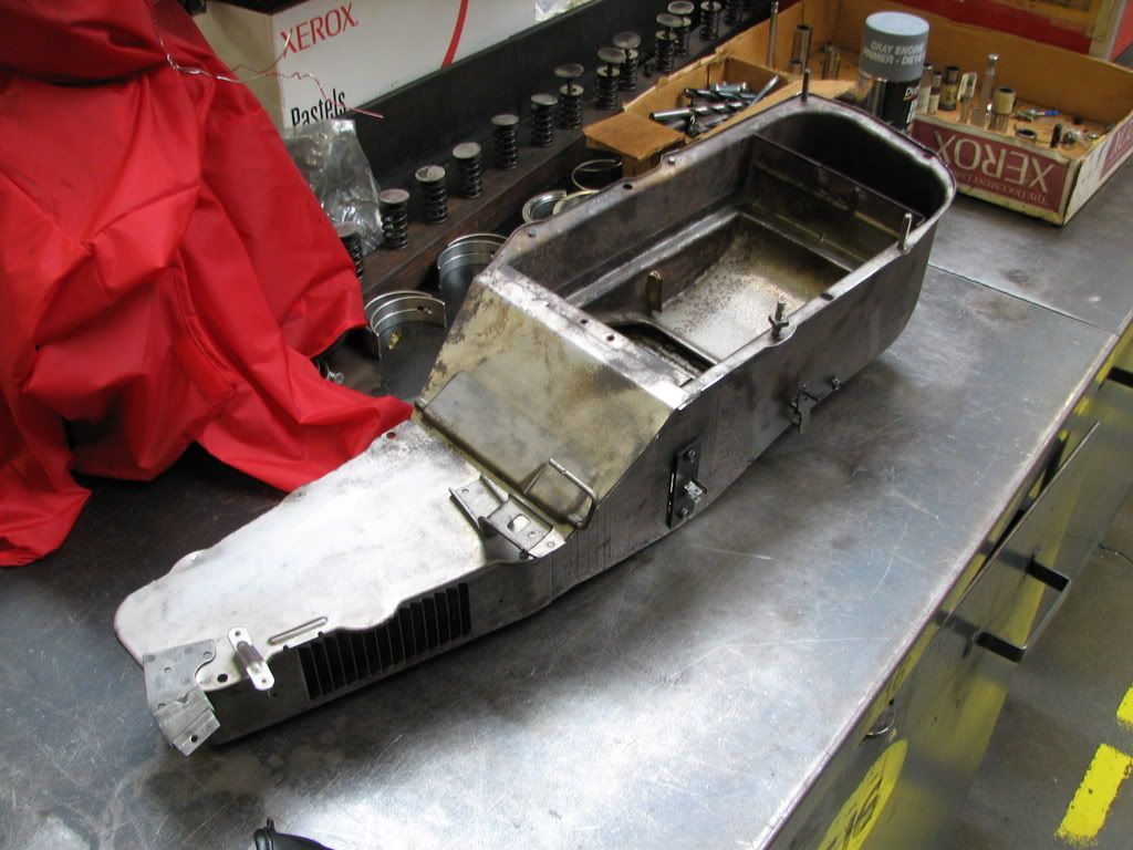

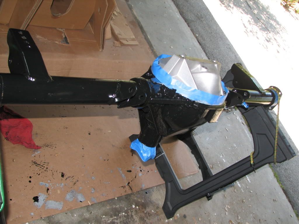

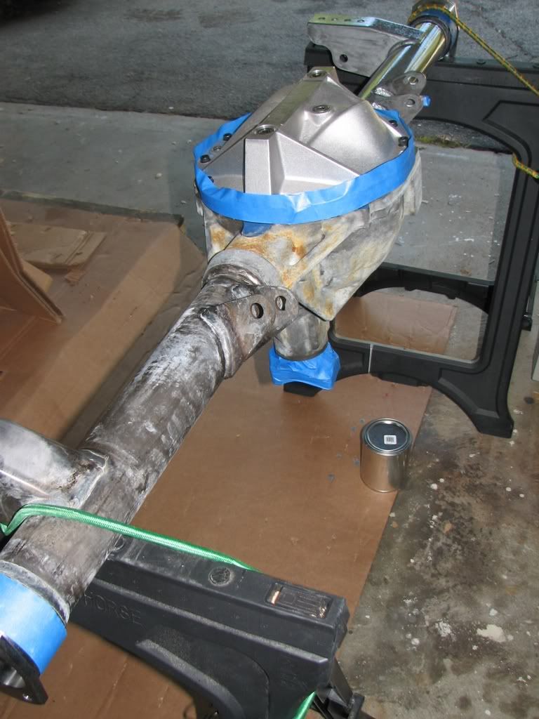

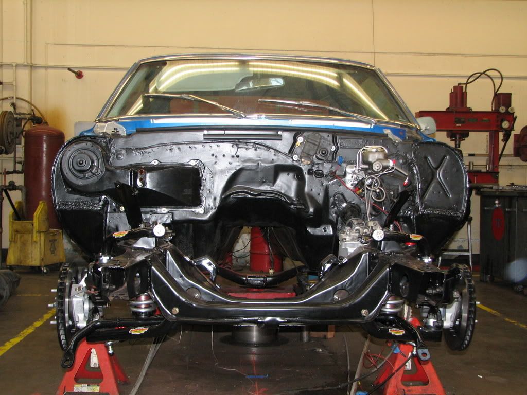

Its only junk if you don't do the prep right. And yes the prep is killer but like all things you get out of it what you put into it. I can hammer, and wipe down with Lacquer thinner any of those surfaces, try that with anything else short of powder coat.
I am planning on doing my floors too and I'll use the same 10c foam brushes from OSH to do so with Por-15 + Chassis black.
As far as the prep goes, get as much as possible off down to bare metal if you can. Get the metal as clean as you can, use Marine Clean then Metal ready, then apply Por-15. I can't stress "as clean as possible" enough. Repeat cleaning steps at least 2-3 times to make sure you have a clean surface. Even the slightest oil and Por-15 won't stick / bond.
