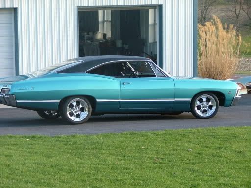

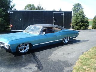

here is how it sat before i started all this, lowered a little, 17 inch americans and the 400/700r4.
http://i24.photobucket.com/albums/c2...even/005-9.jpg

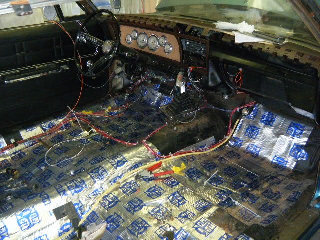

i had wiring issues with the car for a long time and finally got fed up with it. i didnt know id tear it down as far as i did but you all know how it goes. ill point out that im not doing a frame off on the car because it is spotless underneath, just pressure washed the oil and sludge off the underside, reundercoated it and thats all.
when i decided to rewire the car i pulled the interior out. most of it fell to pieces so new interior was in the works....

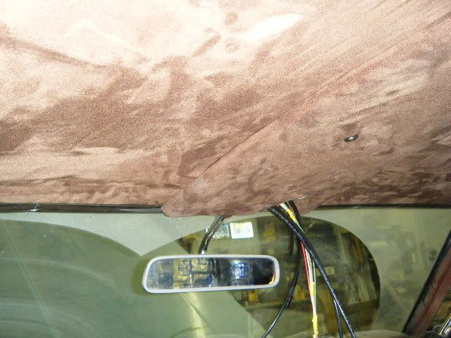

molded headliner i did myself, missing the trim.

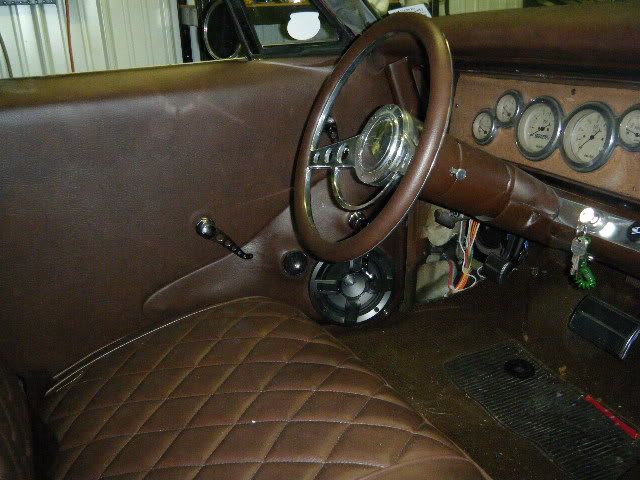

http://i24.photobucket.com/albums/c2...ven/001-29.jpg
speaker pods and door panels i did myself, still workin a console and armrests for it.

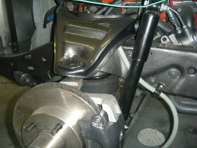

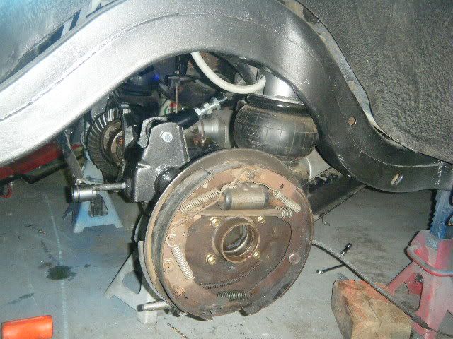

at cruisin oc 2010 i got a killer deal on billet specialties, and had to make em fit so on when the ridetech brackets and airlift airbags also did a front disc conversion kit on it and hydroboost i stole off a junkyard pickup.
http://i24.photobucket.com/albums/c2...ven/003-24.jpg
http://i24.photobucket.com/albums/c2...ven/006-18.jpg
http://i24.photobucket.com/albums/c2...even/022-2.jpg
http://i24.photobucket.com/albums/c2...even/021-6.jpg
i apologize for the long post, but that about catches you up to where im at now.

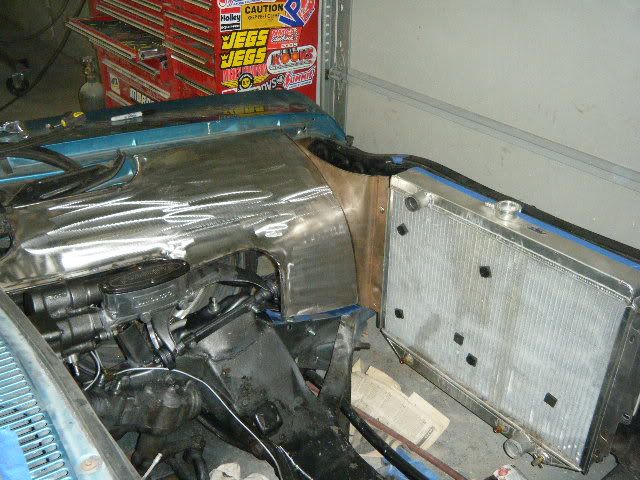

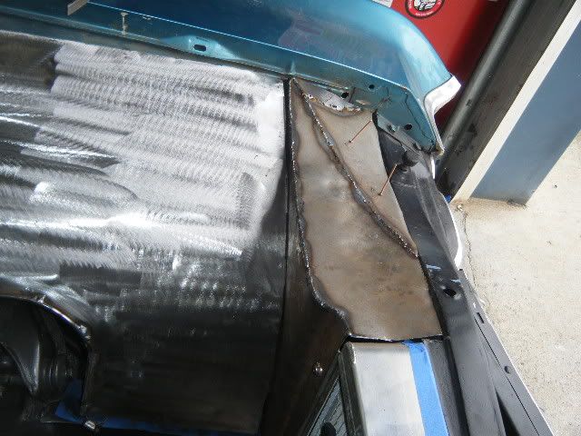

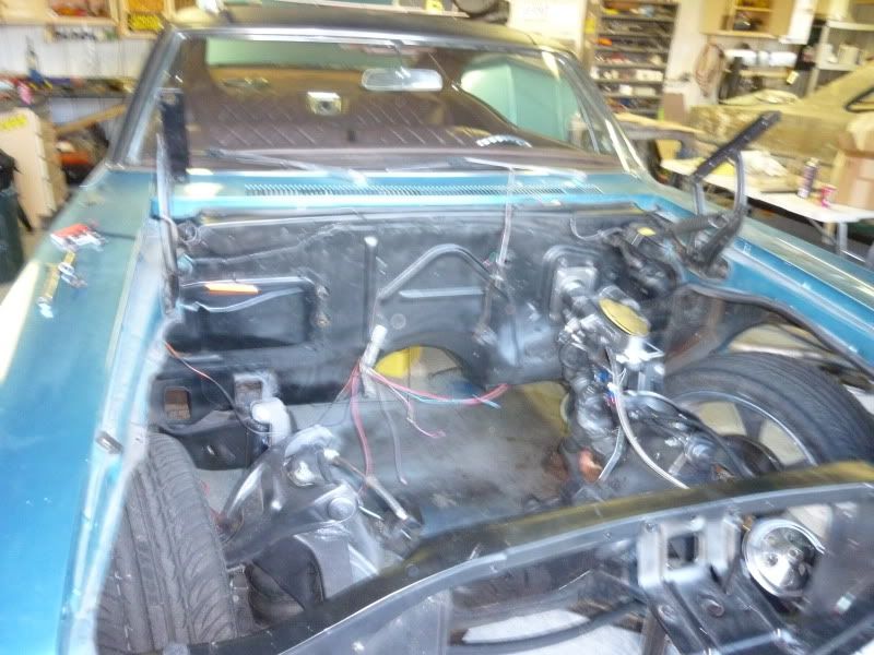

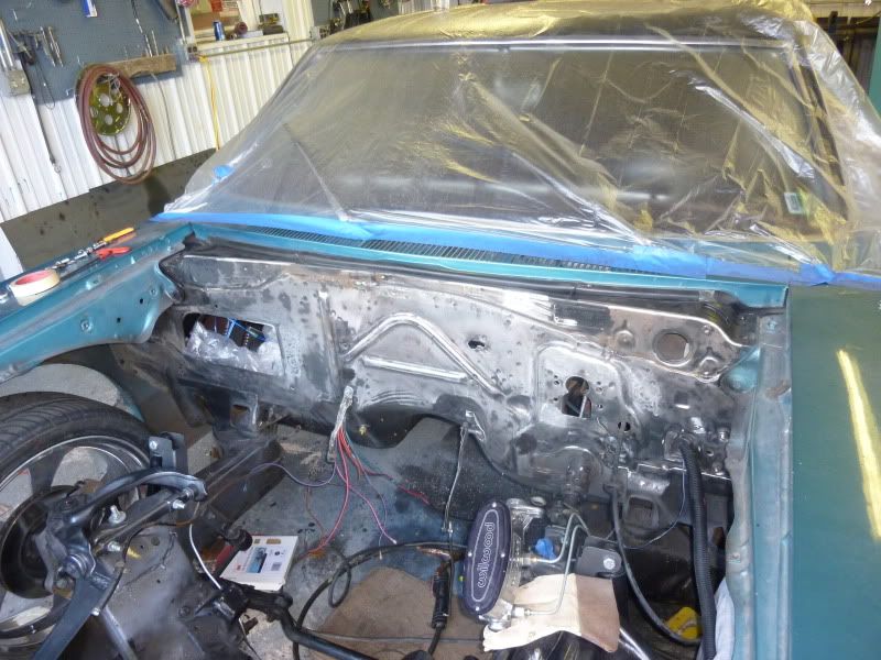

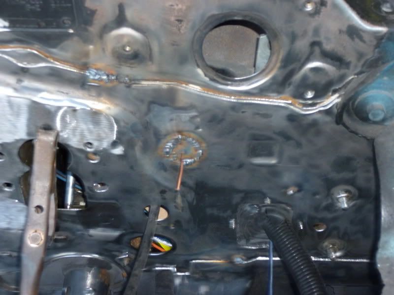

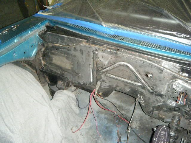

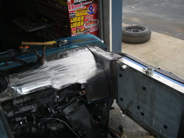

started cleaning up the engine bay:
http://i24.photobucket.com/albums/c2...ven/002-23.jpg
http://i24.photobucket.com/albums/c2...ven/001-28.jpg
http://i24.photobucket.com/albums/c2...ven/007-17.jpg
http://i24.photobucket.com/albums/c2...ven/005-17.jpg
http://i24.photobucket.com/albums/c2...ven/011-11.jpg
http://i24.photobucket.com/albums/c2...ven/005-19.jpg
http://i24.photobucket.com/albums/c2...ven/010-10.jpg
http://i24.photobucket.com/albums/c2...ven/011-12.jpg
should start and finish the passenger side inners up this week.
let me know what you think, im open to suggestions.

i appreciate all the kind words. once i get some more sheetmetal ill get the passenger side of the engine compartment finished.

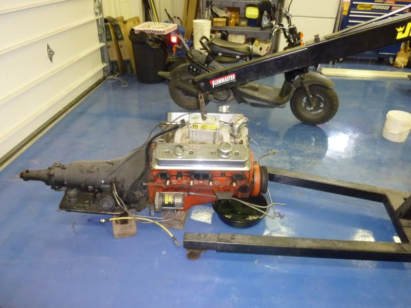

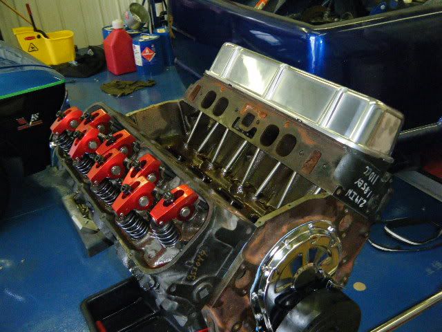

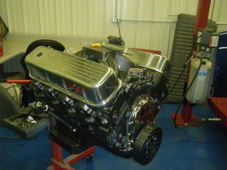

this is the big block i have built for it. first engine i built entirely myself, no help from dad on this one.
http://i24.photobucket.com/albums/c2...ven/012-10.jpg
http://i24.photobucket.com/albums/c2...ven/008-15.jpg
its a 468, oval port gm heads with some porting, victor jr, 252 @.050 comp hydraulic cam, 10:1 pistons, pretty mild build. bought most of it from swap meets and leftover parts from other builds. one day im hoping to put some hilborn efi on it, but thats way out of my 22 year old getting married next year broke ass budget.
