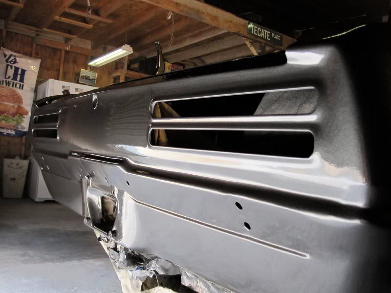

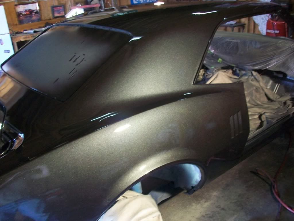

My buddy did that on his 68 Firebird.....
http://i270.photobucket.com/albums/j...Picture006.jpg
http://i270.photobucket.com/albums/j.../19june097.jpg
http://i270.photobucket.com/albums/j.../19june095.jpg
http://i270.photobucket.com/albums/j...d/IMG_0082.jpg

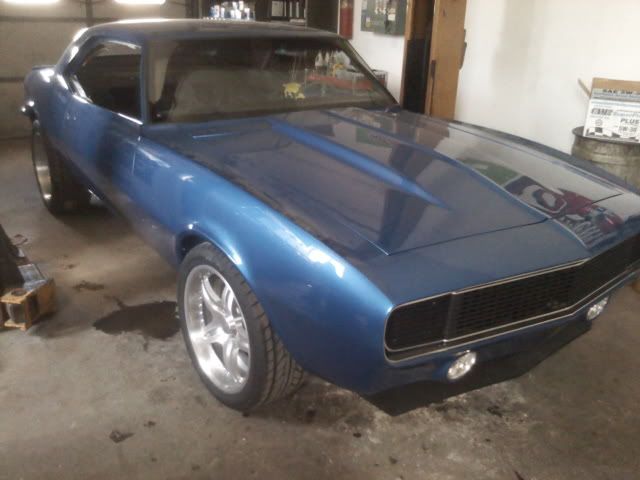

i have a 68 camaro and have the front upper and lower fenders made into one i also have the front upper header panel and lower valance welded to fenders.i love the uniform look.ill try to add pictures
