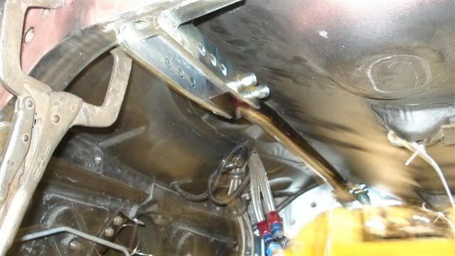

In the meantime I sent Frank and a few other suppliers like Speedtech about a million emails about rear suspensions and rear end options. I really liked the Speedtech Torque Arm and DSE Quadra link, but when Frank told me that the Alston G-Link could be installed under a stock trunk floor that kind of sold it for me. The other main things were packaging. I could re-use my stock width Ricks tank, could get my rear exit tail pipes to work (the G-link seems to have the best taipipe clearance which was very important for me) and I would re-use my current sway bar and subframe connectors.
Now if the car were in the shell, builder stage I would have probably went with DSE but my car is currently complete, driving etc. I wanted a kit with the least invasive install and best exhaust clearance. And I liked the fact that the triangulated 4-link design is good for road course and drag racing applications vs the other styles.
http://i34.photobucket.com/albums/d1...suspension.jpg
http://i34.photobucket.com/albums/d1...01-main-pp.jpg
I also went with the Moser 12-bolt 33 spline axles, Tru-Trak posi with 3.73's. I have not recieved this yet, just waiting to send Frank the measurements. I considered the wave-trac with 35 spline but Franks says it's overkill.

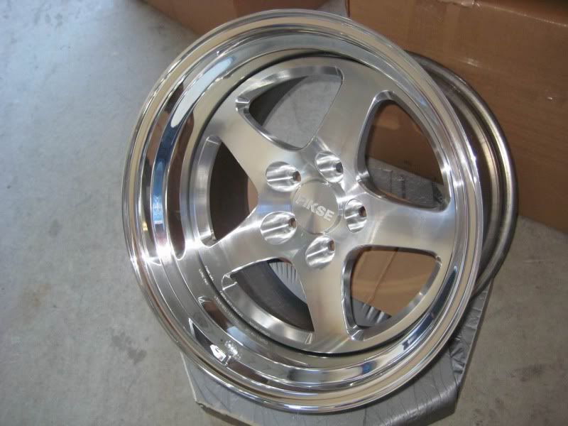

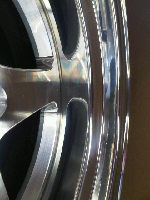

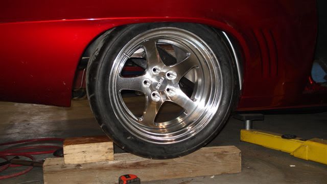

These are pics of the wheels when I first got them. I originally ordered 6.375" BS on the rears. And when I got them I just wasn't happy, I wanted a deeper lip. So I contacted the Rep Danny Gol and we made a deal to re-hoop the rears to 5.375" BS. This took a few months as well. Fikse is a little slow, but they were very good to deal with and they are local to me now under new ownership.
Anyways, onto some pics.
18 x 12 6.375" BS
http://i34.photobucket.com/albums/d1...ub/18x12-1.jpg
http://i34.photobucket.com/albums/d1.../18x12lip2.jpg
http://i34.photobucket.com/albums/d1...b/18x12lip.jpg
18 x 8.5's
http://i34.photobucket.com/albums/d1...-Tub/18x85.jpg

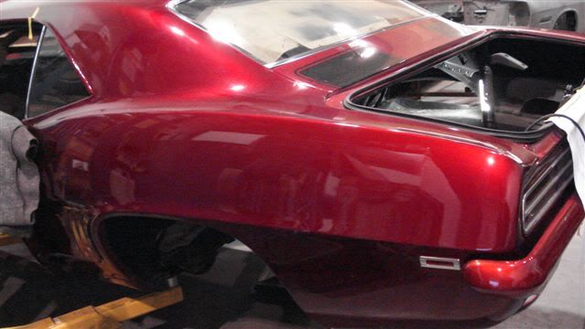

Rybar 11-24-2010 01:28 PM

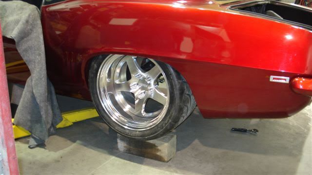

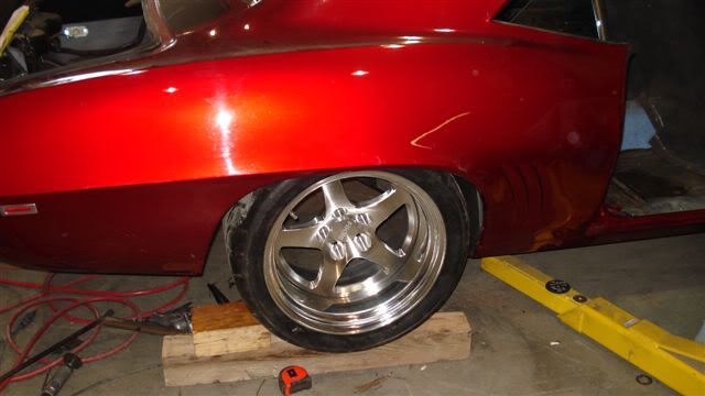

So after I had the wheels Re-hooped to 5.375" BS they now look like this: :wow: :cheers:
http://i34.photobucket.com/albums/d1...0-27122059.jpg
http://i34.photobucket.com/albums/d1...01028-1030.jpg
http://i34.photobucket.com/albums/d1...01028-1031.jpg

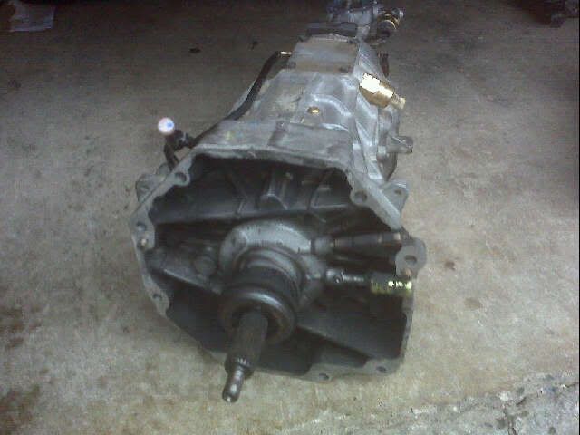

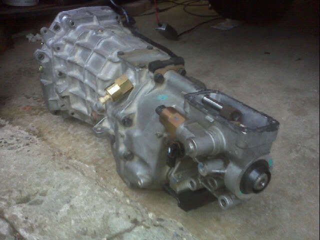

Some pics of the Tranny and clutch, sorry crappy phone pics:
Tranny pulled:
http://i34.photobucket.com/albums/d1...b/IMG00207.jpg
http://i34.photobucket.com/albums/d1...b/IMG00208.jpg
http://i34.photobucket.com/albums/d1...b/IMG00209.jpg

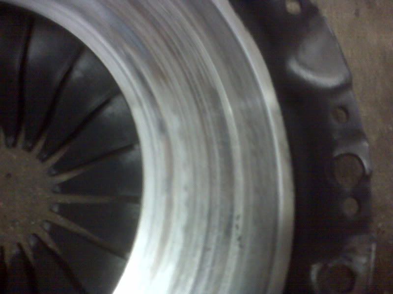

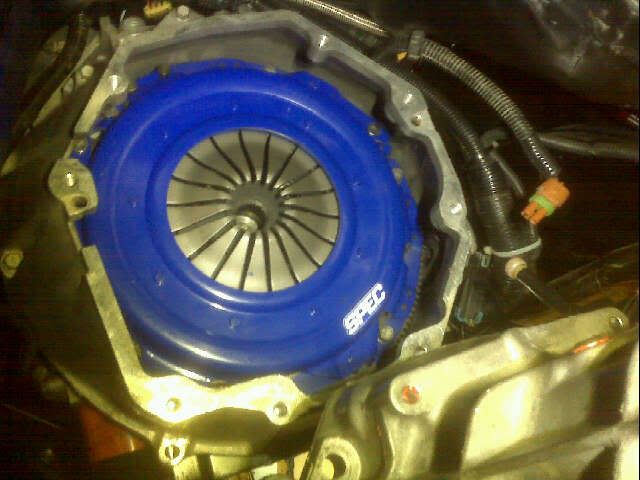

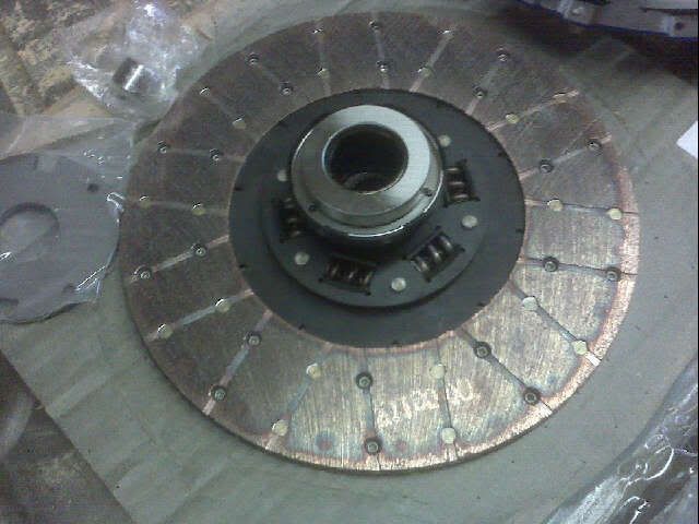

Old Spec Stage 3:
http://i34.photobucket.com/albums/d1...b/IMG00212.jpg
New Spec Stage 3+ cluch disc:
http://i34.photobucket.com/albums/d1...b/IMG00221.jpg

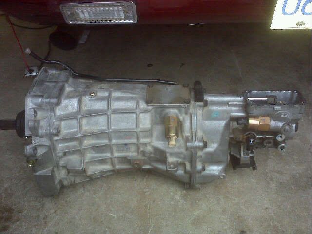

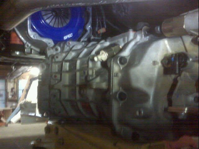

Stage II tranny rebuilt and going back in:
http://i34.photobucket.com/albums/d1...b/IMG00226.jpg
http://i34.photobucket.com/albums/d1...b/IMG00227.jpg
