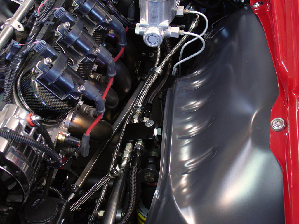

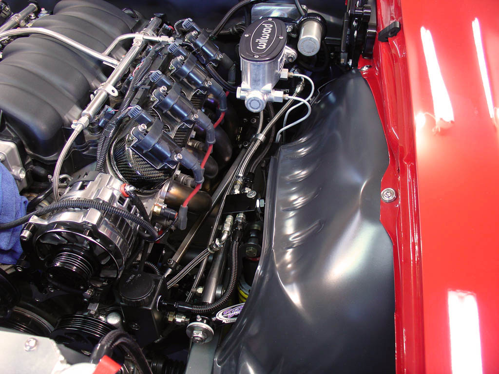

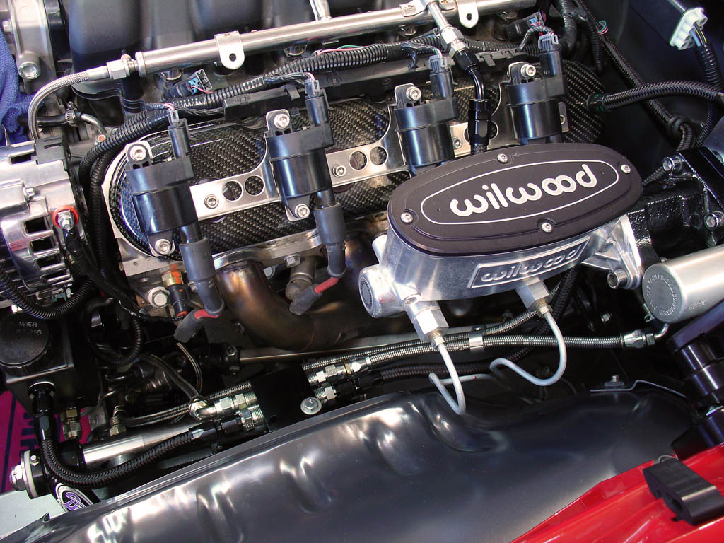

I love the idea of softening that initial "bite" of the boost unit.....AND a good byproduct of that softening of the brake unit will be a stiffening of the steering, which for my taste is just slightly touchy for me.
Scott, do you have any good pics of the plumbing of the Heidt's Adjustable Power Steering Valve (part# PS-101) <--- same one right?
thanks....
Hydratech® 01-01-2011 10:32 AM
Here are a few shots Scott passed along when he was first setting up the Heidt's PS101 valve in early '09 - his engine compartment has come a long way since!
http://www.hydratechbraking.com/images/PS_adj_01.jpg
http://www.hydratechbraking.com/images/PS_adj_02.jpg
http://www.hydratechbraking.com/images/PS_adj_03.jpg
This was an initial installation that he has since reworked for better overall layout and appearance.
protour73 01-01-2011 06:48 PM
WOW, thanks Paul, that's perfect!!! ..... and thanks Scott!! :unibrow:
