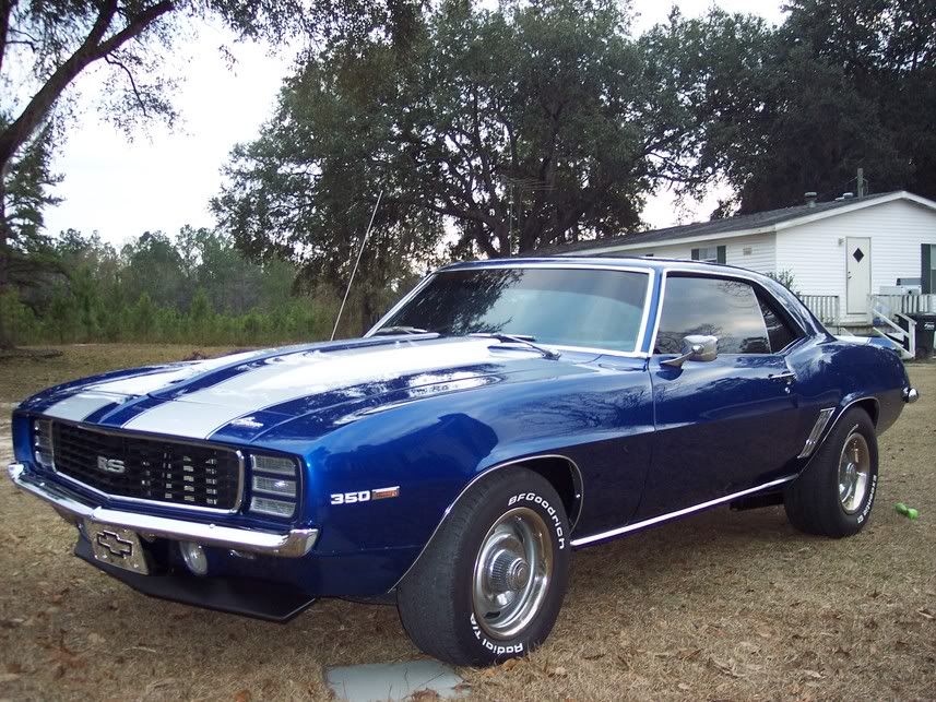

He didnt ask me about the brakes, that kind of makes me wonder. I've been searching for about 1.5 yrs trying to decide which rims I want and I really have my mind set on these but if there are too many negative things that i've got to consider, I'll just get something else rather than going through the hassle of ordering and waiting then not fitting, that takes alot of time and I'm ready for rims now. Here is a pic of my car. http://i18.photobucket.com/albums/b1...l/100_0935.jpg
Autokraft 01-11-2006 06:09 AM
Nice car. :hail:
Kurt
