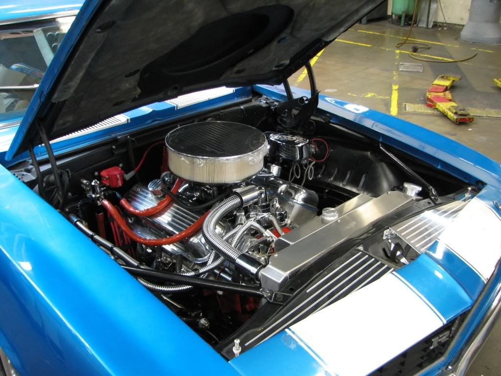

BBC69Camaro 12-22-2010 10:07 PM
This is where I mounted my regulator up front, external pump electric pump thou, dual 1/2 inch lines to pump, 5/8 lines from pump to tank:
http://i328.photobucket.com/albums/l...Install098.jpg
